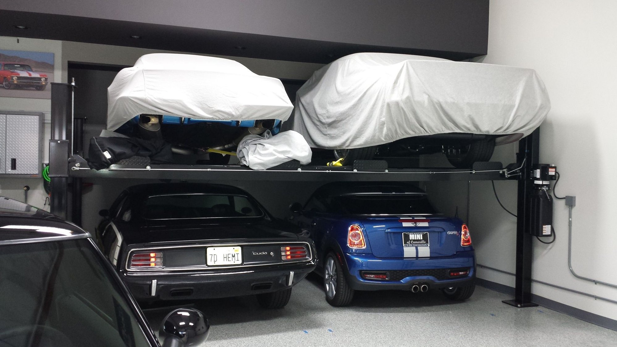

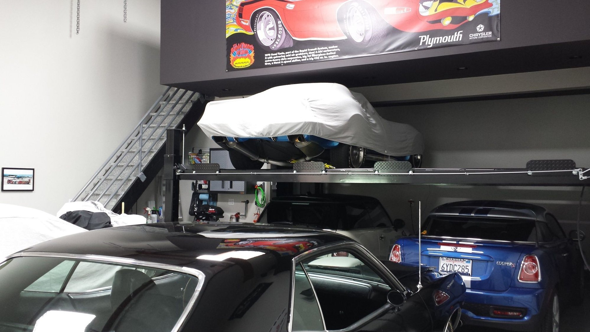

Hi JT, this is just my 2 cents. I did a ton of research before buying my lift and the one I bought (unfortunately the company is no longer around) was a column over column type lift. This is the safest and most secure. There are a bunch of what is referred to as a C channel lift where the lift rides inside a channel that is held in place by the tension of a bolt. Over time that channel can stretch and the lift can fail. I am not a fan of Bendpaks lifts even though they are headquartered not that far from me. I have several friends with their lifts and they require compressed air to run the lock mechanism and if you don't have really good air moisture control the locks can get stuck. As far a movability I can't speak to that as the lift I have is dual car lift. All American steel and hydraulics and has served me well. I have looked at Wildfire lifts as they are the new iteration of Backyard Buddy. That is the type of design I recommend. Good Luck.
Gary

Default Pics of column over column
Fully loaded
Fully loaded

I forgot to mention the jack bridges that are easily used for lifting for suspension/wheel removal. They may be a bit more then others but I would rather pay more for something that I know will hold up when I am under it or have a vehicle under it. For me, I use a ratchet tie down strap at opposite corners of the stored vehicle since I went through the 1994 earthquake and had a car bounce off the garage wall at my other house and leave 2x4 dents in the side of it.

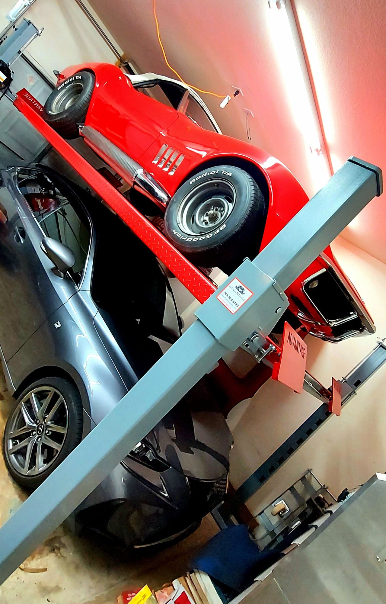

I went with the Champion XLT. The package included a caster system (very easy to use), sliding air jack for tires etc, steel tool tray.., lightweight aluminum ramps, delivery & install for about $7,200.
To 4 Post Lift

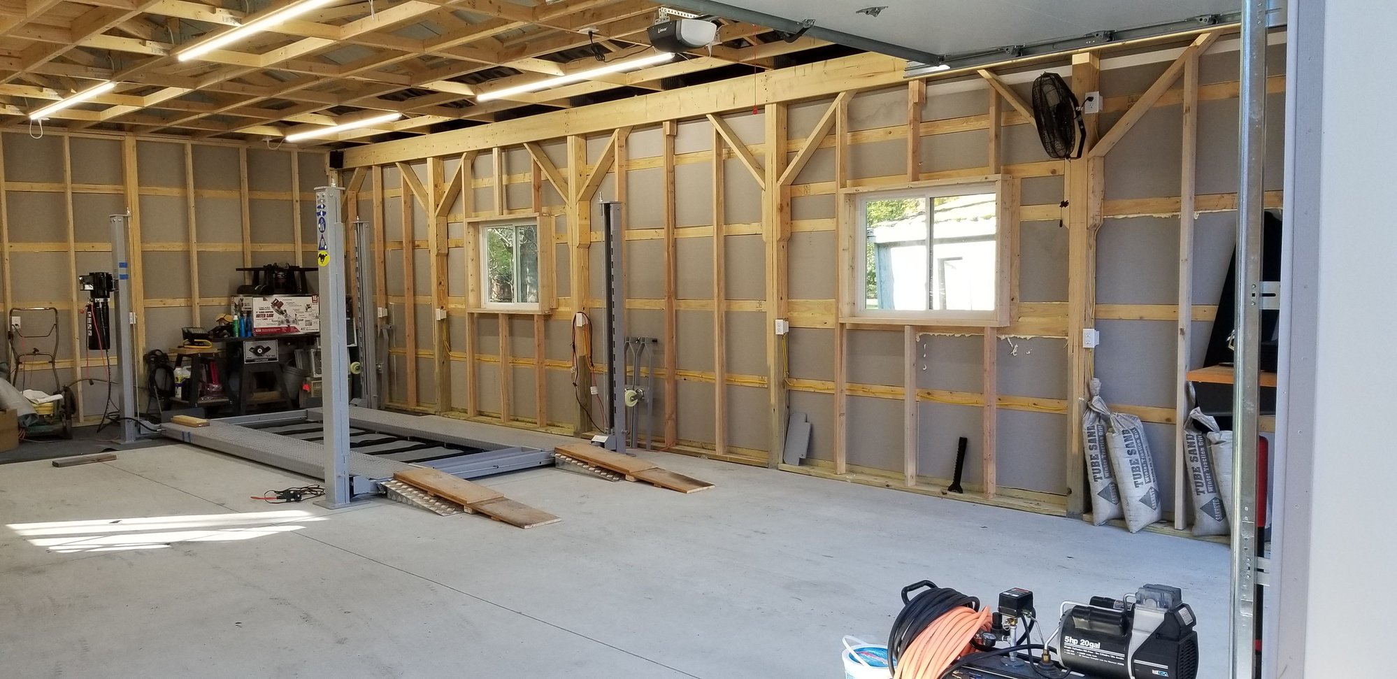

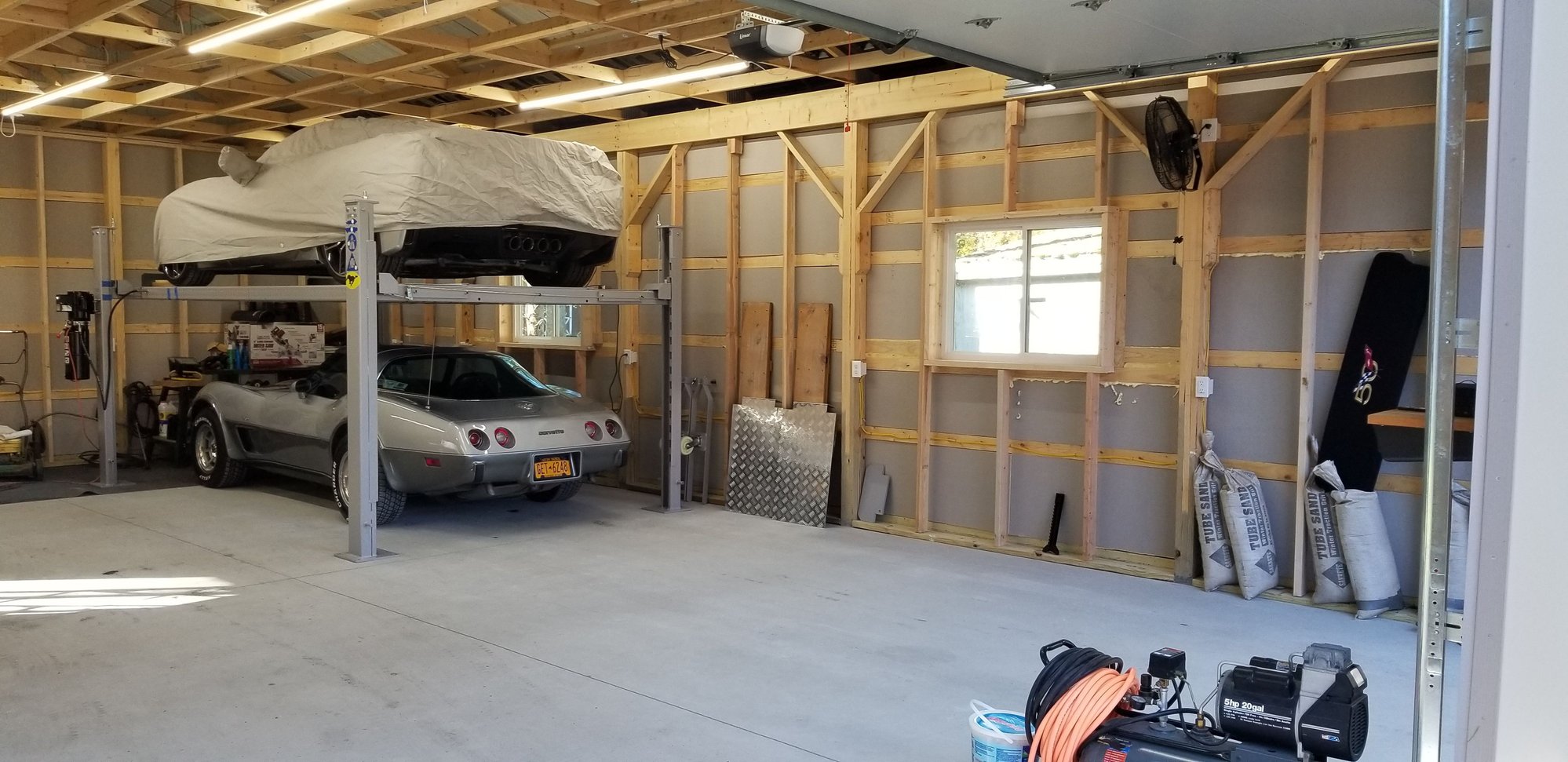

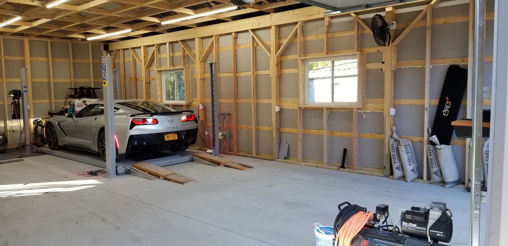

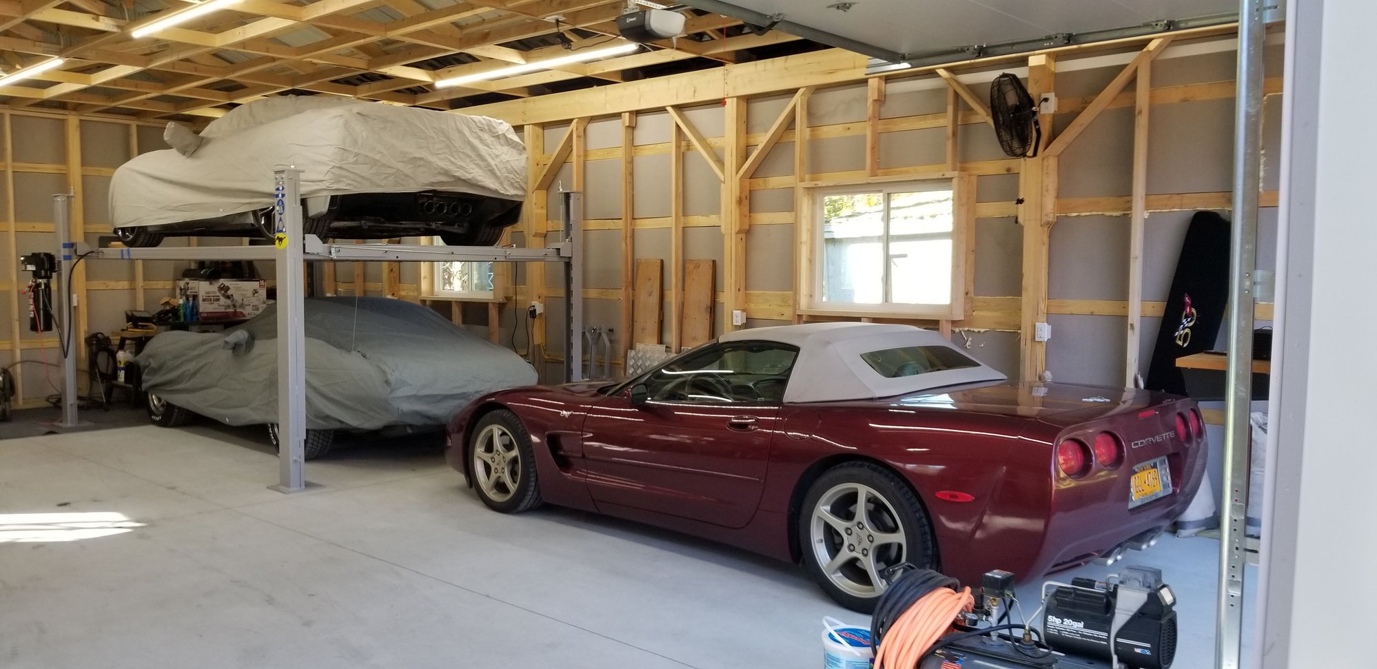

These are of my lift before I finished the Pole Barn. Barn has 10' ceiling. When the C3 is on the lift in the air I have to remove the antenna or it would be about a foot thru the ceiling. Cars are about 8" from the ceiling. The homemade ramps allow me to get the C7 & C5 on the lift. If I didn't do this the front spoilers wold hit the cross brace.
