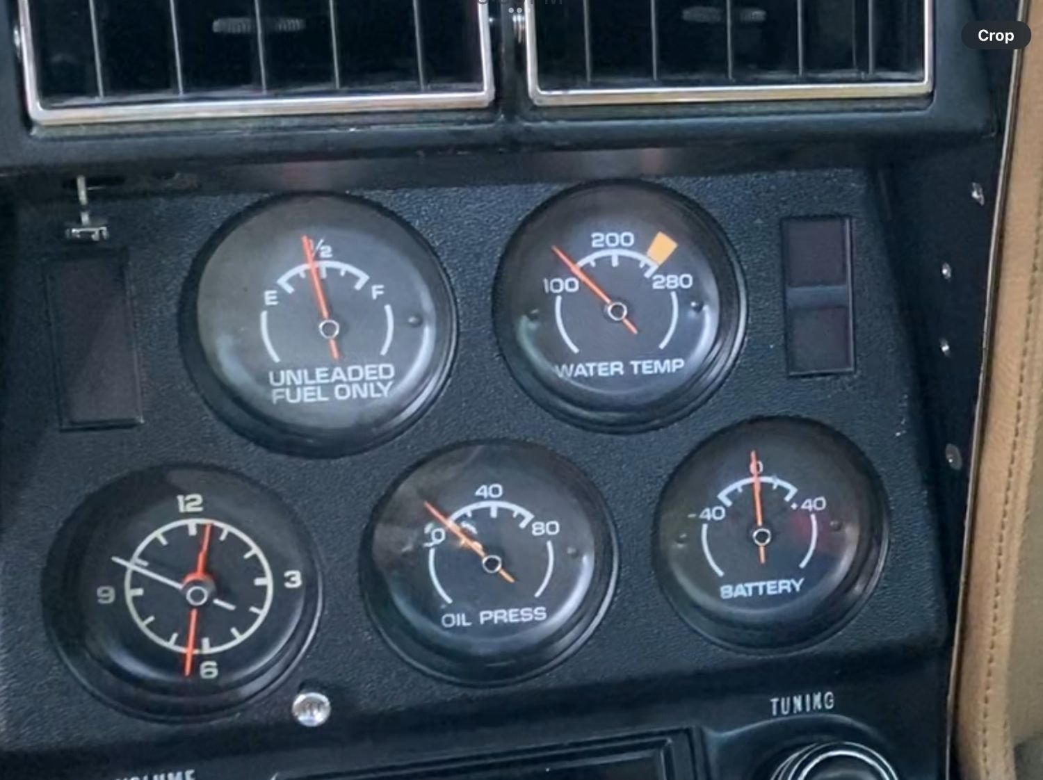

Just barely cruising around the neighborhood, about three or four blocks into my little journey I noticed the temperature was staying at 200, then suddenly I started to go into the red near the end of my trip, I’m probably cruising around at 20 25 mph, when I saw this happening, I let off the gas when I did it went back to 200…..pulled into the drive grabbed the temp gun, everything was normal??? Sounds like a bad fan clutch. Any thoughts ,
Keeping in mind my engine is a CHEVY CT602 RACE ENGINE. but this has never happened before.

It still doesn't sound like a cooling issue but... Can you post a photo of the gauge face, water pump, fan, and shroud?
At that low speed, your engine is relying on the fan to move air. When you are taking a temp gun reading, are you looking at various cooling surfaces like the radiator, hoses, and water pump? That the temp drops when letting off the gas sounds backwards to me -- higher revs allow more active cycling of the coolant and fan/air movement.
If it were timing, then I'd think you'd see higher temps all the time and not this swing from normal to hot.
If you are indeed getting higher than normal operating temps, I'm thinking the gauge is wonky or getting a wonky signal from the temp sender. I don't have any tips for testing the gauge or sender. I'm pretty sure there was a thread or three on testing the sender's resistance across different temperatures.

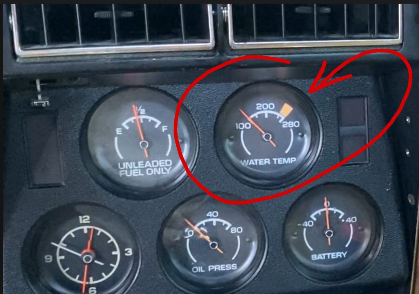

I’m talking about the gauge this featured in this photograph. I did trace the wire out from the engine bay all the way inside the automobile, there’s absolutely nothing wrong with the wire anywhere along It’s route. Now it could be the sending unit itself. But I’ll find out Monday when I start ripping things apart….again.
Thanks again for everyone’s help. It’s greatly appreciated. I have found out that this in particular Corvette is one step forward two steps back… I think that just might be the nature of these beasts.

Have you done the simple tests of the gauge?
The sending unit is just a variable resistor. If you short the connector at the sender to ground, you should read a very high temperature.
You can manually check the resistance of the sending unit.
You can also confirm all temps with an IR gun.

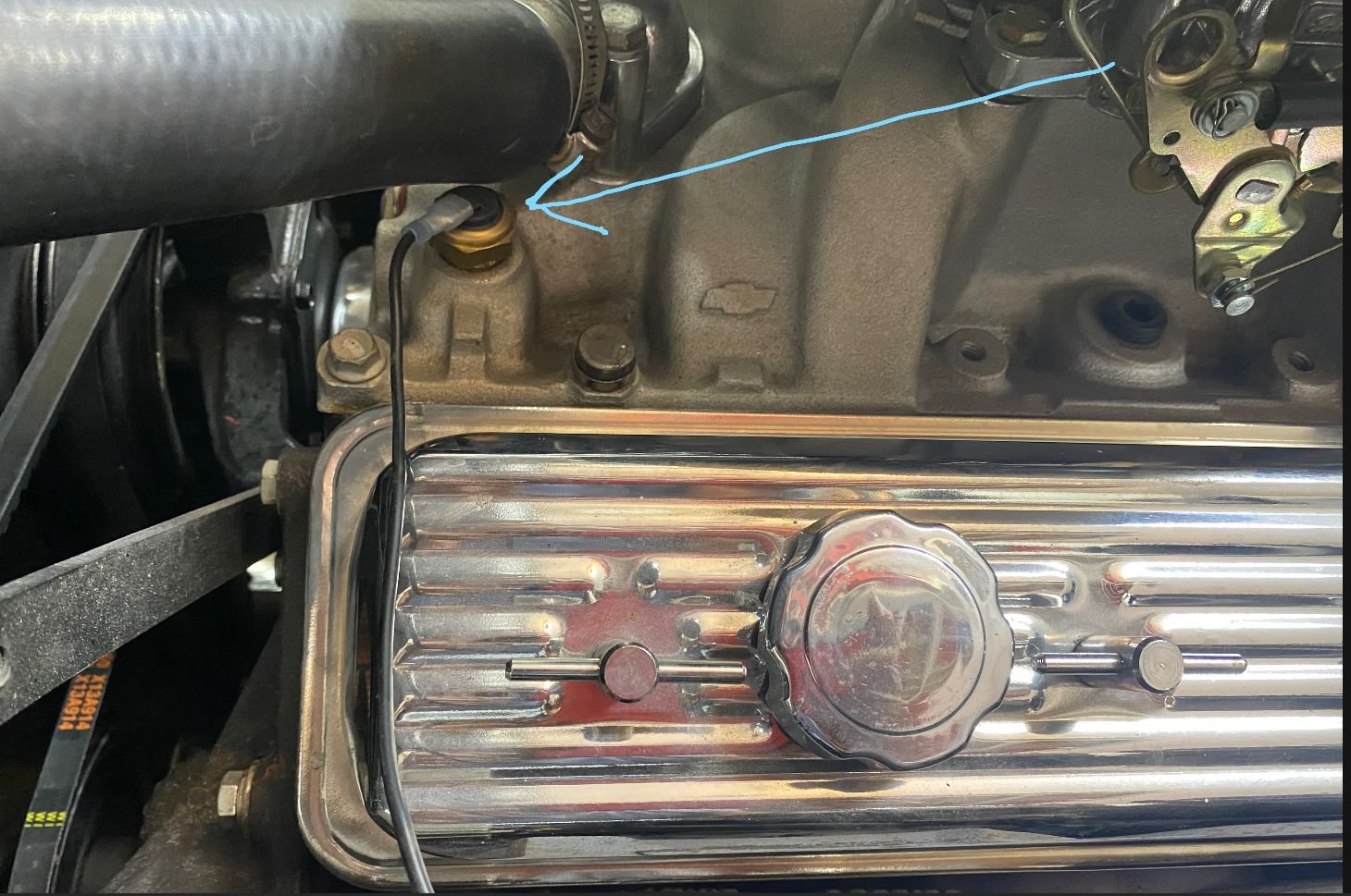

Isn’t this the temp sensor? There is not one anywhere on the sides of the block.
