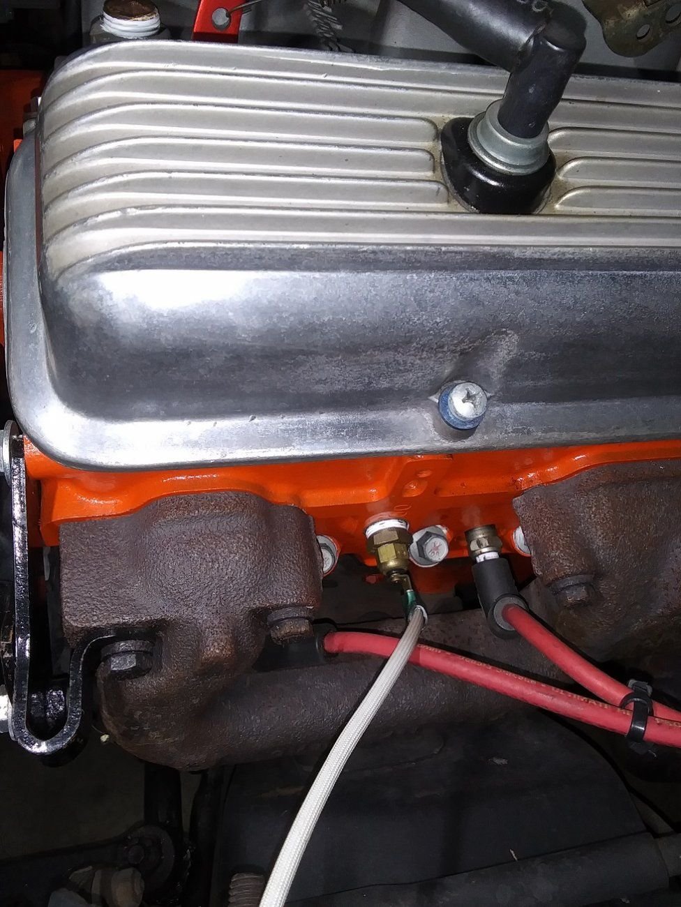

That’s correct. The factory location was on the side of the head. Like this.

There you have it, that’s my temp sensor, and it never reads higher than 154 on the temp gun, we just checked the temp gun against a probe in the kitchen this morning, and his spot on. going outside now to test it again in real time and see what’s going on. I’ll let you know.

ETRADIO,
As I understand it, any dash gauge that reads zero is not getting any voltage.
Any gauge that runs in the normal range is getting correct voltage & a good GRD source.
Any gauge that pegs-out is getting correct voltage but a "poor" GRD.
Its resistance that brings the gauge needle down to proper levels.
The senders are a "One-Wire" unit. So the GRD-ing wire are the threads in the casting.
A common error on sending units whether oil pres or temps is, a poor metal to metal contact during installation.
That's why you should never use a thread sealant or thread tape on the first few threads of any sending unit.
You want just enough to seal but not interfere with grounding.
Is that corrosion I see around the threads of the sender?
H-m-m-m-m-

No, it’s not rust, it’s the way the shadow looks in the picture.

Isn’t this the temp sensor? There is not one anywhere on the sides of the block.
Yes and No. There's probably Not a sender elsewhere, But there IS a plugged hole. I know it's a 602 race motor; evidenced by the dark-colored round-head sealed intake manifold "bolt" in pic. There is (just below pic's field of view) a plugged hole in crate's Vortec head that's between spark plugs #1 & #3. That's where an OE '75 sender is positioned; that's also where the parent L31 engine's Vortec head's sender is positioned. But, by convention, race motors typically position sender in intake manifold.
When the sender is positioned relatively low (as is OE in production vehicles), it is nearly always submerged in coolant (as it should be). Maybe your cooling system has entrained air that's intermittently trapped near where your sender is positioned in manifold; and that's contributing to errant/erratic signals to gage ?
Have you attempted to raise nose of car at an angle, and then purge any air ? Sometimes it helps to remove thermostat-water neck from manifold and fill block.
