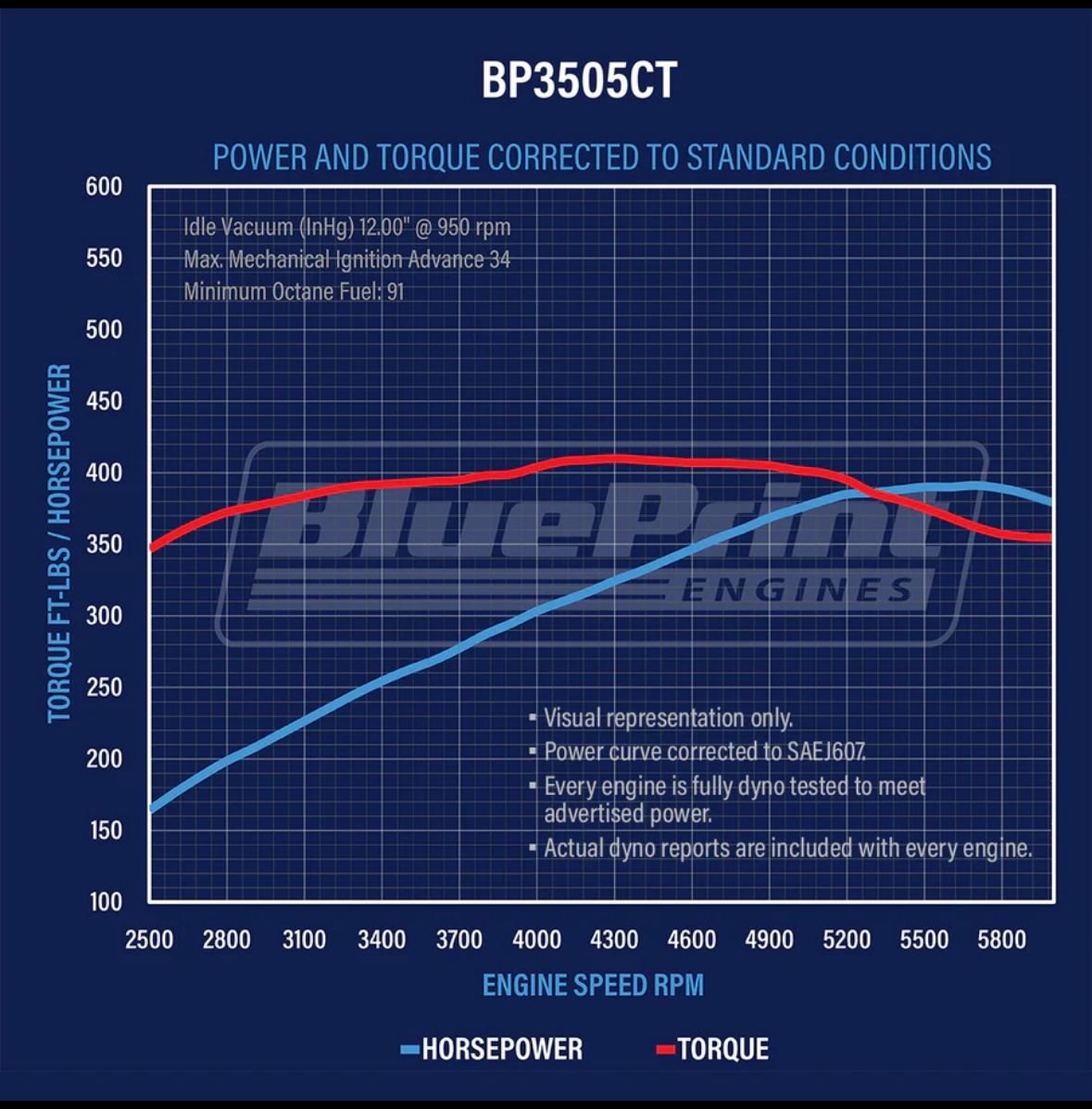

Do you have a link to the 390 engine you’re looking at? The one I’m seeing on Blueprints website says 12 inches at idle, which people run with no issues.

I just looked again and can't find where I saw the data that said 10 inches of vacuum on 390 hp BP engines and up. Looking tonight like I said I can't find that info, in fact they are 12 or 13 inches of vacuum. Has anyone had vacuum issues like headlights or brakes? I wonder because some people are going to the electric headlights, which might be because of loss of vacuum when using the bigger cams and separation of 110 deg or less. I don't want to choose an engine and then have to put a vac booster on or change headlights to electric. I'm asking because I'm sure there are guys out there that know better than I do so educate me please.

The Blueprint 350-390 has a much smaller cam than I had, and much better heads.
So similar HP, just at a little lower rpm. Say 6200 tops.
Yep dyno curve says the party is over by 6 thou.
I'll bet the idle vacuum is 12" -14".

I run an automatic trans so upping the idle is not a good idea for my setup. I'm really looking at the 350 390 hp with 14.5 vac. All the HP I'll need to cruse with and it does have a nice idle non rump cam with 115 deg. I like that combo for me and thanks everyone your input really dialed me into what I need. Oh and yes they say it will run on 87.
