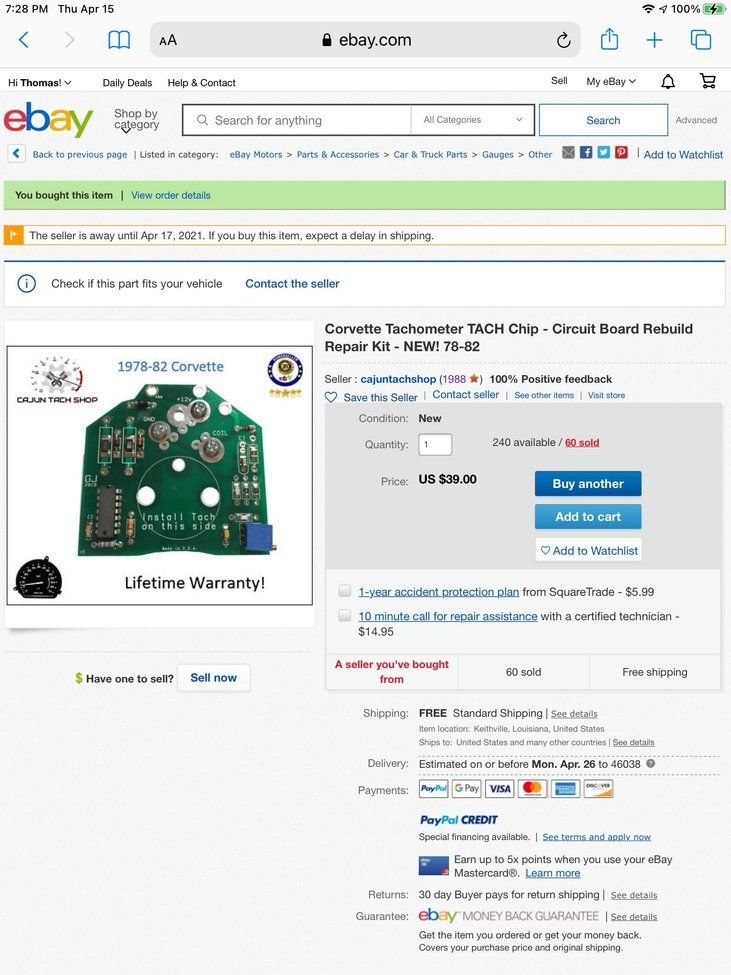

First thing to do is eliminate the tach filter. Remove both ends and put the tach connection into the distributor. No need for any interference. If still the same then need to look into the tach circuit board. Lots of links in the above post.

and after filter.. i found a board here that works.. and tried a few.. skip to post 140
https://www.corvetteforum.com/forums...uestion-7.html
