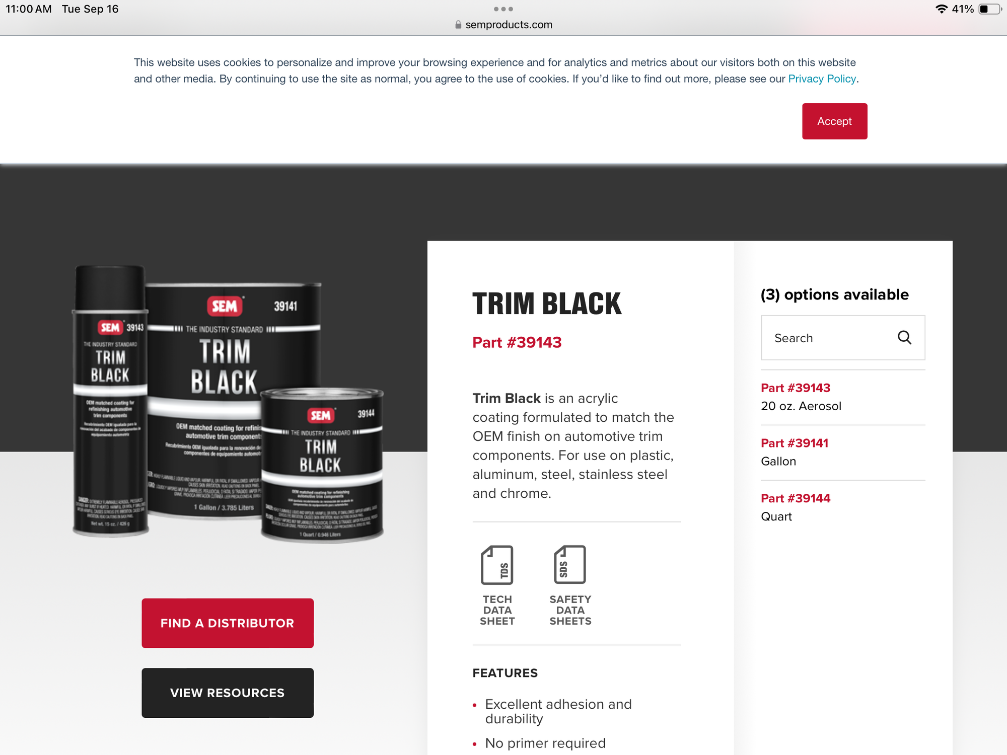

I’m actually using the same paint in the fender wells that I used in the engine bay, the firewall,
rear storage compartment and the wiper tray (windshield frame is POR15).
SEM Trim Black.
It’s an automotive paint and is good on plastic or fiberglass.
I get it through Eastwood and it’s available in quart cans or rattle cans.
It’s also available from Amazon and Summit Racing.
For some reason Amazon states it is unlawful for them to ship it to my address.
