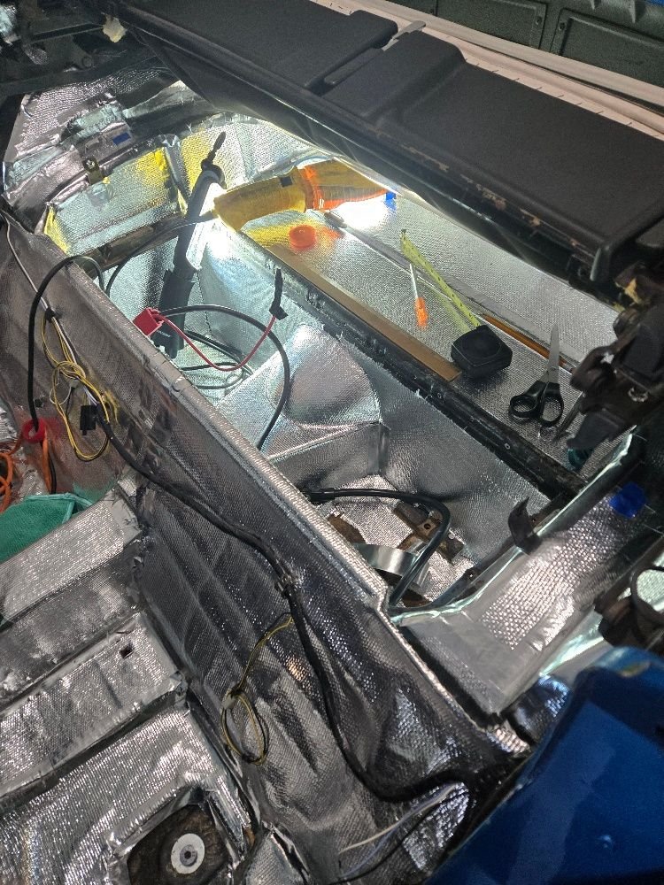

I've installed DEI 10400 inside.

Vettz73, nice install! Thanks for the pics!
Do you have results / comments / critiques?
How well does it perform?
I know that stuff is comparably priced to DynaMat, but was it worth it?

I don't have any performance results to report as yet because I'm now in the process of installing new carpet.
As for comments:
Since the DEI material is stiff, I needed to create individual pieces to fit into the different contours of the floor and rear wheel wells. That process required cutting templates out of brown wrapping paper and then transferring the pattern to the DEI material. I also made sure to not cover any of the locations for the seat track bolts and seat belt bolts.
The DEI material that I used has an adhesive backing so I first had to scrap/clean out the old rubbery tar material that had been applied by a PO.

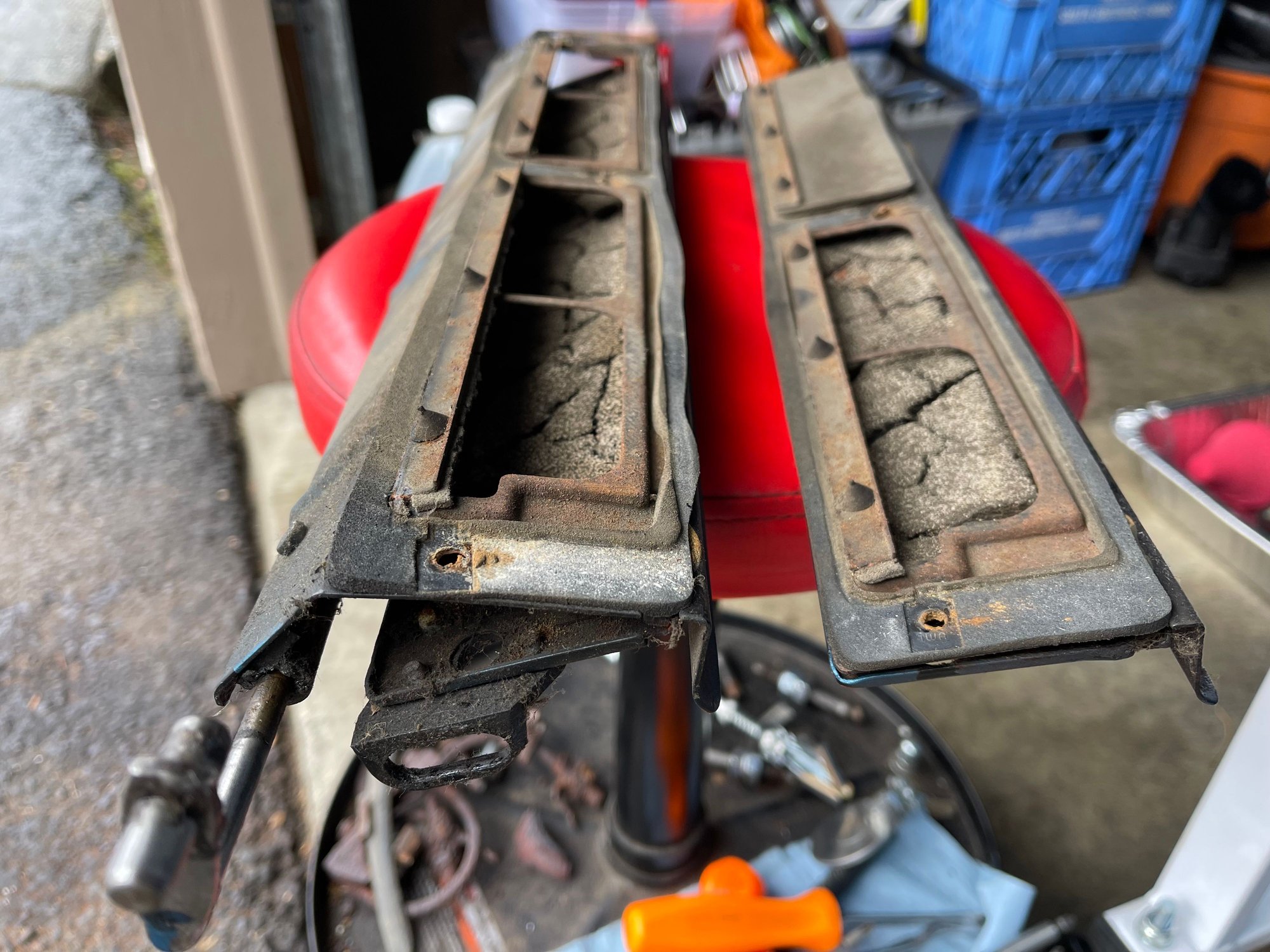

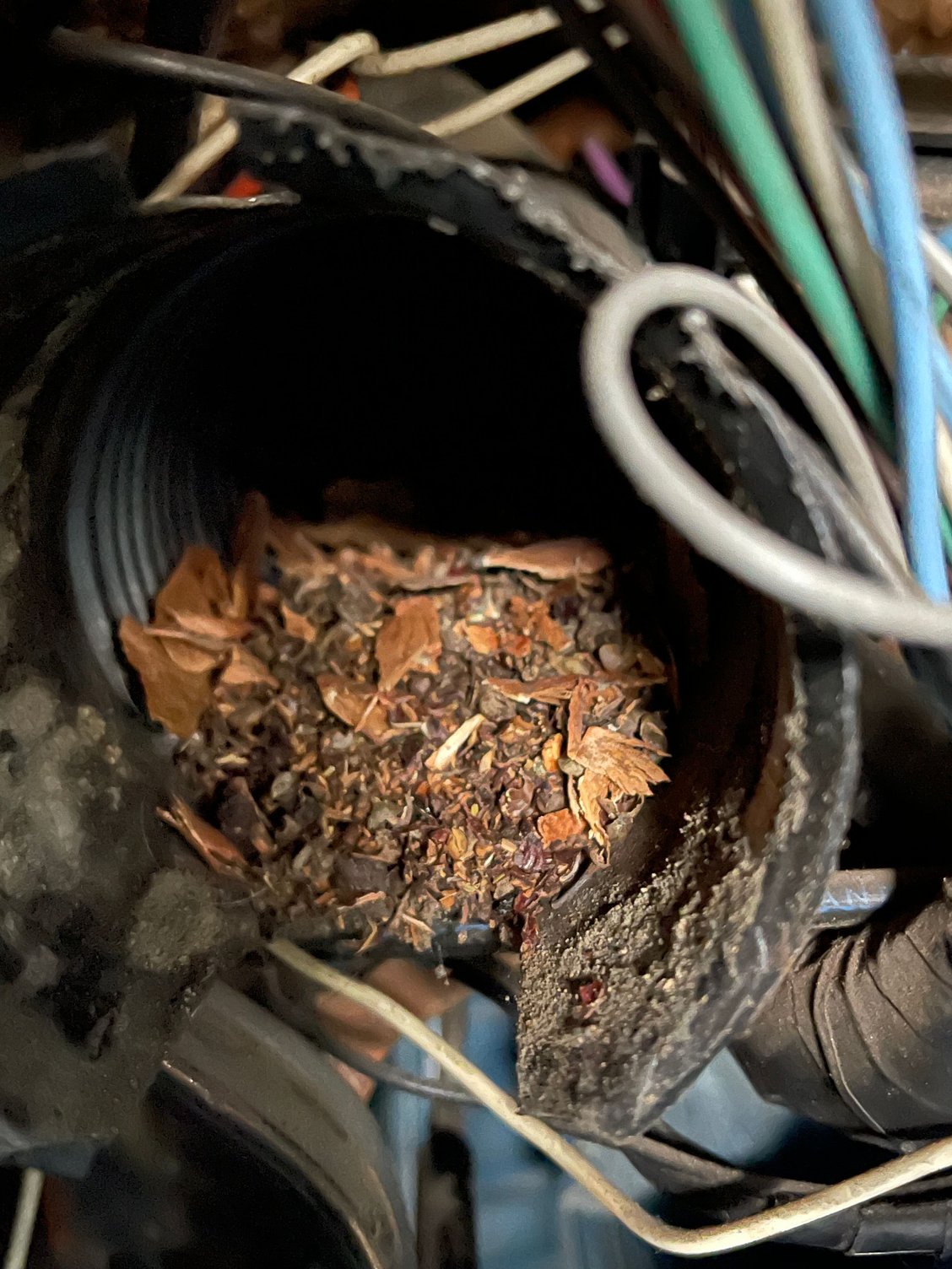

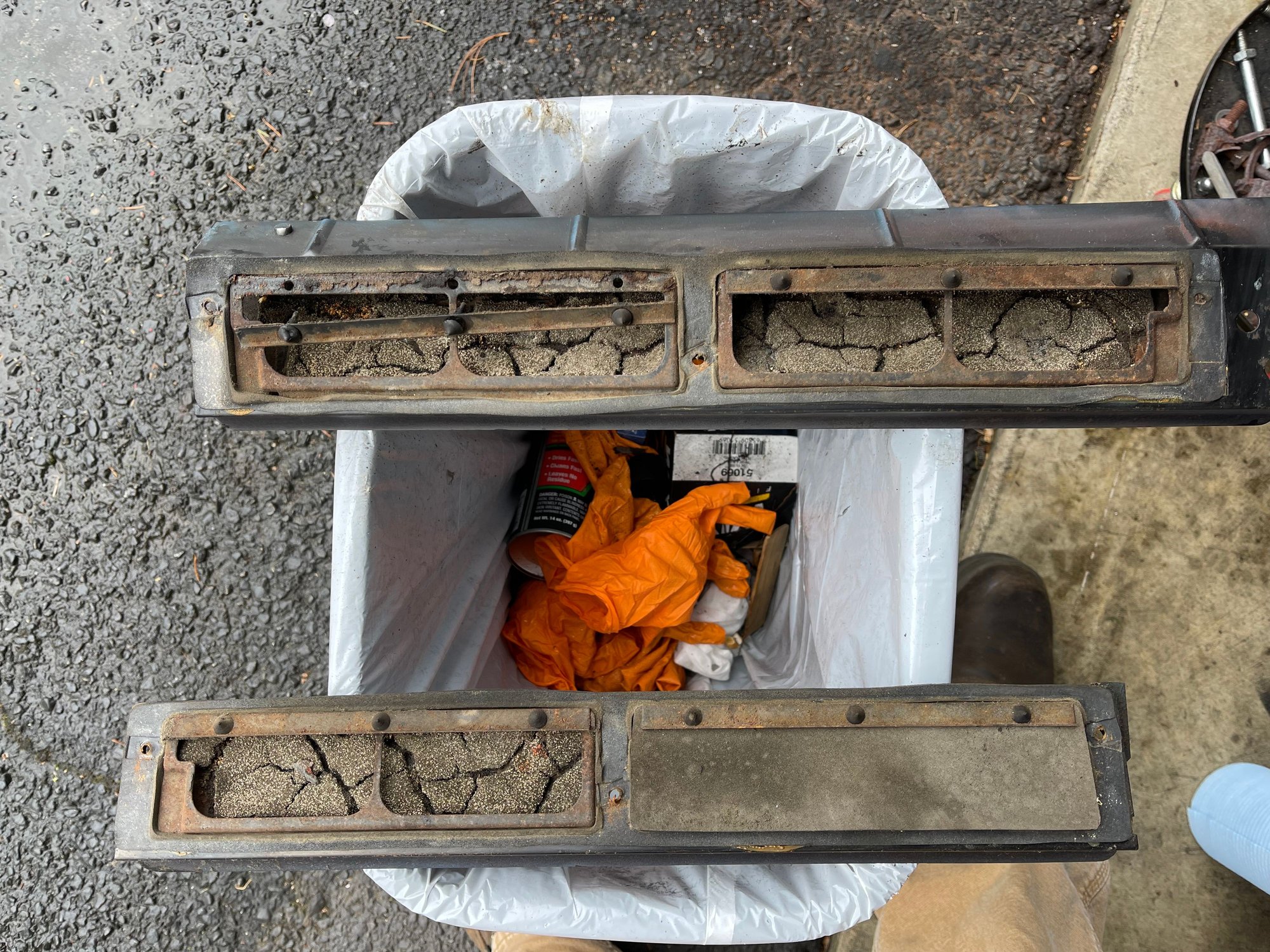

When Dad & I started this, he mentioned “water” and “critters/bugs”. So as I got into it a lil further, he was pretty spot-on.
I have to check the Astro-Ventilation drains in the rear deck, especially since the driver’s knee vent tube had traces of a critter in it…

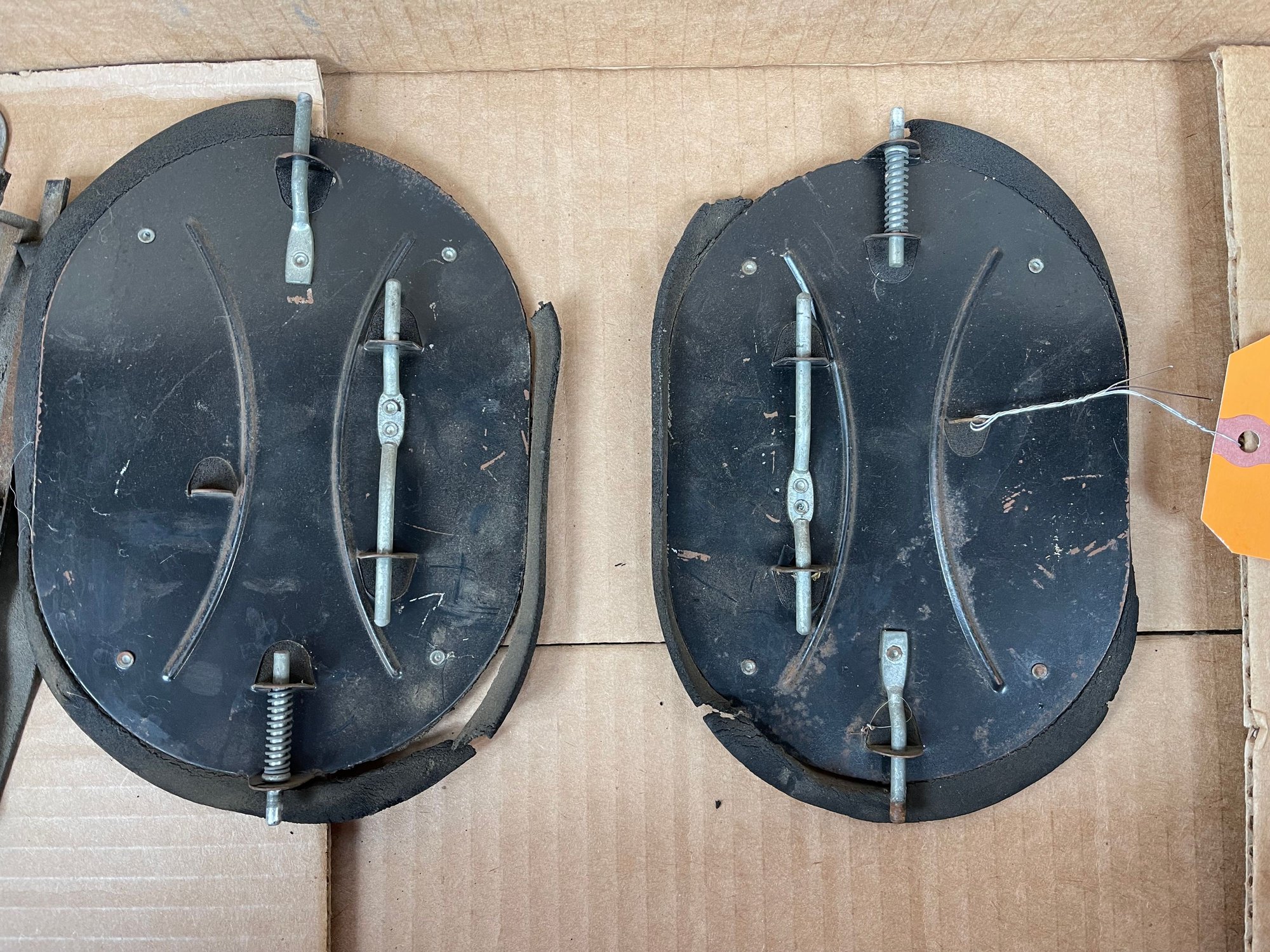

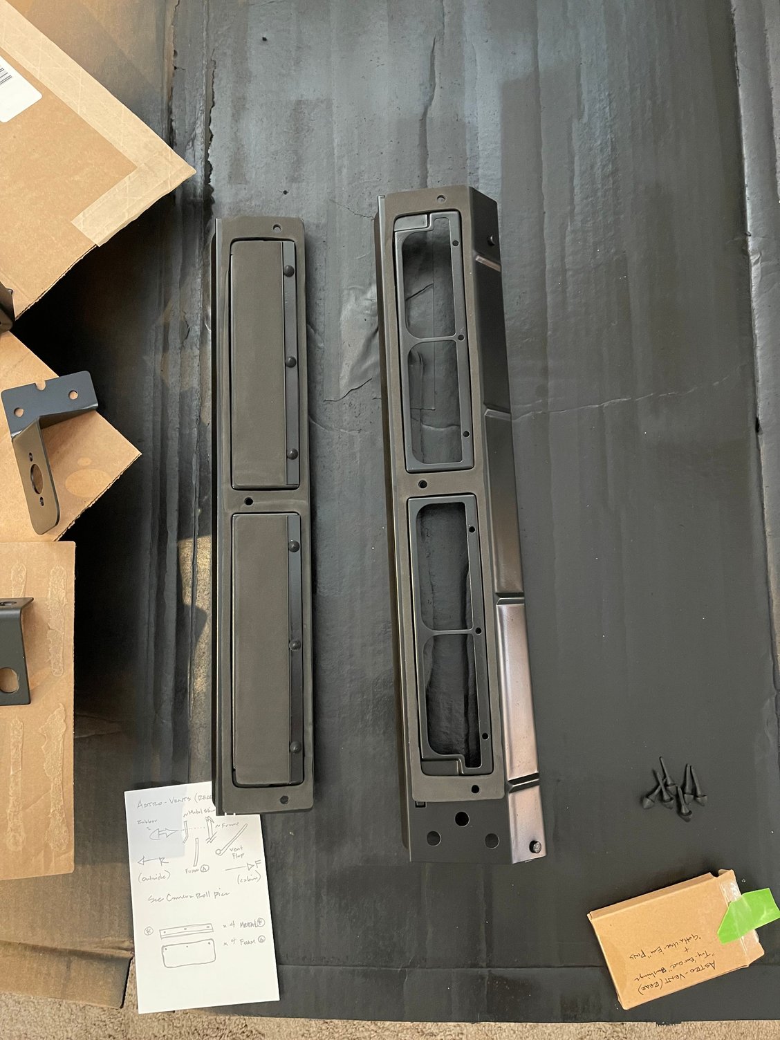

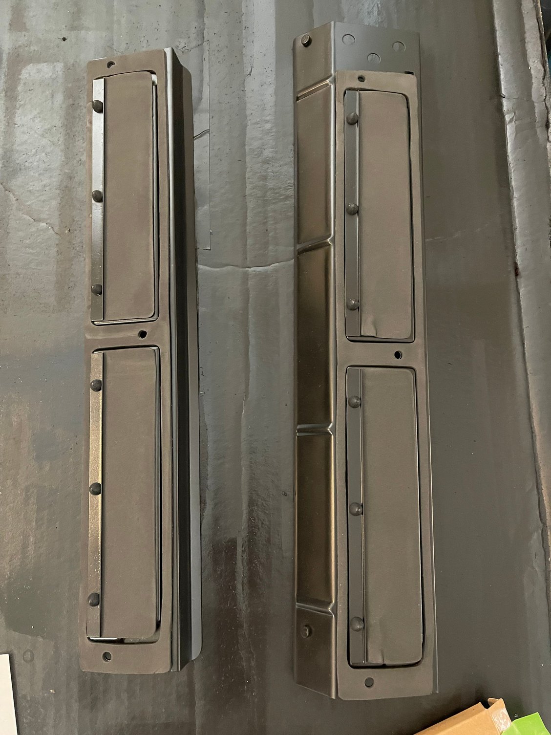

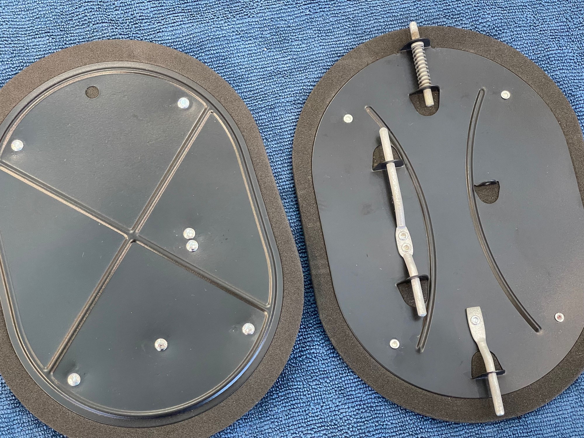

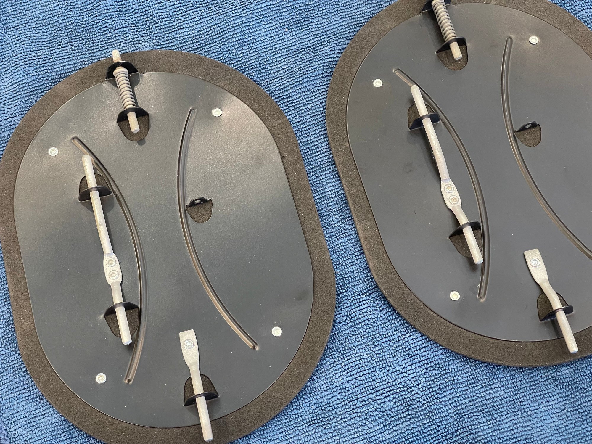

Anyway, yeah, renewed vent flaps [oval], and rear-deck flaps [rectangular] have already been addressed…
Renewed & tested…

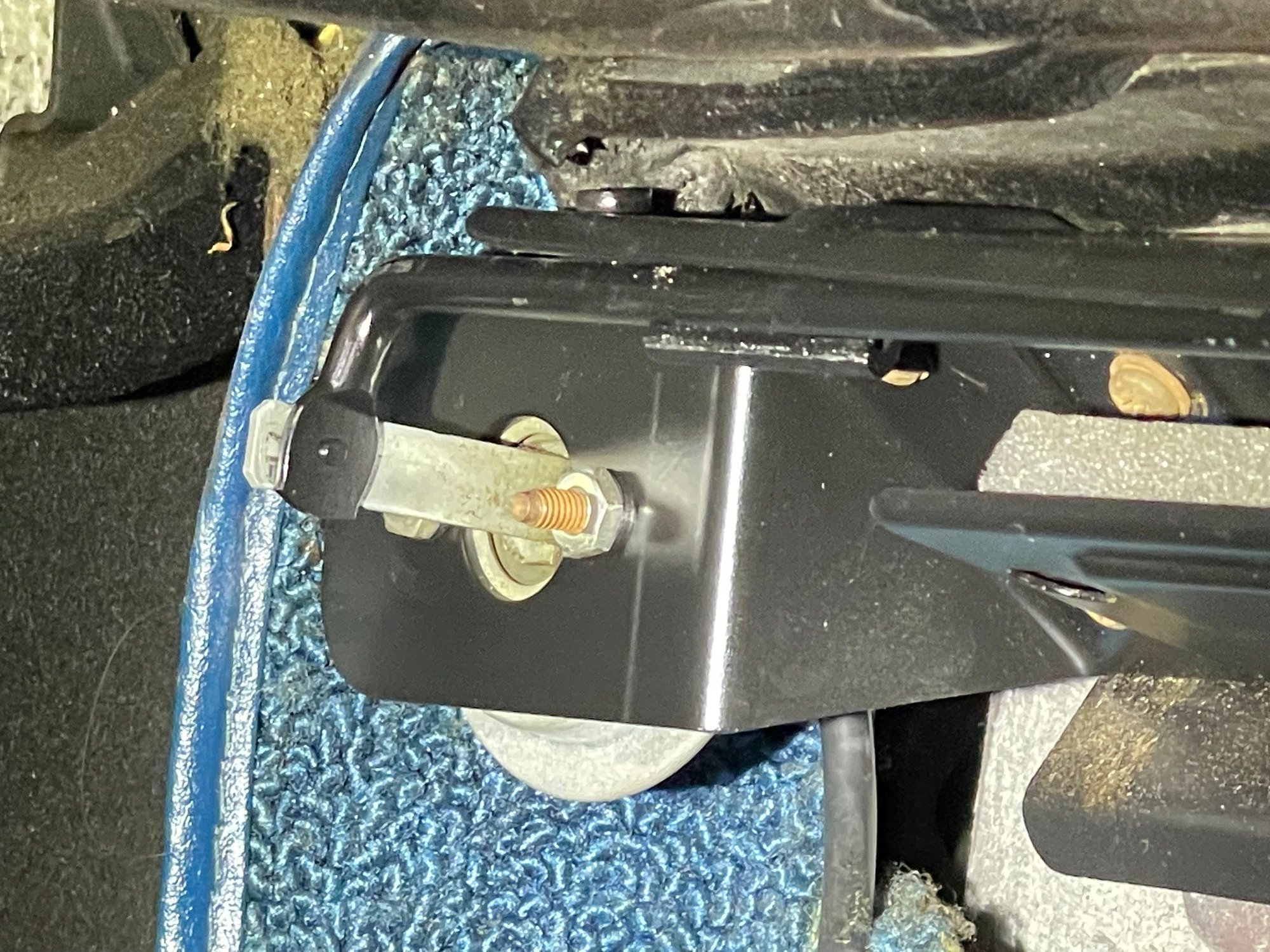

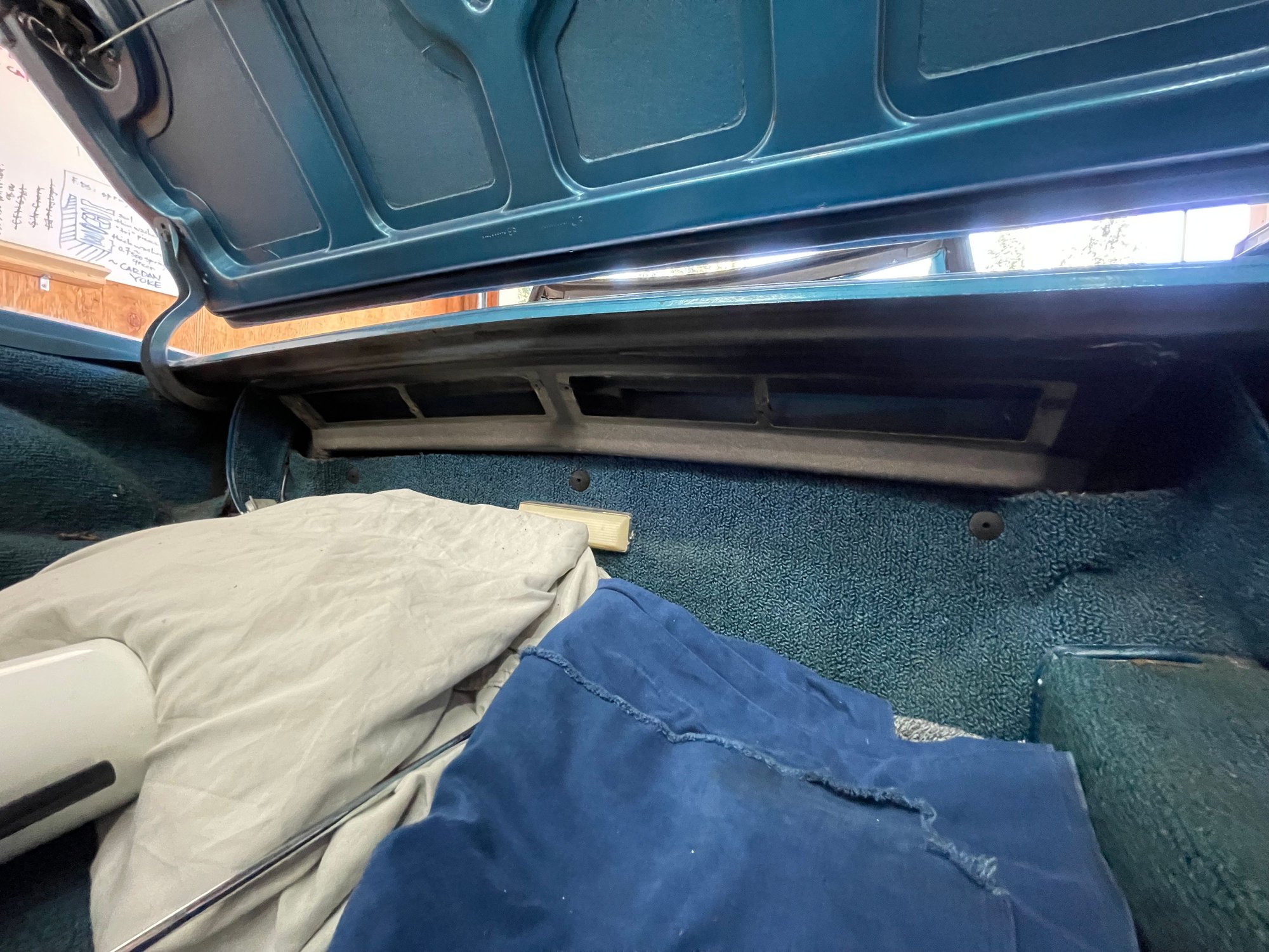

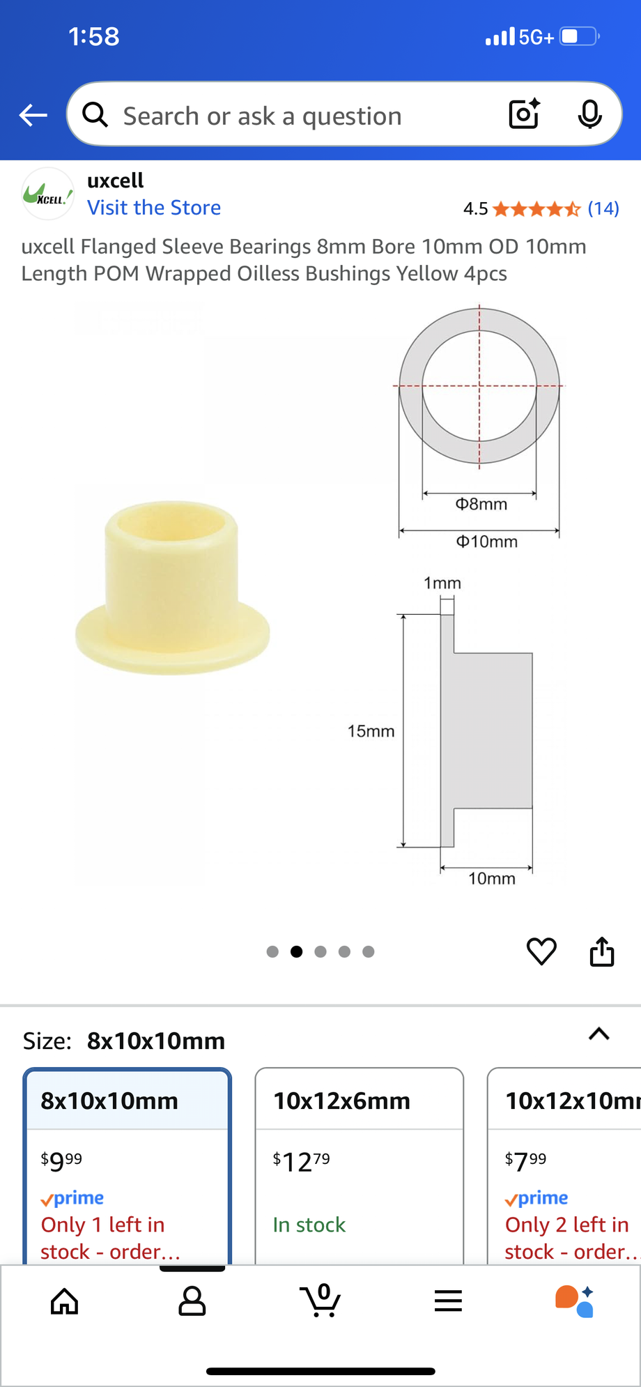

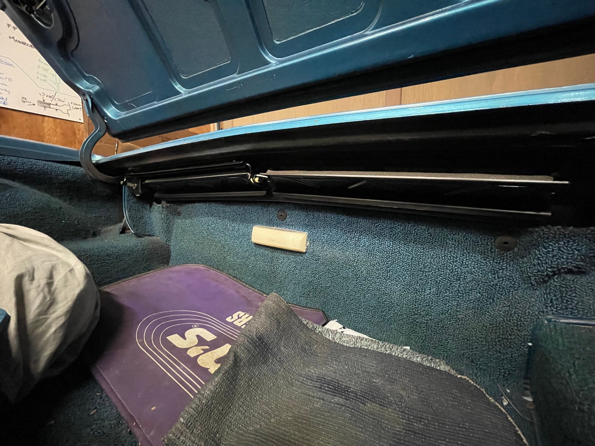

While I was in there [the Astro-Ventilation rear flaps], I tried to (and did) solve the rod-to-flap clearance issue.
uxcell oilless bushings:
Bushing fits nicely without trimming
… from Amazon; that uxcell brand has saved my butt on a few hard-to-find-small items.
Zoom in, above the courtesy lamp, couldn’t make image smaller w/o exceeding file size limit
