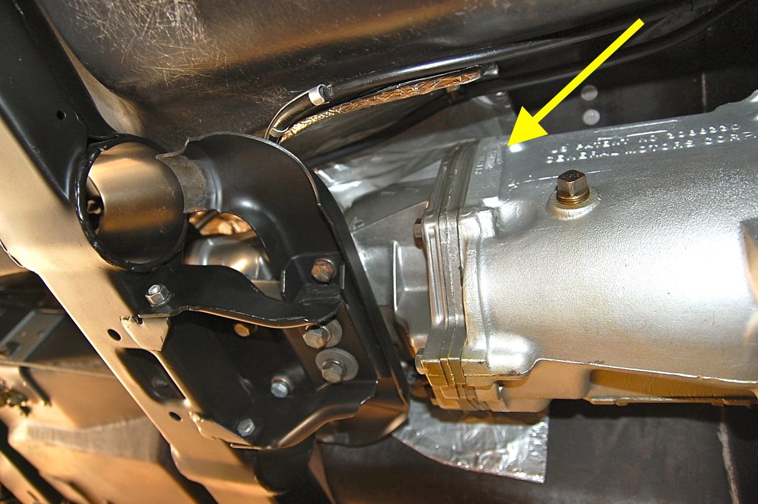

Automatics also had a modification to the passenger transmission tunnel fiberglass:
