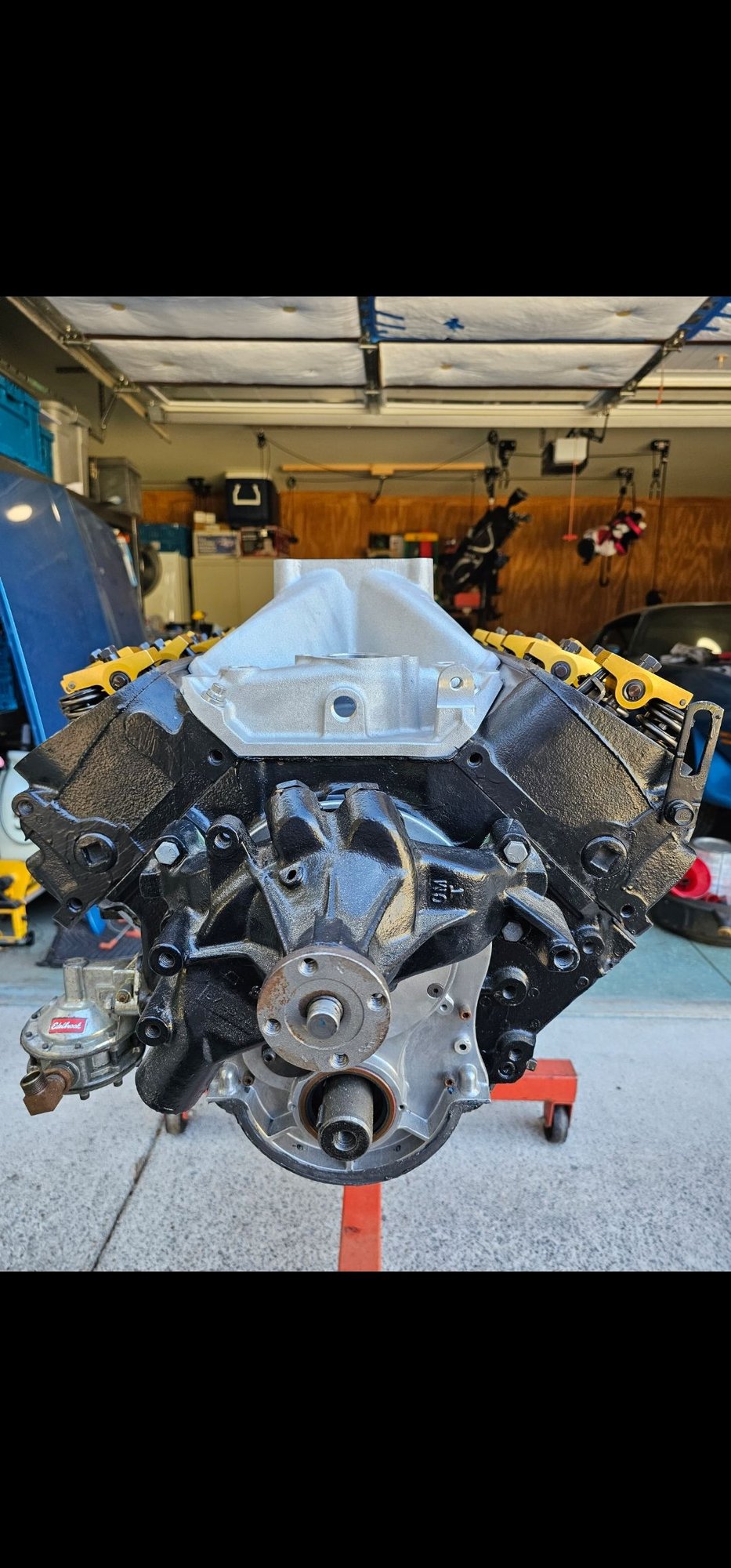

I am rebuilding my L88 '69 427. It didn't have a timing pointer on it when I bought the engine. I bought a Summit Racing gear driven timing set which doesn't appear to have a spot to mount the timing pointer (tab). I am thinking the pointer would mount on the block, which is why I'm asking this to see if anyone can help me figure this out. I am running a 7" damper. I have already bought a timing tab which is supposedly for my generation block but it doesn't match up. Any help would be greatly appreciated. I'll attach a picture of the front.

The stock timing tab attaches to the timing chain cover. Since you have installed a custom cover, you now need to procure or fabricate a custom pointer and set it up by doing an accurate TDC verification and adjustment of the custom pointer. That would have been best to do prior to installation of the heads, but can still be done with a TDC check tool.

Replacement tabs are readily available. Just google BBC timing tab. As Lars points out, the trick will be to figure out how best to attach in the proper position.

It just bolts right to the timing cover where the two bolts are....just get a Moroso billet pointer and bolt it on.

You will need an adjustable pointer then as Lars said YOU will need to establish TDC and adjust it to that.

so sorry 'bout its optics; but many a timing pointer's been made by looping a piece of welding wire under a bolt-head.
