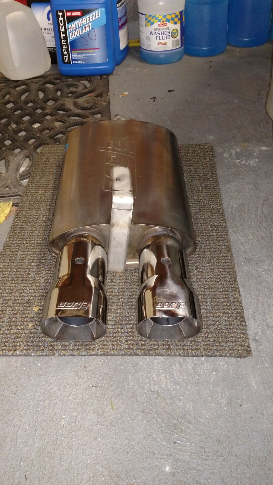

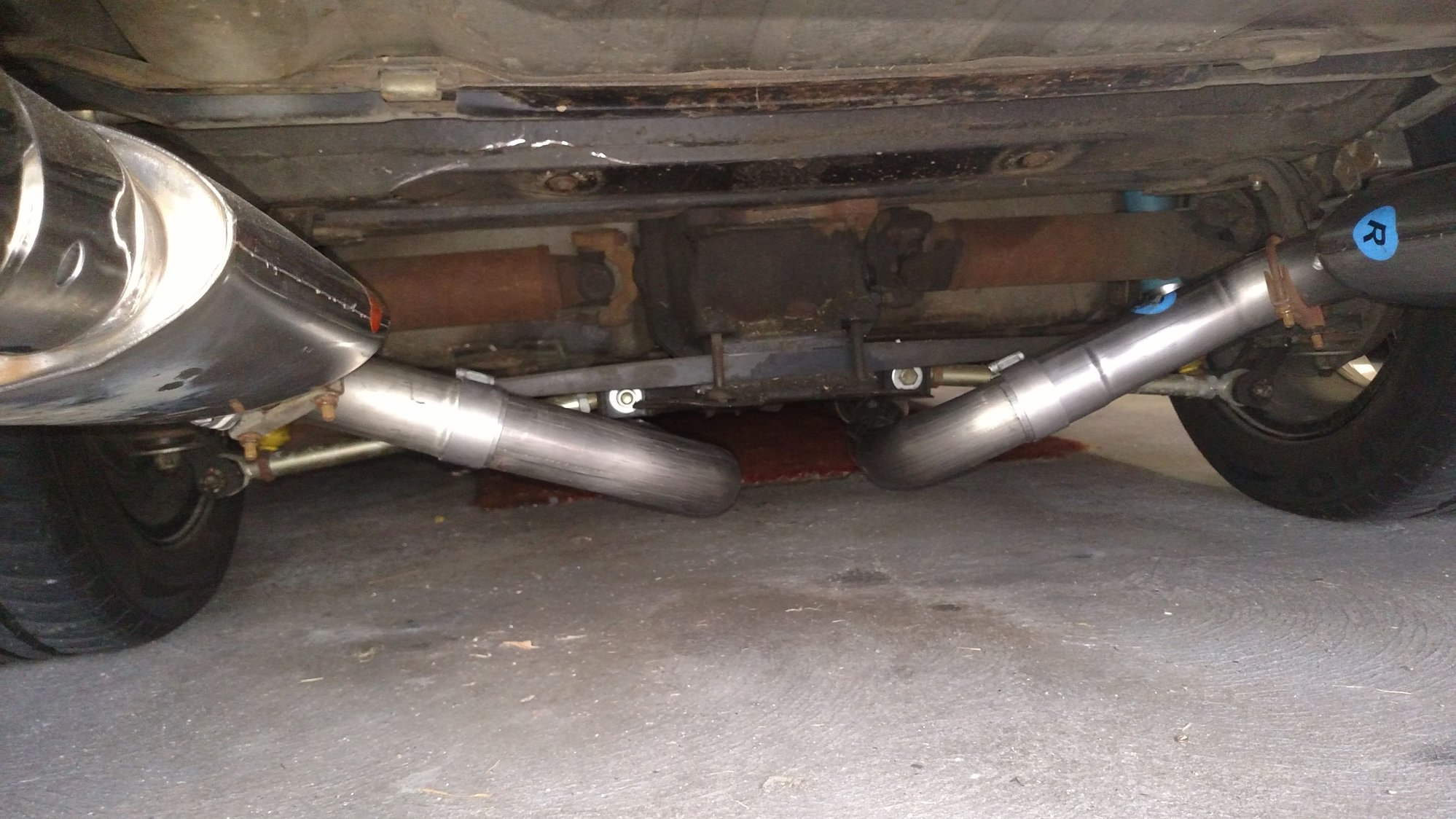

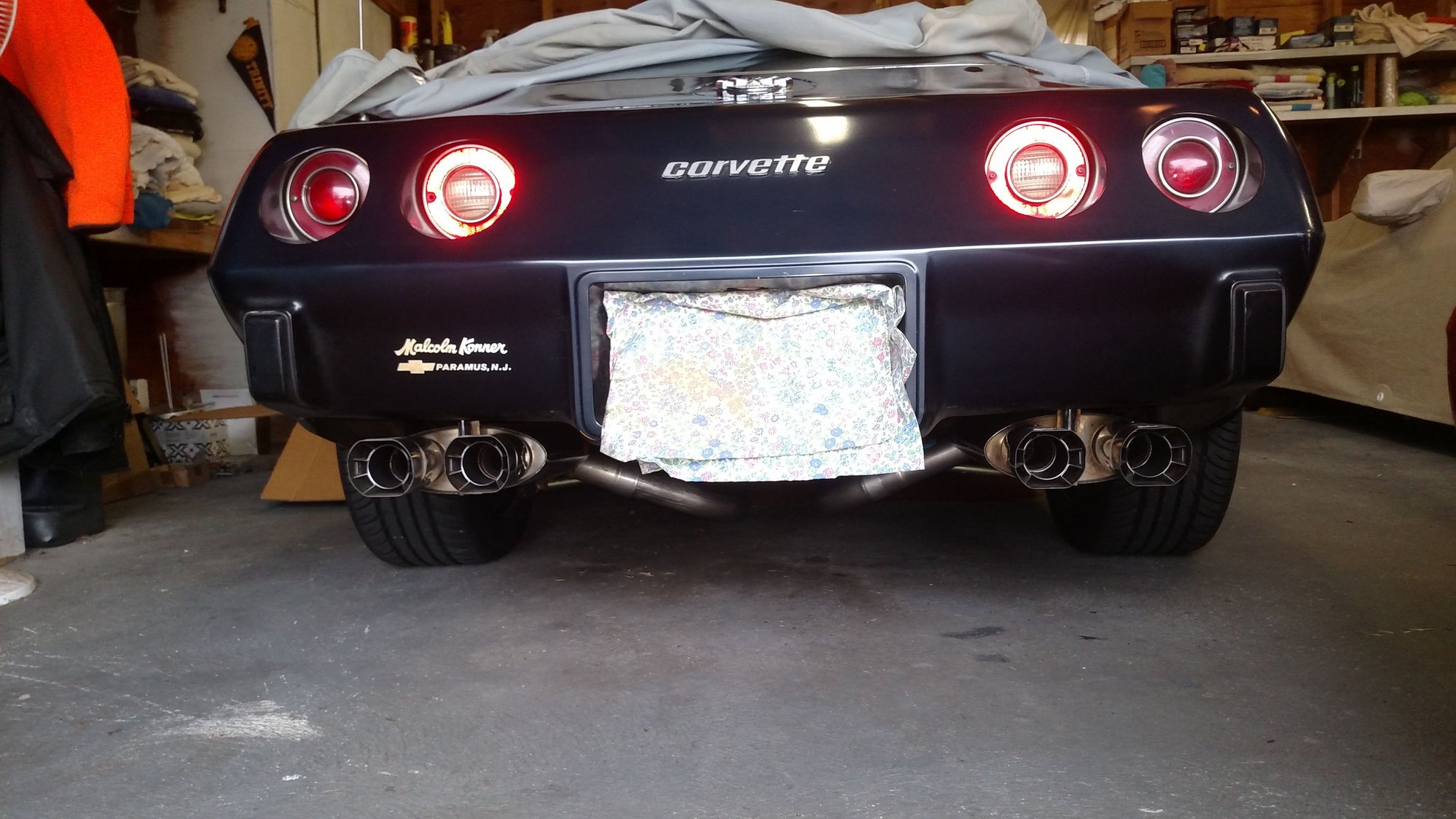

My exhaust is a bit different than most C3's I have seen over many many years primarily for 2 reasons:
1. Most folks run 1 5/8 inch Long tube headers (LTH), shorty headers or stock exhaust manifolds. As you can see in the pictures attached, I have 1 7/8 inch LTH headers for the Gen 1 SBC engine that are stainless steel AND ceramic coated for heat rejection, longevity, and appearances. I don't think you can easily find 1 7/8inch LTH's for the Gen 1 SBC today that are Stainless Steel.
2. I swapped out Monza Turbo mufflers (somewhat restrictive) a few years ago for Stainless Steel Borla Corvette C4 Type S dual Square tipped mufflers which not only are pretty much straight through BUT are the only muffler that I have found have a distinctive smooth european type sound (no motorboat sounding rumble) unlike the typical magnaflow, flowmaster, etc mufflers AND are the only muffler that has a moderate idle volume, reasonably quiet at cruise allowing for easy conversation but loud when pressed. 2.5 inch pipes. Borla C4 corvette mufflers custom fitted for my C3 are extremely pricey but are very different. I stole mine for $400 on an open box deal with no damage, just a slight bend easily corrected, one 1 inch of one tip. you can se the slight damage in the first picture below on the farthest right square tip. These mufflers today are about $1500 for the pair. I just looked the other day.

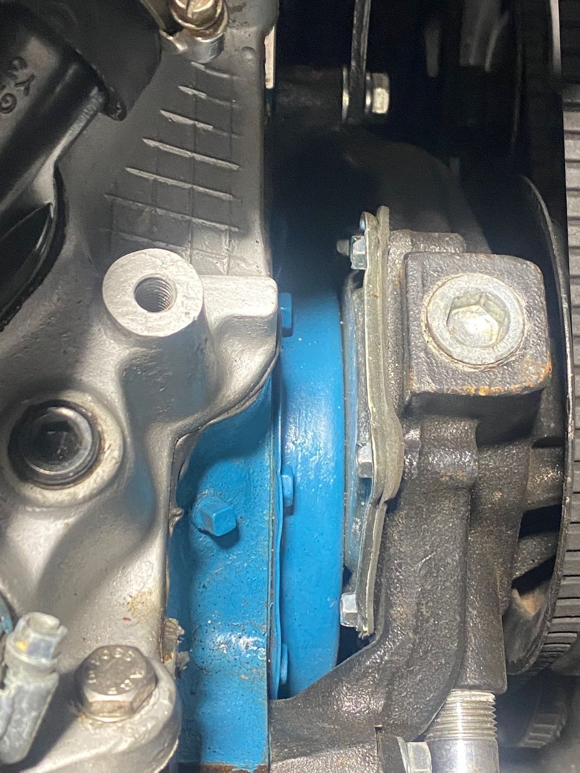

The factory L-82 Gen 1 SBC timing cover is thick steel AND is literally right up against the Corvette water pump (zero clearance) to reinforce it from any movement...going on 13 years now........not a chance it flexes..NONE. Other applications do not have the same water pump/timing cover structure so "theoretically" it might flex..I doubt it with a double roller timing chain.
picture of the Stewart Stage 2 aluminum Water pump against the timing (can't slide a sheet of paper in that area) cover as the rebuild process began with disassemble pictures^^^^. There is no way that steel cover can flex.......same on new L-82 355..just prettier..LOL

Sweeeet looking Vette my friend!
Thanks!

Timing covers can become subject to force from a camshaft's forward motion; and accompanying cam button pressing into rear of timing cover.
Insofar as it seems not mentioned, many (if not most) aftermarket Aluminum water pumps have a Design Feature to help address that potential stress on timing cover.
Look at most Aluminum aftermarket pumps; specifically at Front view, And along lower edge of casting. You're likely to find what most dismiss as a mere curiosity.
On most aftermarket aluminum sbc pumps, there is a small boss (thumbnail size) extending downward And it has an "empty" Threaded Hole in it.
Once pump is firmly bolted to block, that empty hole is perfectly aligned (by design) with CenterLine of camshaft.
That empty hole is intended for user to install a bolt or stud into it; then adjust same so as to exert a light pressure onto face of timing cover.
That pressure is intended to prevent timing cover flex; It WILL do exactly as designers intended. And, this ain't anything "new".
