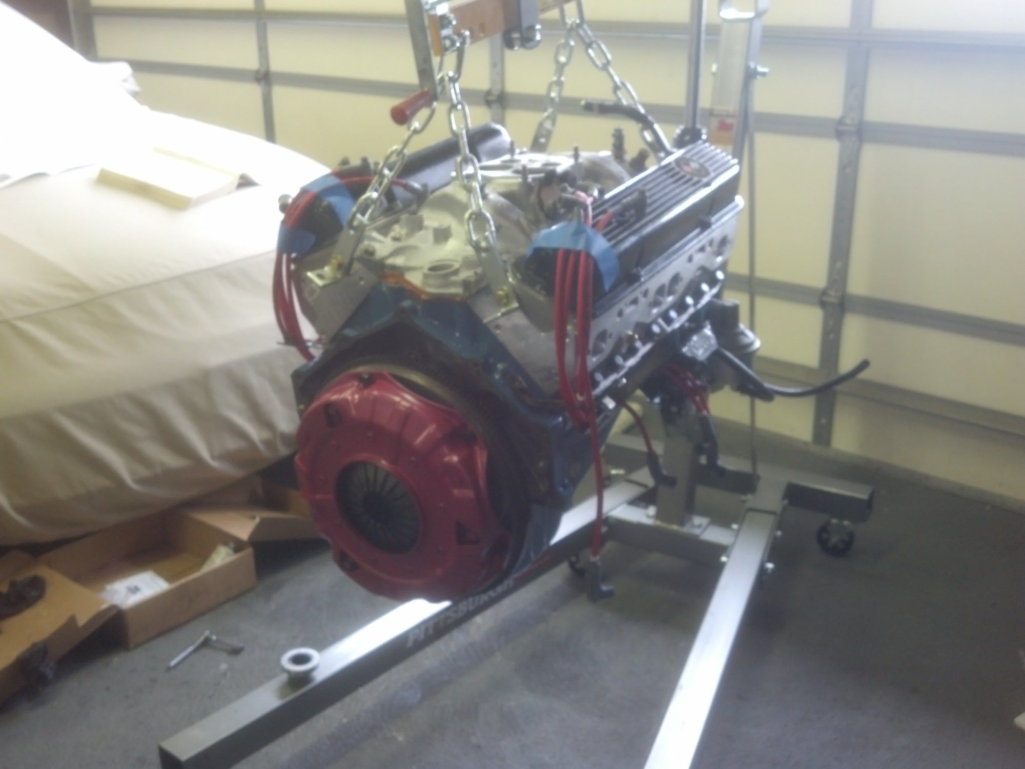

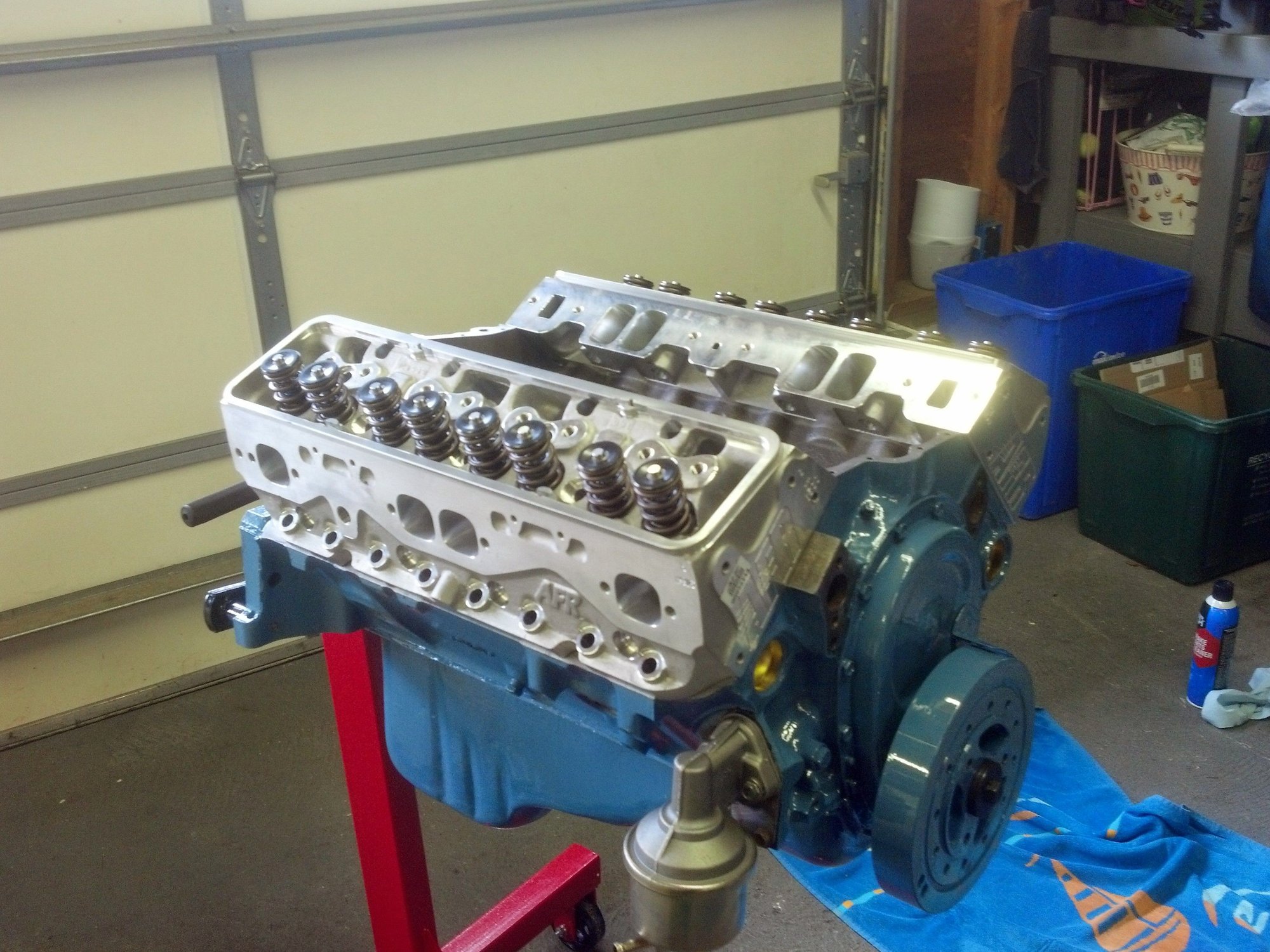

Rebuilt my OEM L-82 4 speed with 3.70 gears in 2014 with 65,000 miles at the time.
New JE Forged racing pistons, 64 CC 180 AFR heads (absolutely worth the extra $'s), reconditioned the OEM L-82 Rods, OEM reconditioned L-82 Forged crank, mildly ported the OEM aluminum L-82 intake, rejetted the Holley 4175 650 CFM vacuum Qjet carb on the car since 1985, Howards Roller cam (219/225 duration, .525 lift, LSA 110, operating range 1,500-5,600 RPM), and .015 head gasket for a final compression of 10.2:1. The result have been outstanding with smooth idle, strong low rpm power, stunningly strong BIG mid range torque, pulling hard to 6,000 RPM (rare). Pretty much looks and sounds like the OEM L-82 with the hood open, AFR aluminum heads, not withstanding, at idle.
