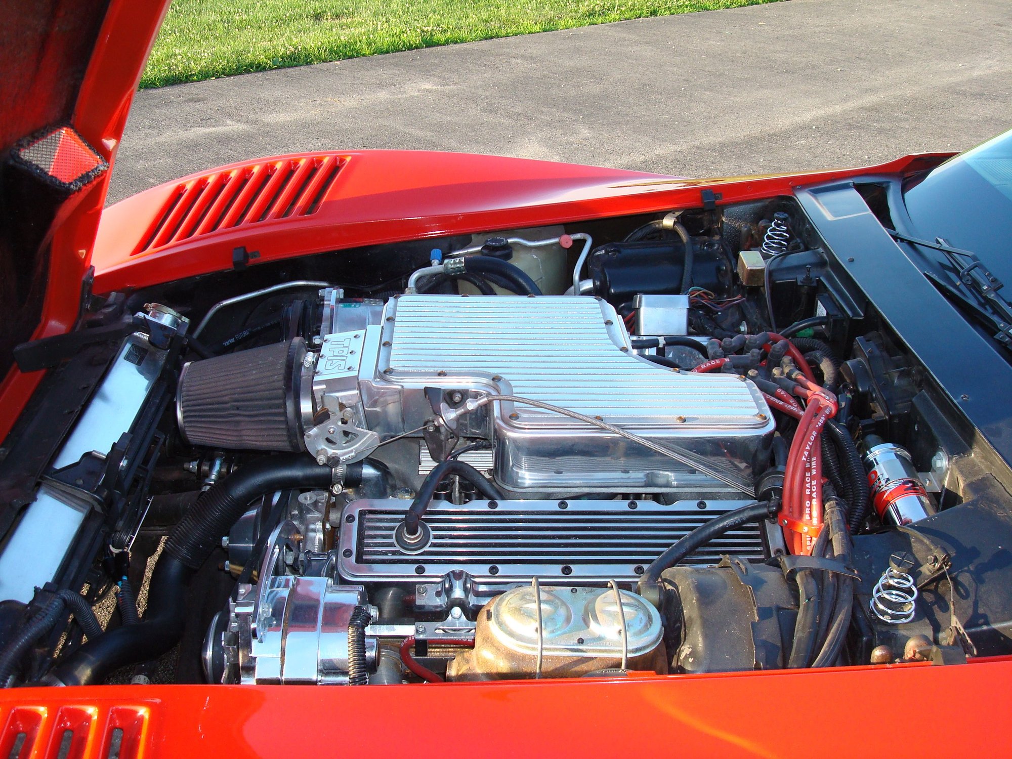

I've been reading thru this post and wondering if there's any hope for doing something to my L48 in my 77? It's mostly stock except for aluminum intake, rebuilt Q-Jet, headers, true dual chambered exhaust, and Lars' distributor weights and springs, 3:70 rear gear, Rebuilt Turbo 350 trans. Yes that helped but, we all want more! I'm thinking different cam and maybe heads but, the L48 is more of a base engine than the L82 so I'm not sure if there's any hope! I just don't want to drain the bank. Any suggestions are appreciated! Dan

Aftermarket heads with 64 cc chambers or even smaller and a cam properly speed out would help a lot.

Comp cams 270H and Sportsman II heads got me over 300HP. The flat tappet cam is /was the biggest cam you could use with everything else stock. Then add an AirGap dual intake and a Classic 4779 Holley and it will make considerably more HP. Now you are digging into the engine and using flat top pistons with a steel shim gasket to get the compression up to 10:1+cr.
HP costs money, no way around it
