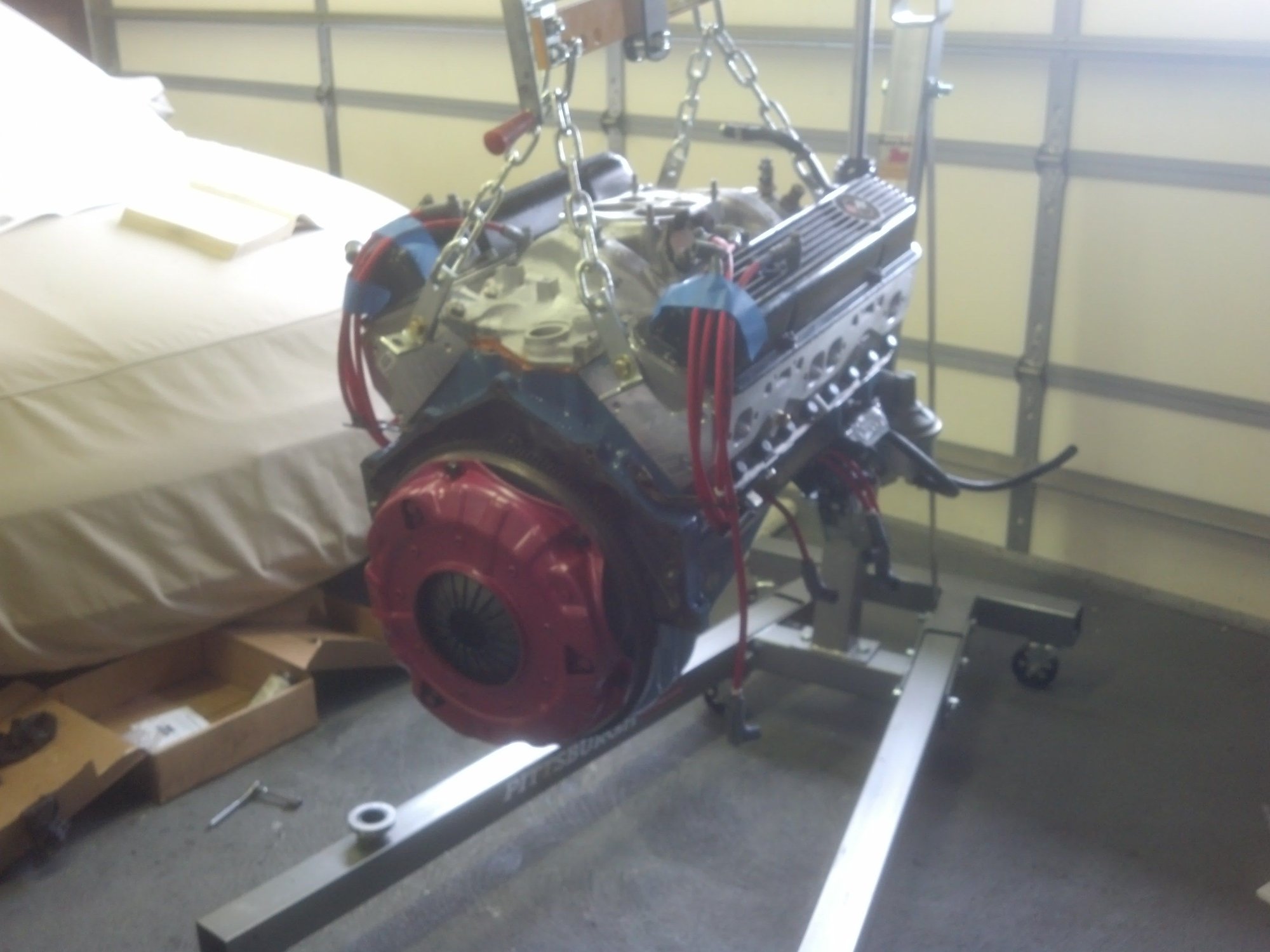

This is solid advice^^^^ from a guy who did want to keep his OEM 78 L-82 4 speed with 3.70 gears original as much as possible.
Back in 2014 with me doing most of the work except the machine work for the short block (boring .030, reconditioning the L-82 rods, reconditioning the L-82 forged crank, and assembling the short block with my purchased JE forged racing pistons), me purchasing the AFR heads/Howards roller cam kit, reusing/porting the aluminum L-82 intake, reusing the Holley 4175 on the car since 1985, oil pump/everything else including a new RAM clutch kit, and various other parts and issues, the total cost was $5,500 using top parts I selected for my L-82 engine goal . I pulled and installed the motor myself with some help.
Is a 355/383 crate engine less expensive than my end product with similar power and built with the same precision and quality products? Probably not, BUT much easier.
Going with an LS configuration in a C3 is a completely different direction. No question that an LS is extremely cheap power for short money but the question you have to ask yourself is that C2/C3 really still true in some extent to the original intention by GM/Duntov 50-60 years ago? Not saying it is wrong but just not a C3 any longer to me, my opinion only.
When I get into my 78 with the rebuilt/upgrade 355 L-82 GEN 1 SBC, it still feels, smells, sounds and drives like a C3 just with more power than L79/L46/LT-1 by a lot and handles/steers like a C3, just much better, with all the changes and tweaks to the OEM suspension/steering/brakes I have done over the last 40 years BUT with the OEM design in mind.

100% agree that the L-82 is a tremendous platform, pretty much the last of the Gen 1 SBC built really stout from GM. I was one of those die hards in 2014 that wanted to retain as much as possible from how the engine was conceived and built by GM in October 1977 for my engine.
My original intent back in 2014 on the OEM L-82 engine with 65,000 miles on it was to refresh it with cam and heads but when I removed the stock 882 heads I discovered some issues. I bought the car in 1983 with 35,000 miles on it, and is typical with used cars with performance, this being an L-82 4 speed 3.70 gears with the gymkhana sport suspension option along with AC (no other options-no power windows, no power door locks, no rear defroster, no tilt steering column, no anything), the car was abused and street raced, probably.
As you can see from the engine pics above, it was well maintained by me during its life but who knows before. Today, it pretty much looks like an OEM L-82 with the dual snorkel air intake still in place and most external GM parts visible like the heavy duty fan and clutch for the L-82 AC cars but the addition of the AFR eliminator aluminum heads and 1 7/8 inch LTH headers, obviously, are not stock, along with 2.5 inch dual exhaust with C4 Corvette Borla Type S mufflers. Running a howards roller cam with .525 lift/LSA 110, duration 219/225 motor should be good for around 450 Gross HP with 10.2-10.3 compression...Looks like a 78 L-82 4 speed but runs like a beast when pedal is down......

Originally Posted by JohnnyStingray
<snip> Here is the rundown of what I went with:
AFR 195/64 heads
Dougs 1-3/4 tube headers
Pypes exhaust
Howards Hyd Roller dur@050 225 int./231 exh, lift 0.500 int./0.510 exh, LSA 112
PRW 1.6 rockers
Performer Intake (had to for hood clearance!)
McLeod Clutch
Rebuilt Q-Jet
Pertronix Flamethrower ignition
Sounds like a much improved combo over a stock L82!
That is a pretty well scienced out combo. And will run better than my LT-1 ever did.
The AFR heads are top notch.
My only thought is that with their excellent exhaust flow, and a good Pypes exhaust, you do not really need a split duration cam.
They are for restrictive exhaust cars.
I would assume you will see no HP advantage to it. And it will have all the downsides of larger duration, more overlap etc.
Now it is only a +6 split.
But I would think a 225/225 112 would run just as well, and drive slightly better.
It all depends on what you are looking for. Sound, powerband, etc.
But I would not just rebuild that QJet, i would seriously have Lars recalibrate the cruise circuit.
Increased overlap drops the vacuum level, and affects the cruise mixture.
Either tune it with an AFR gauge, or let Lars do it.
QJets are very finely calibrated, and very sensitive to changes as well.
There are only a handful of people worldwide, who have the knowledge, and the parts, to tune the AFR on a Qjet.
For the absolute best running combo you can get, I would speak to Mike Jones for a cam profile, and Lars about the QJet.
Just check out what amazing results Stingr69 has been able to get with his Jones cam /Lars QJet combo.
Those two have forgotten more than what the rest of us ever knew!

Might be late if you all ready have the parts for your build, but as others have noted, pretty stout selection for your build.
I heard the same about the AFR 180 64CC heads I run about using a single duration roller cam versus the split duration, but honestly, I would be hard pressed to imagine that my 355 L-82 would run noticeable better if I had run the roller cam with 225/225 duration versus my 219/225 that I currently have in the motor, with the emphasis for the street, low end grunt and strong mid range torque which is where my L-82 355 really shines. Either 219/225 duration or 225/225 would be my choice, not any higher, for a street engine, along with 110 LSA versus 112 or higher to concentrate the power band. If it was me, looking back 12 years now on my combo, I would shoot for more lift than I currently run .525/.525 lift, but closer to .530 with 225/225 duration, LSA 110.
Lastly, I was strongly encouraged to run AFR 180's NOT the 195's for a 355 since the 180's theoretically have better low and mid rpm air velocity along with stronger throttle response. Not that the AFR 195's are a problem, but for optimal power with strong low end grunt, BIG mid range torque, and sub 6,000 RPM HP, the AFR 180's appeared to be the better choice over the 195's for my 355.
Just some thoughts from my real world experience.....
Thanks man. I love hearing everyone's builds. Yeah I have everything already bought. I mean...is this gonna run ok? What should I look out for when putting it on?
I'm a busy realtor so the demolition phase is taking a minute or three longer than I'd hoped.
Haven't bought the exhaust yet. Still on the fence
