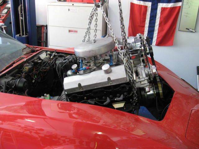

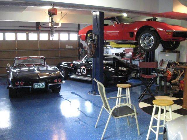

Originally Posted by Bikespace
@lars ' garage must be built differently than mine.
I think I have a pretty normal setup... Notice chainfall for pulling engines - no cherry picker. Prior to the chainfall, I used a come-along. No need for fancy equiment to pull an engine out of a Vette, but you have to have some beer on tap:
Just a come-along and a chain is all that's needed:

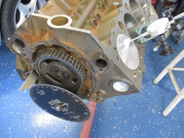

Installing a cam correctly means you need to check it and correct it. Here I'm degreeing a cam for an L79 327. I wouldn't consider doing this with the engine in the car - that would be a truly horrible experience:
Damn good looking garage my friend! Nice collection too. Are we playing 'one of these things, doesn't belong here' from Sesame Street? lolol.

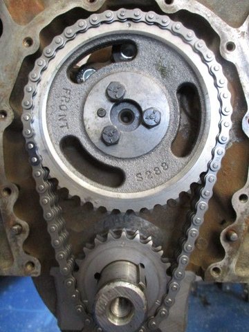

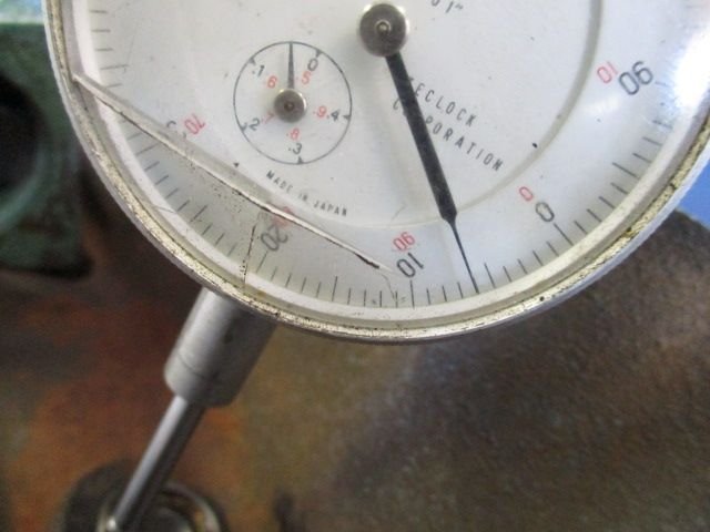

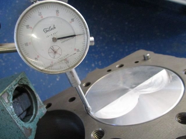

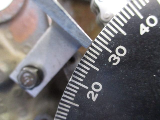

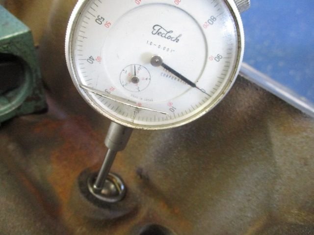

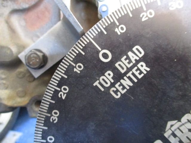

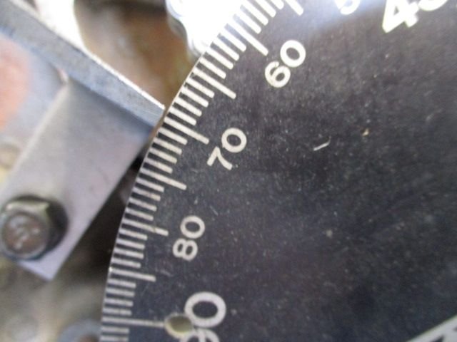

I did this over the summer, in the car, my hammies were sore for a couple days. But glad I did, I had to retard a new cam 2 degrees to get it to match the cam card.
Interesting - I degreed mine on an engine stand and had to retard 2 degrees as well. Always need to check.

Keep in mind most cam grinders often grind 4 degrees of
Advance in there cams. GM on thier performance grinds grind in 0 degrees advance. That is why it will likely be of benefit to advance your stock cam.

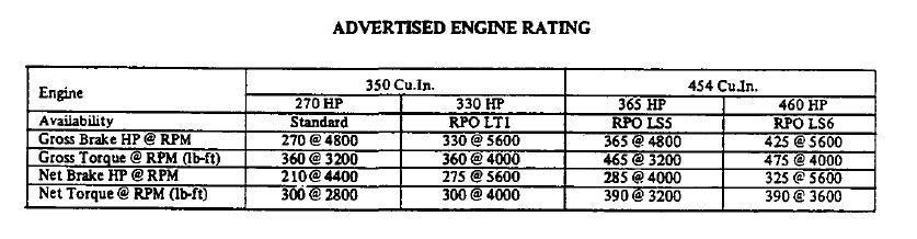

300net HP in that configuration would be around ~355 gross HP , with stock heads.
Add the excellent AFR heads and you add somewhere between 50 & 70 HP. So ~410 gross HP
Add JBL82s HR cam and gain a few more, ~430 gross HP.
Quite a bit different than the original motors ~225 net / ~265 gross HP !
Here is the original GM LT-1 HP, rated both ways in 1971. 275 net/ 330 gross HP
You can see how much better an L82 can be, even than this well regarded, but stock engine.
The L82 starts only around ~10 HP shy of the LT-1, given equal exhaust.

Be advised:
Unfortunately, there is No Linear relationship between SAE Gross and SAE Net power ratings; there never has been. Any such relationship cannot be calculated.
At Best; Only educated guesstimates.
MOST Engine Dynos operated by local shops and by boy racer TV shows, do report power ratings in terms of SAE Gross.
Both Measurement and Reporting in terms of SAE Net is Far more complicated.
Moreover. the differences between example A Gross v. Net, are Not directly applicable to example B.
FWIW: MOST power ratings for Performance Crate Motors that're advertised in catalogs and on-line ad copy are presented in terms of SAE Gross.
FYI: If IF you download the vehicle info kits from GM History Archives (free download) there are usually power graphs shown as well as in tabular format.

So true.
Conversions are only an approximate. ( ~ )
Gross HP is repeatable on a dyno.
That is why most use it.
Net HP is as installed in the car, with all accessories, water pump, ps, ac, air cleaner and factory exhaust system in place.
Accessories can vary between car 1 and car 2,. In particular High Performance engines are hit hard by factory exhaust and mufflers. The bigger the cam overlap, the more exhaust restriction hurts.
Duntov said the factory "quiet" mufflers alone cost 50 HP on a 70 BB.
Very few test engines both ways.
HP conversions can run anywhere from 75% to 85%.
Even in the GM data above, the conversion varies by engine.
L48 = 78% Net to Gross
LT-1 = 83%
LS5 = 78%
LS6 = 76%
Any conversion % you pick is just going to be a reasonable estimate.
The biggest issue I see in the data above is how well matched the exhaust system is to the engine.
The LT-1 does relatively well with the BB 2-1/2" exhaust system.
The same system, with a LS5 or LS6 chokes it relatively more on net HP.
All the little things we do, like headers, air cleaner, exhaust dia and mufflers, help the net HP up and bring it closer to the gross HP.

My description of the lack of equivalences and linearity between Gross and Net; try as you might, it cannot be explained away. It simply IS and it exists.
Oh, my goodness, I've run countless comparisons over many years ad nauseam, looking for some magic insight; the hole only gets deeper.

Gross HP is measured at the crank, on an engine dyno, headers, no air cleaner, carb & distributor at optimum settings
Net HP is measured at the crank, on an engine dyno, but with stock manifolds, air cleaner, full factory exhaust system, all accessories and factory carb & ignition timing settings. Exactly as installed in the car.
Almost everything listed under net HP can easily change from car 1 to car 2, because so much of it is external to the engine.
And factory carb & distributor timing settings are not set for maximum power. They are normally too lean and too retarded, both for emissions and just being conservative for warranty.
Using 80% for a net to gross HP conversion will almost always get you within +/- 5% of the real number.
That's pretty decent for a ball park.
That would be within +/- 20HP on a 400HP engine.
But it'll never be perfect.
Trying to decide when you should use 76% and when you should use 83% is pretty fruitless.
I know of no one who runs dyno tests in Net HP terms, except the factory. And that is all they do now. They switched from Gross in 1972.
