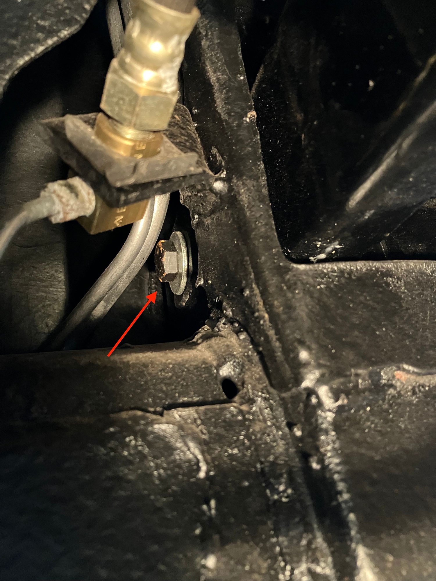

Guys:
I can't find the torque spec for this bolt / screw. It's located down low in the right hand rear tire well. I thought it would be shown in the rear differential section of the factory assembly manual.

AIM states 45-55 ft-lbs.

In my 71 AIM the page you're looking for is 2 pages before the one you show. It's title is "Suspension Attaching Parts" and as LARS said, it's 45-55 lbs-ft.

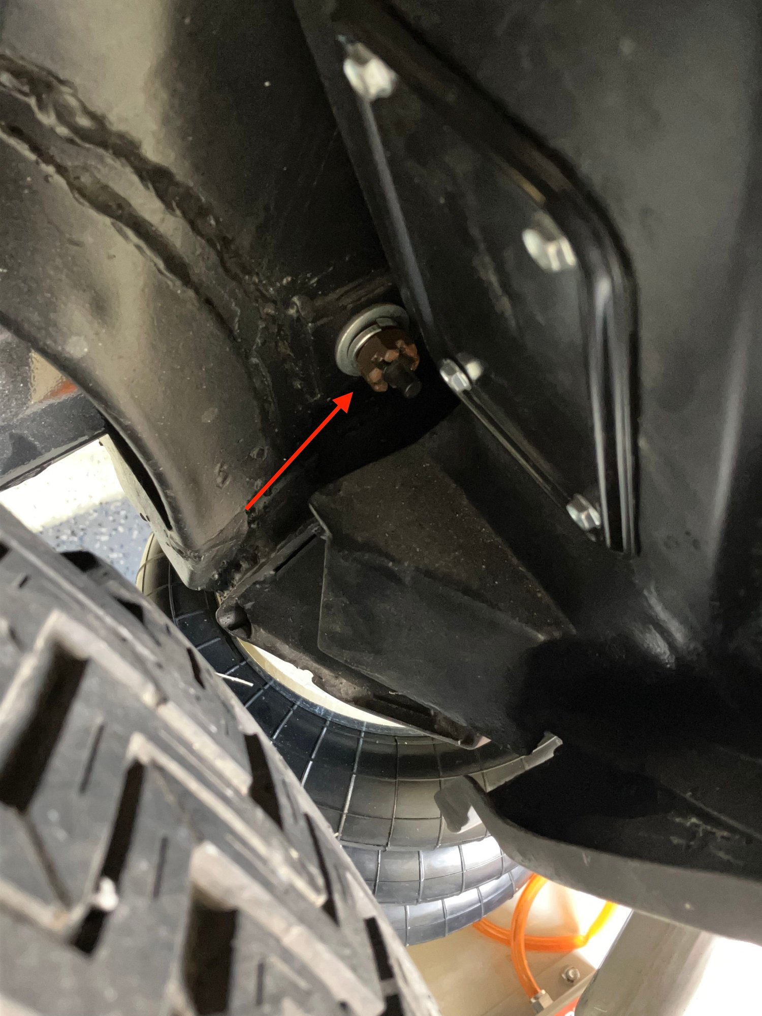

I noticed today there are no shims around the trailing arms inside the frame! BTW this is a project car I picked up last summer. My car was made in Dec. '68 so it doesn't have the cotter pin holes to help retain the slotted shims. I really want to use the slotted ones but I'd have to drill holes for the cotter pin. I'll find out next weekend if I can fit the drill in there.
