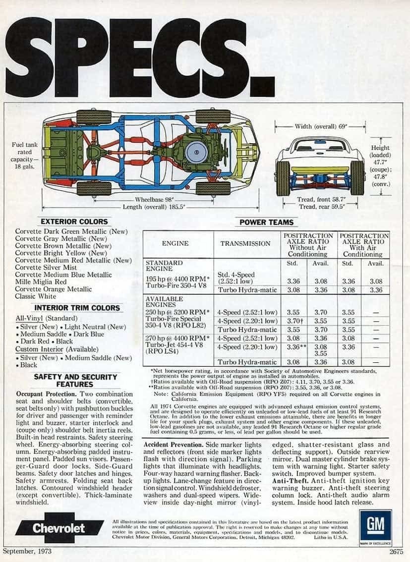

Go to gmheritagecenter,.com for the official ordering codes and manuals for any gm car including the corvette.
I just looked up the 1974 corvette engine codes and the base engine in the 1974 corvette documents is offically referred to as THE L-48:!
​​​​​​CORVETTE POWER TEAMS Engine, Transmission and Positraction Rear Axle Combinations (Engine hvpewr ratinye ara reflected ar"t" horsepower) POSITRACTIONN REAR AXLE RATIOS Without Ai Conditioning With Air Conditionina ENGINE TRANSMISSION Option Number Description Type (Std or Optional) Optienal Std Std Econ Perf Spес STANDARD ENGINE Standard EightCylinder Engine Ordering Code L48 Turbo-Fire 350-4/DE 8-Cylinder 350-cи-1n displacement 4-barrel carburetor Hydraulic valve lfters 8.5:1 compression ratio Dual exbaust Optional Ecen Perf Spe 4-Speed Wide Range (Std) -M20 3.36 3.08 3.36 3.08 Turbe Hydre-matic-M40 3.08 - 3.36 - 3.08 - 3.36

Same thing, but right out the manual
To '72 hp
