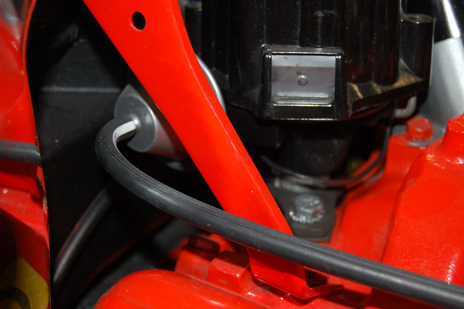

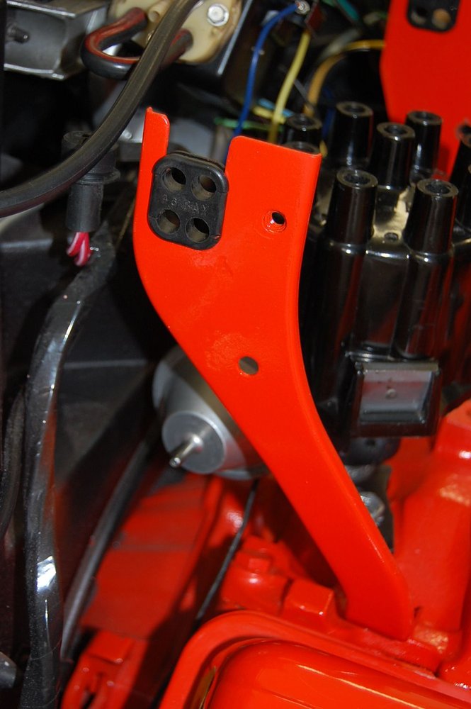

Hello,
Here are a couple of photos showing the distributor 'clock' that MW describes and the illustration indicates.
It allows the vacuum advance can to clear the spark plug wire support.
It also puts the tach cable connection in a good position so the cable doesn't develop a 'kink'.
Regards,,,,,,,

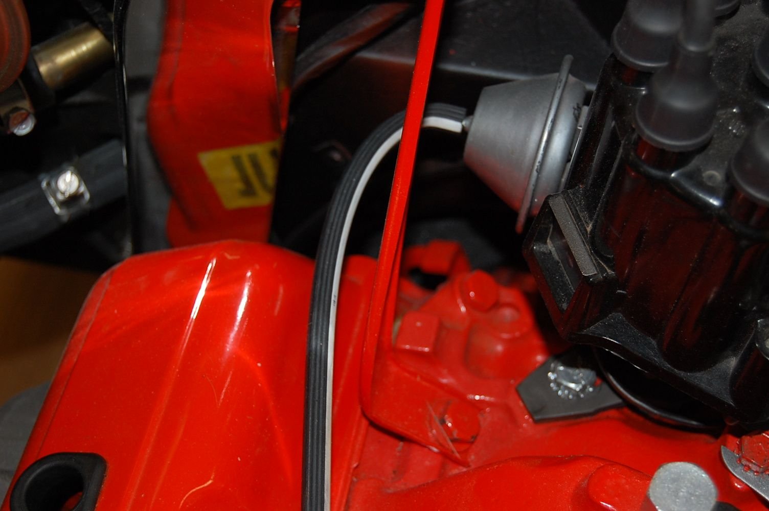

Hello,
This is the typical position for the connection for the tach cable.
Note gentle curve.
Is your's similar?
Regards....
