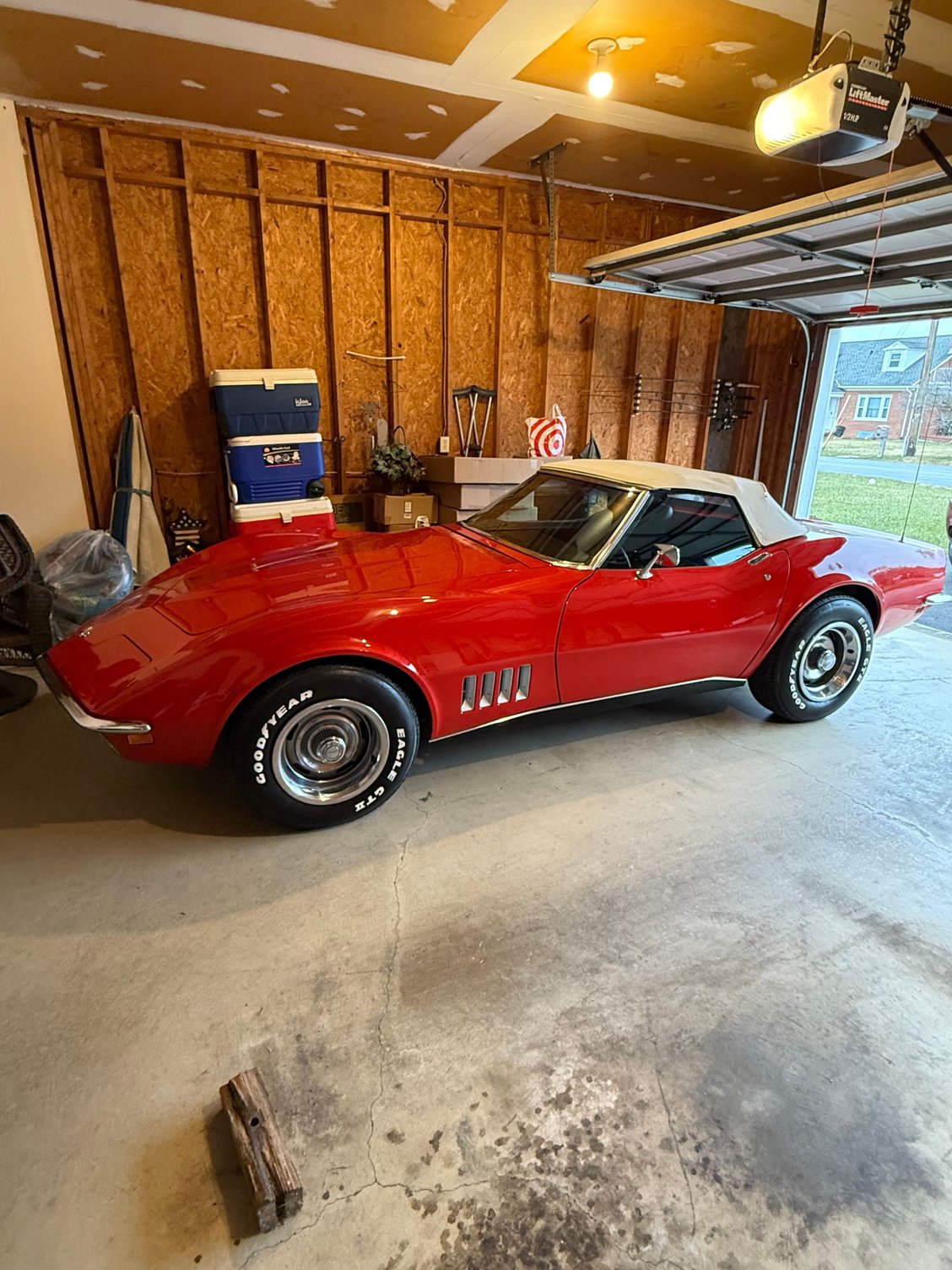

Ladies and Gents, I’m running 225/70r15 right now and getting new ones soon. I want wider tires without altering the profile. How big can I go on an 15x8 rally wheel without spacers or rubbing issues.

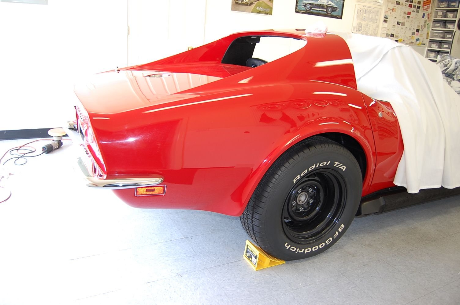

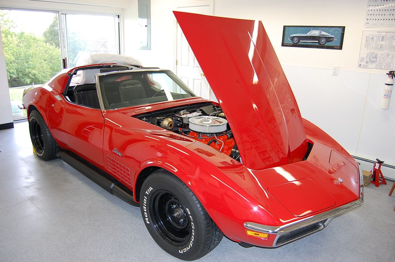

Hello BB69,
If your 69 is a bb the clearance issue might be at the front because of a little more weight on the front suspension.
255/60/15 on a sb car.
Regards......

Alan, Thanks. The car is sitting 29 inches from floor to top of fender well. Won`t a 60 series drop the car and increase the fender well gap. ?

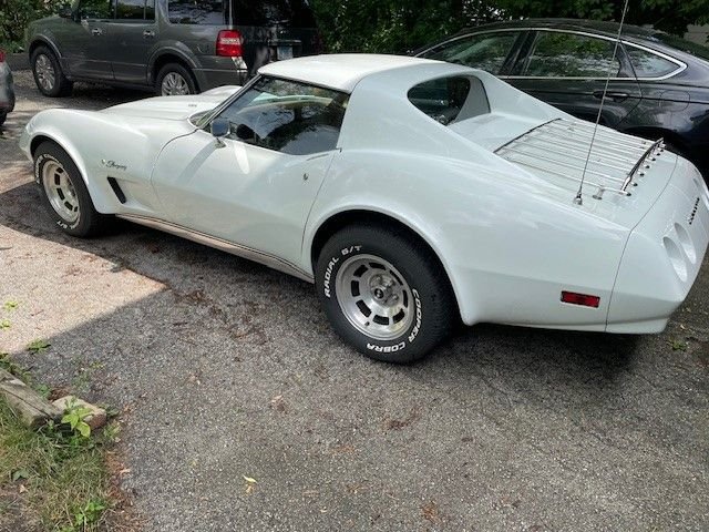

Cooper 255-60-15's
Got a good deal at mavis tire installed
