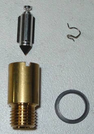

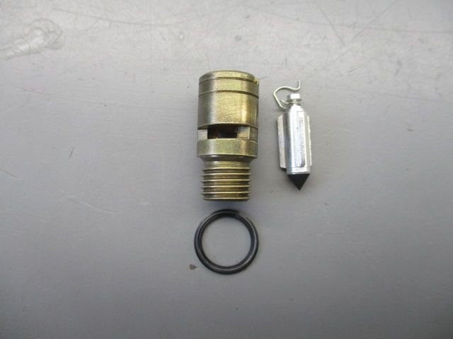

I'll bet you have the wrong seat in the carb - check it, and install the correct seat. Make sure float level is set to .300"
Wrong seat: Seat with side windows and undersized .110" diameter inlet orifice:
Correct seat: Solid cylinder with no side windows and .135" inlet orifice:

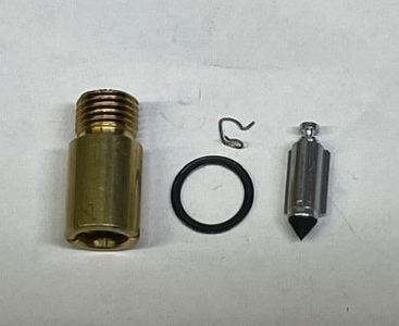

Order this matched set, the picture shows the clip
Needle Seat
