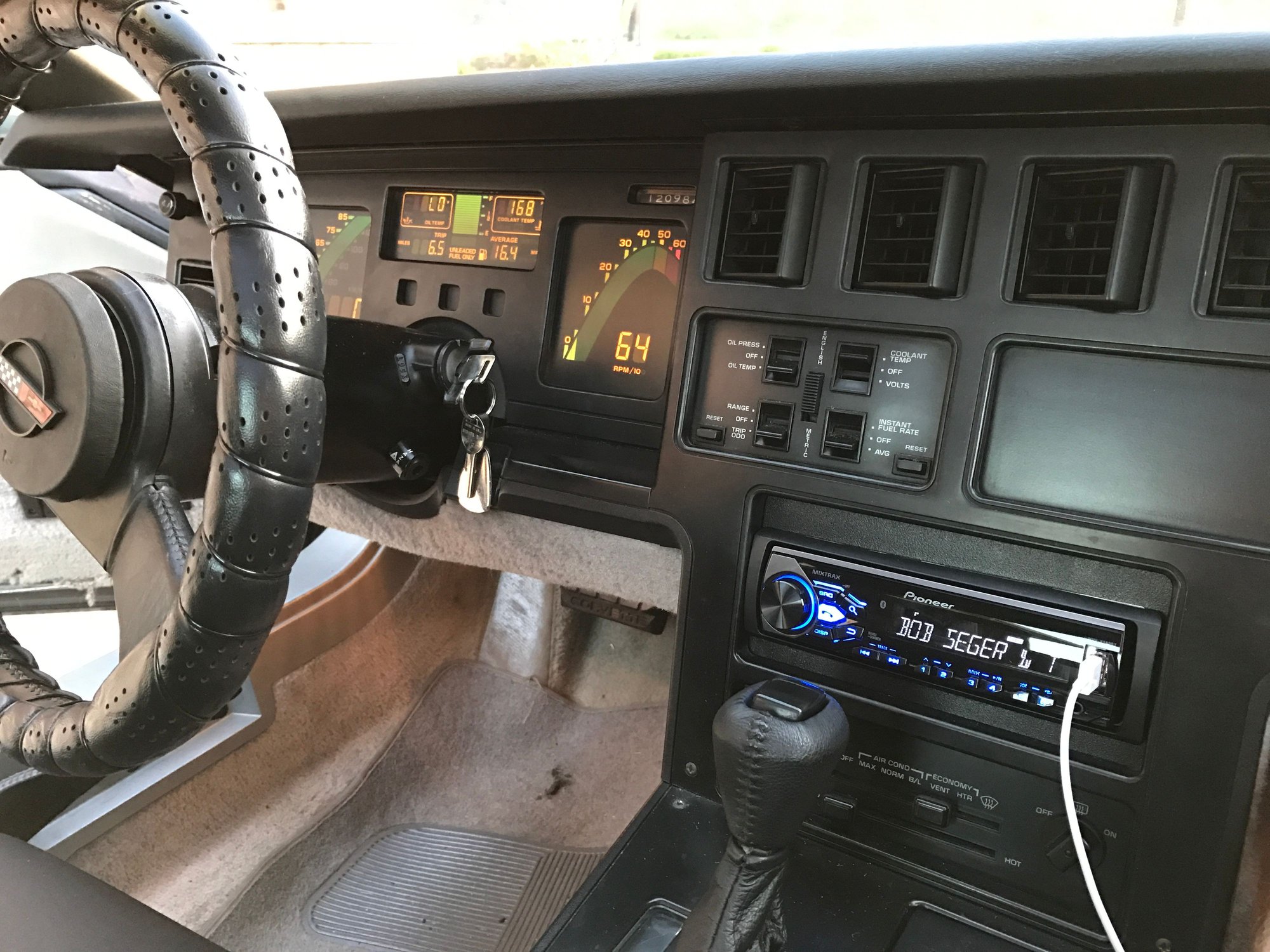

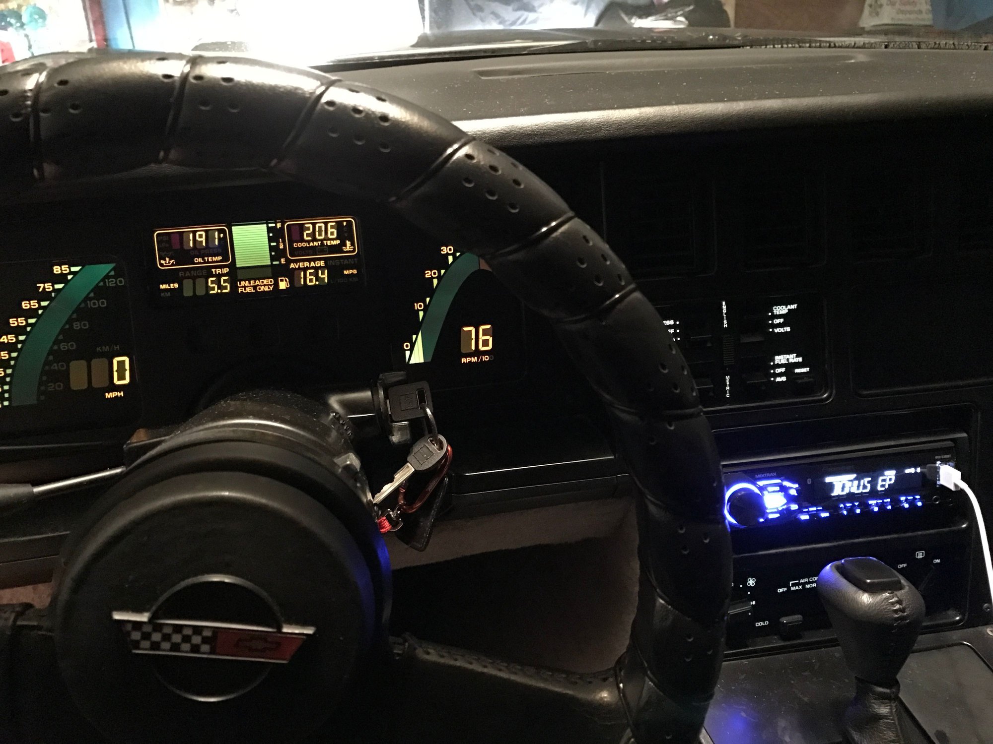

Since the last update there has been a few updates to the car. First, it now has about 121,000 miles on it so its definitely being driven. Its running a little bit better after turning on the TPS and lowering the idle from where it was. Its been on a short road trip from Cincinnati to a little North of Dayton and really did well. Theres a bunch of wind noise even though the weatherstripping is new, so theres a little diagnosing there that needs to happen but nothing to worry about now. On the trip it ran well the whole time and stayed cool, which was a nice relief. One of the bigger updates is the new radio installed. Its a Pioneer from Crutchfield with the rest of their kit which includes the front plate and adapter and the install went well. I have also taken it to Cincinnati Cars and Coffee twice, and a few people really liked the car, especially the color and digital dashboard. Now for the pictures:
