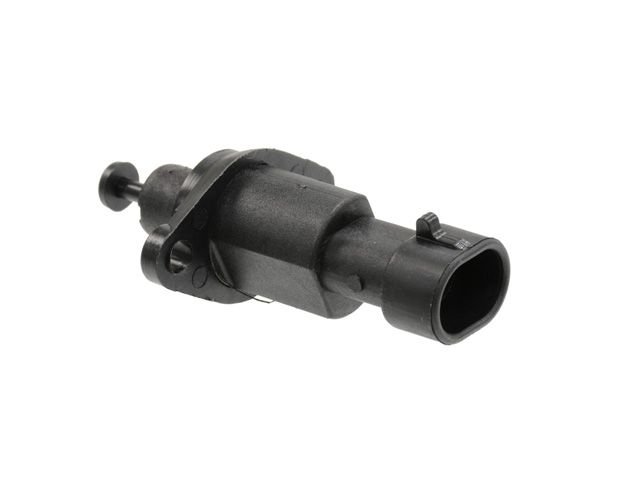

Is the connection from the switch to the wiring a standard connection or a GM/ Corvette proprietary connection? I was just thinking with the switch not being an exact replacement someone may have had to monkey about with the connector?

It should be a GM type connector. I don't think GM uses any standard stuff. If your harness is messed up, you might be able to get one from the salvage guys in the parts for sale section of the C4 group.

Your switch should look like this...
This shows the connector side.
