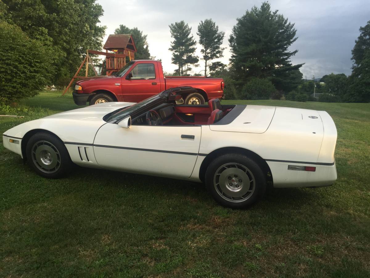

I just bought a 1986 convertible with 73Kmiles on it, it sat for two years after the owner passed away and the widow knew I had been wanting a Corvette for a very long time and she offered it to me. I replaced the two rear hubs, bearings, all filters, fuel sensor abd the gal is great and runs like a scalded dog!!!!!!!!!!!!!No issues until yesterday,went to store and the passenger side headlight wouldn't open, headlight burns but no go on opening..... Now with all the experts here on the forum can some one guide me in the process to repair the issue,step one to completion is great...........got all winter so no hurry getting it ready for garage now....Thanks, Steve

If the motor is spinning but not moving the lights, you just need to replace the pellets in the motor. It is a pretty easy fix, I would do both sides, as the other is probably on the way out as well. BTW, your front wheels are on the wrong sides.

Look at the fronts compared to the rears, the vanes should point forward like they do on the rear wheels. Corvette guys can be **** that way, I'm surprised nobody pointed it out before.

Just swap the fronts from left to right.

I never looked at the vanes before you mentioned it,now I am all bent out of shape....lol.....Actually no one at the cruise ins or the local Vette club ever mentioned the wheels.....Now I have a neat little thing to do when it goes in the garage for the winter, jack her up and change wheels...... still got to work on the headlight issue.... thought it might be a relay but I will do your suggestion first....being a Corvette novice and first time owner I am starting new, thanks to everyone at the Forum.
