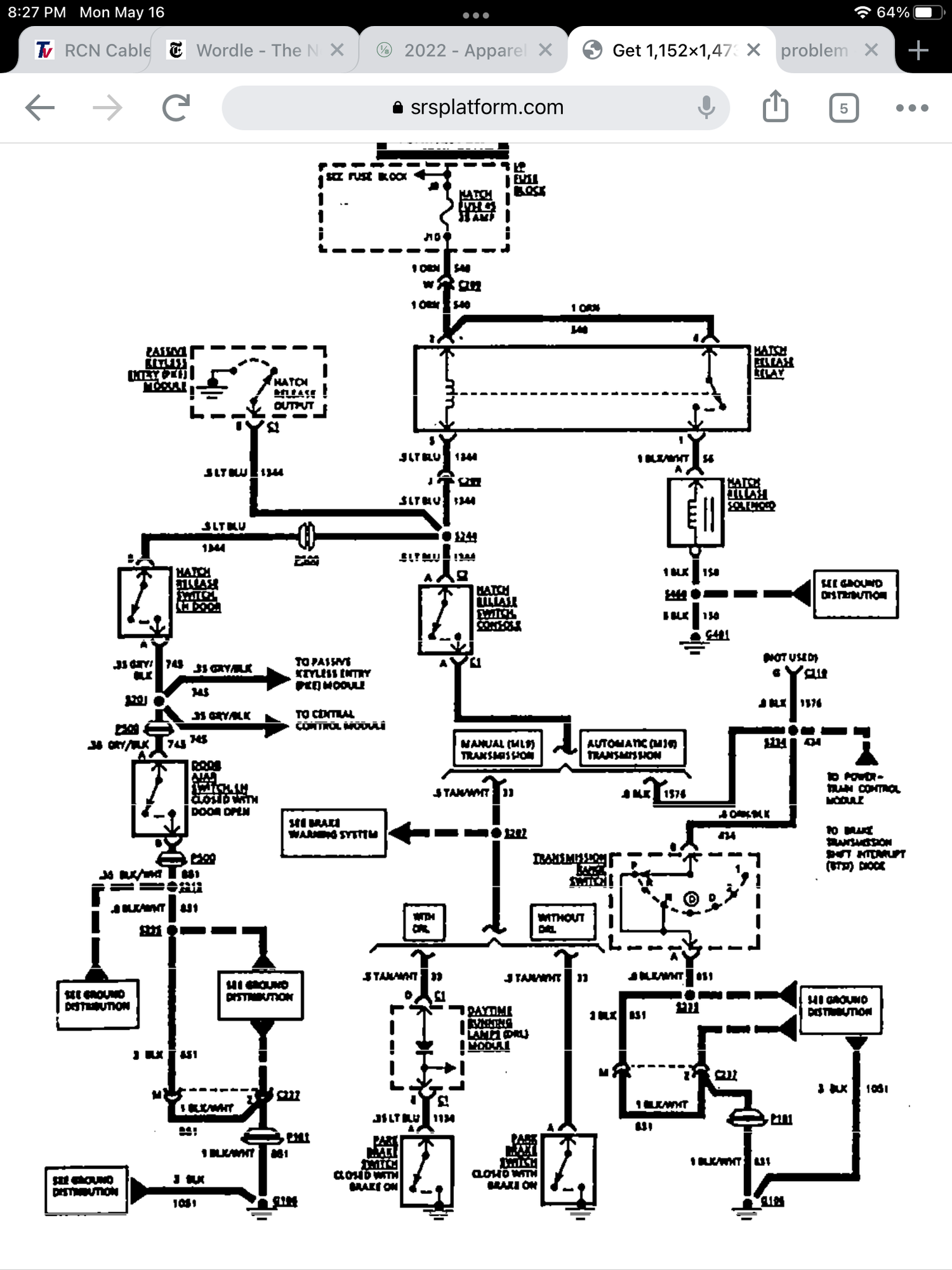

Here’s the wiring diagram

Originally Posted by ihatebarkingdogs
Door release only works with the door open.
If you have a 6-speed 96, have you ever actually tried the console button with the brake off?
Look at the wiring diagram. Please tell me how the console button can operate without the park brake set? (Or an automatic in P or N.)
Engine on, off, has nothing to do with the console button.
If you have a 6-speed,have you actually tried the console button with the brake off?
You look at the wiring diagram too. The console button can not function without the park brake applied, or the automatic in P or N.
This comes up frequently.. The cars are wired as shown in the diagram. But every time it comes up, there are peeps that say that's not how their car works. Go try it. Then please be humble enough to admit that you were mistaken, once you see that the park brake has to be applied for the CONSOLE button to work. (Not the door switch(s)). Or P or N for an automatic.
Absolutely… My car in the garage is just in gear, no parking brake. I can pop the hatch with either switch no issue…. I just did it, right now. However, this is a 93…
Tried it before my first post in this thread.
From the owners manual,
If you have a manual transmission, you must set the parking brake before you can use the switch when the vehicle is running.
The humble pie is all yours. Enjoy. ​​​​​​​

My ‘96 works just as depicted in the wiring diagram (A4)
