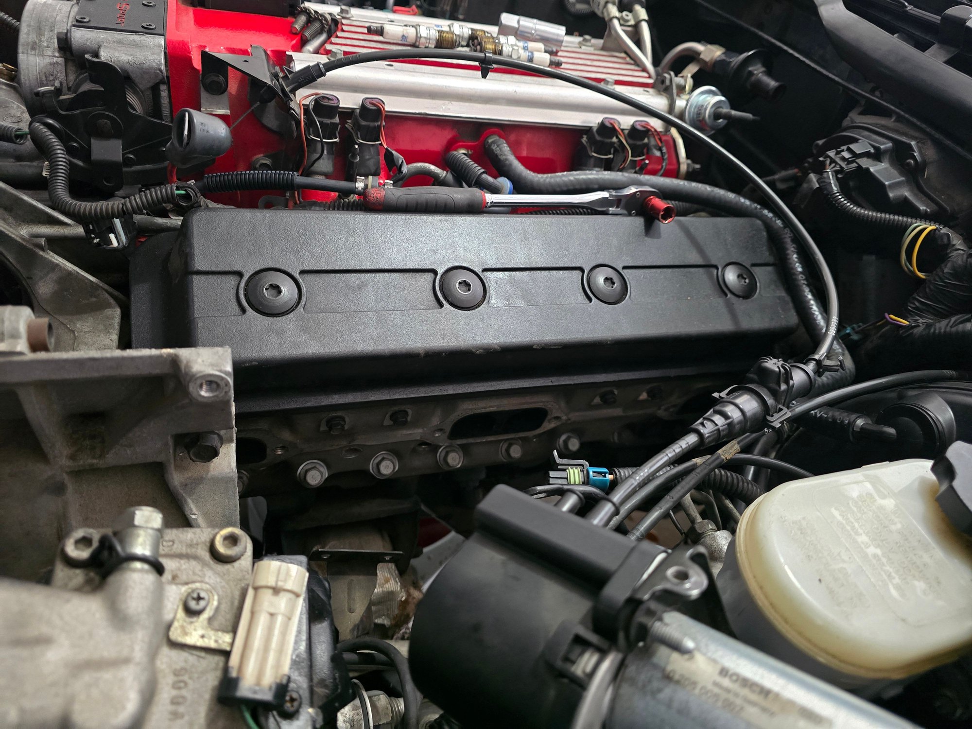

More slow progress.
Plugs are out
All but 1 passenger side manifold bolts are loose/out.
I found cylinder 8 manifold bolts easier to get to under the car.

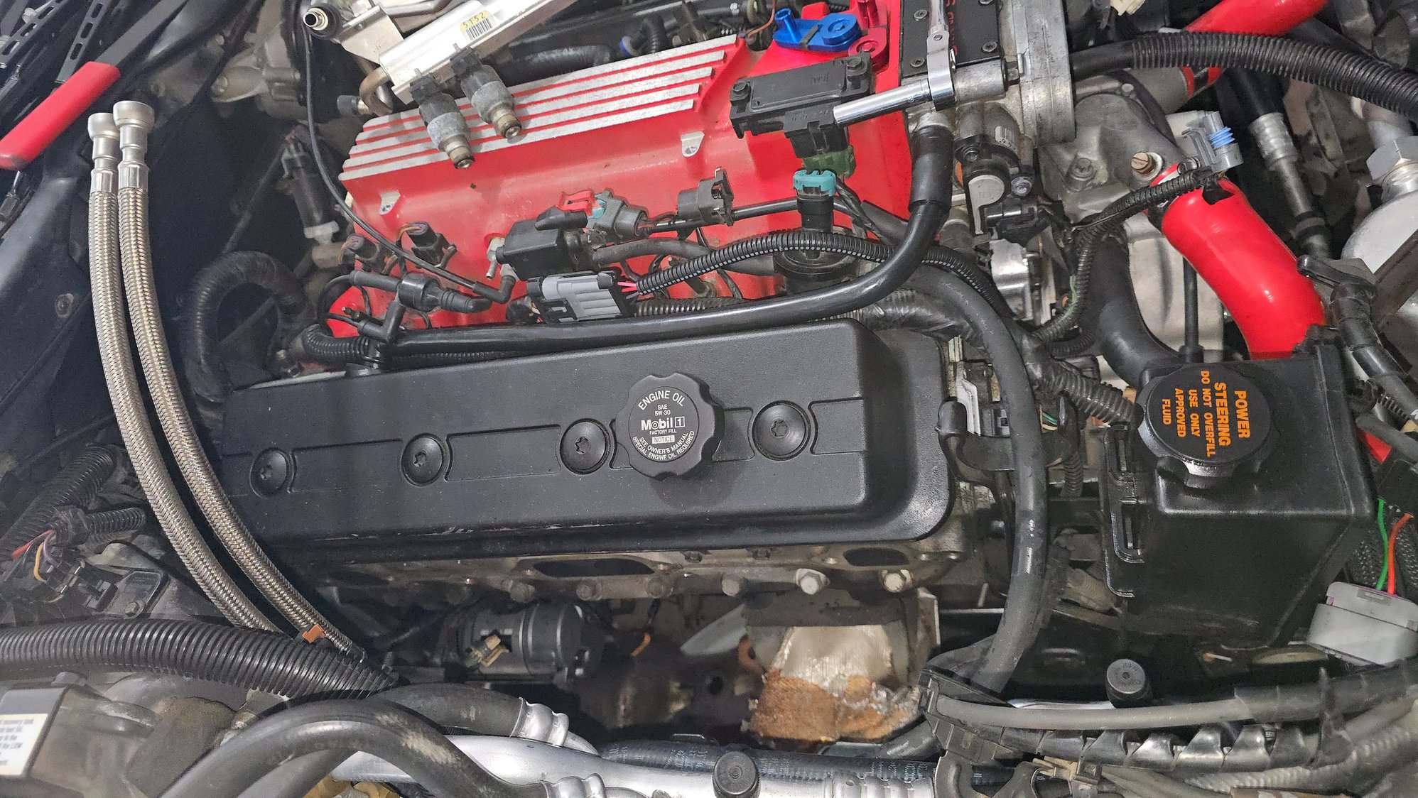

How do we remove the oil dipstick? I had to force it out of the way. Hopefully that wasn't a mistake.
Old Jan 9, 2026 | 03:55 PM
FAUEE's Avatar
FAUEE
Joined: Oct 2012
Posts: 17,383
Likes: 6,527
From: Melbourne, FL
Bolt (well, stud and nut really) on the manifold, then twist and pull. It's just kinda wedged in there with an o-ring.
You're gonna want to take it off, lol. Ask me how I know...

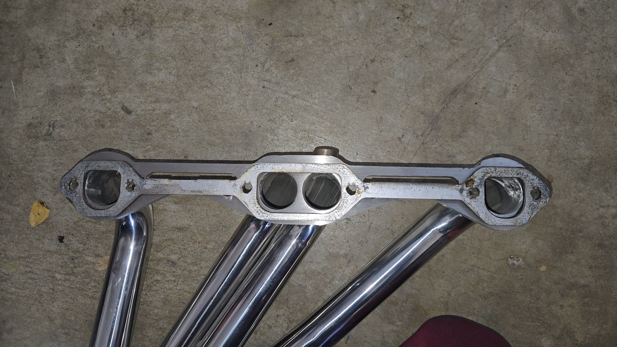

Both manifolds off. Novice questions. Should I buy new oem gaskets and see how well it lines up with the obx LT's?
And of course, I won't reuse old gaskets.

I bought copper gaskets, I am less impressed with them than I was the MLS gaskets for my TBSS. The LS motor community says to trash the fiber style gaskets more headers come with (they have a thin foil puter layer that's perforated and black fiber cores). So imagine my surprise when I took my factory manifolds off to find exactly that. The OEM gaskets on my TBSS were several pieces of thin steel laminated together to make a great sealing gasket (I used the other gasket underneath it to ensure plenty of thickness for a good seal -the flanges on headers are often not perfectly flat and are sometimes slanted, so extra thickness is good).
The copper gaskets are decent. Two thicket layers of copper foil sandwiching a fiber core. I couldn't find any laminated steel gaskets like my Delco gaskets for the TBSS. So i stuck with the copper ones.
I really don't want to have to redo the gaskets once everything is installed lol. Getting the headers into position with the full exhaust system on them still sounds like a nightmare to replace the gaskets.
Side note, it's nice having a headers install buddy, lol. I'm like a couple hours of progress ahead of you, lol.
