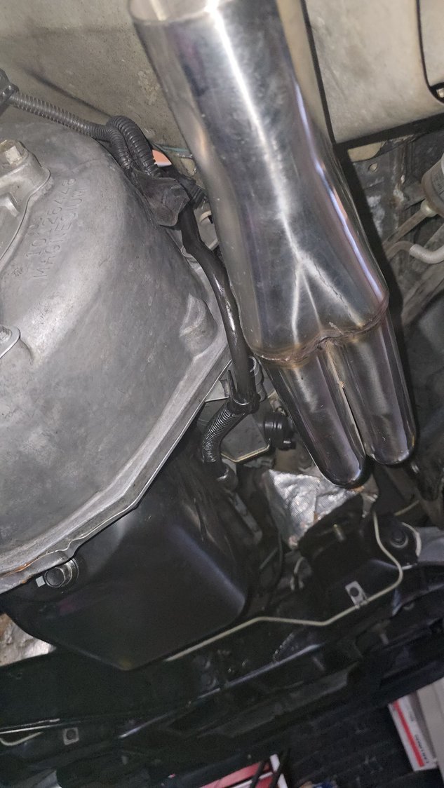

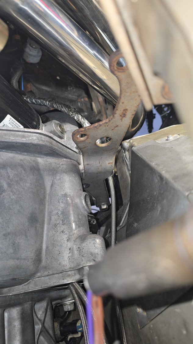

Just so I'm sure, these brackets we don't reuse with longtubes?
Old Jan 19, 2026 | 03:29 PM
  #42
FAUEE's Avatar
FAUEE
Joined: Oct 2012
Posts: 17,386
Likes: 6,527
From: Melbourne, FL
You probably COULD, but there's likely no reason and you probably won't have any pipes near there to attach to them anyways.

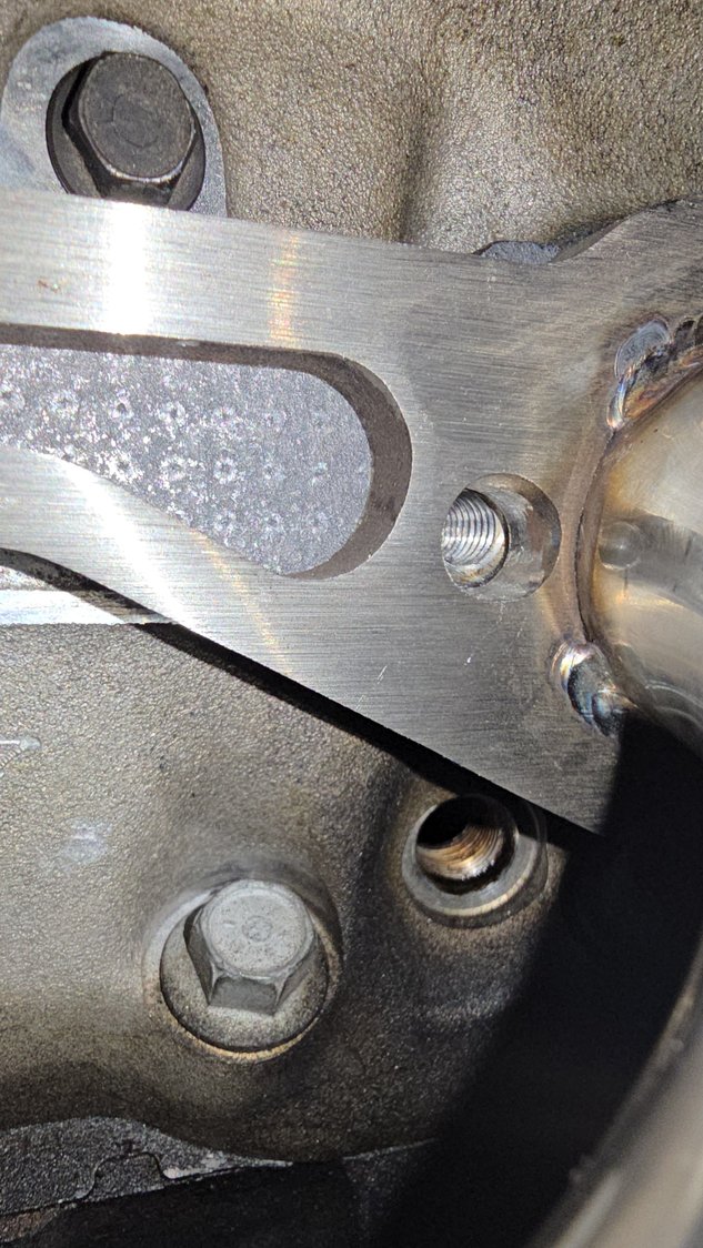

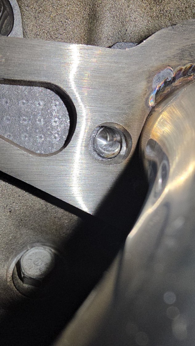

It seems like the head on these allen bolts are too wide to clear the header tubes in some spots. Do i need to buy different header bolts?
Also, to open up the header bolt holes, can I use a drill or is something else needed?
Old Jan 27, 2026 | 09:15 AM
  #45
FAUEE's Avatar
FAUEE
Joined: Oct 2012
Posts: 17,386
Likes: 6,527
From: Melbourne, FL
Looks to me like that bolt isn't in straight.
One thing I found helped a lot was getting the bolts started but not in anywhere near all the way. It helped getting them all started without them hitting the primaries.
You can use a drill to open the header bolt holes up, but I wouldn't. It'll be impossible to get the primaries centered over the exhaust ports if they can shift around some.
I had to push or pull on the headers to get the bolts started. Once the headers get a few heat cycles on them they'll reform a little bit and got better (which is why you have to go back in and tighten them all again after a few weeks).

These are the header bolts that I used. Link
For the holes, I used the round file by hand and took my time to open up the holes.
Old Jan 27, 2026 | 06:04 PM
  #47
RWDsmoke's Avatar
RWDsmoke
Joined: Jan 2005
Posts: 1,354
Likes: 325
From: San Antonio Tx
Mine are all slotted slightly except the end holes. As long as you don't drill out the holes on the ends those bolts will keep the ports lined up. Start all the bolts with the header pulled away from the head as far as possible and tighten the bolts that are closest to the tubes first.

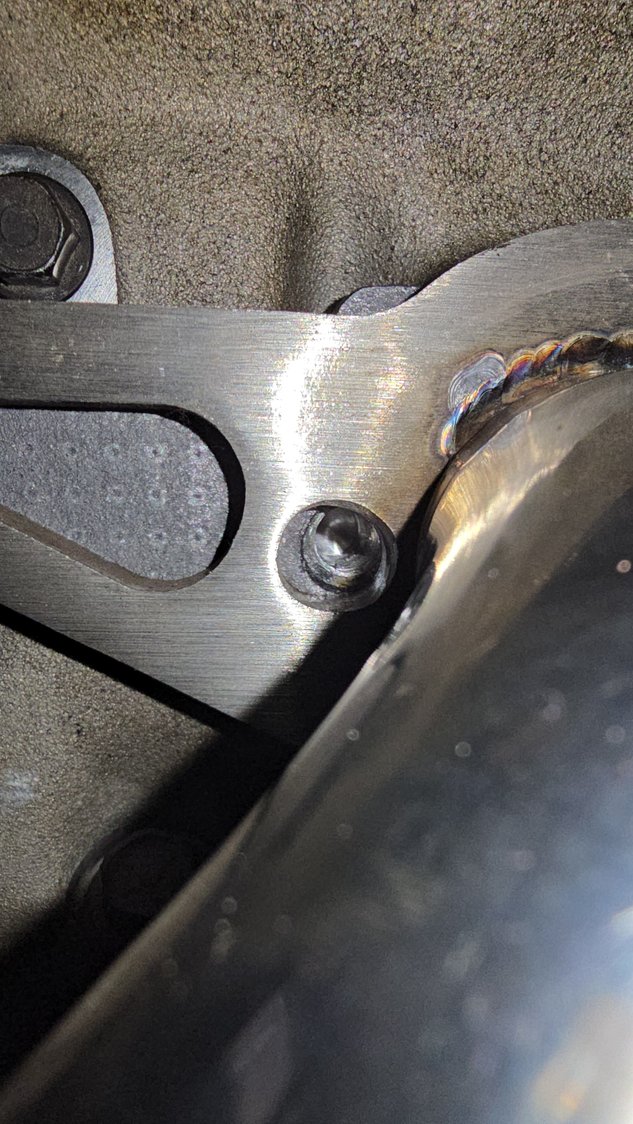

I'm guessing I have to dent the tube where the bolt is crooked? All other bolts went in good.
Old Feb 3, 2026 | 04:00 PM
  #51
1993C4LT1's Avatar
1993C4LT1
Joined: Oct 2011
Posts: 16,092
Likes: 819
From: Dallas Texas
And or will I have to open the bolt hole on the header? Not much room to open it more with the primary right beside it.
Old Feb 3, 2026 | 04:25 PM
  #52
FAUEE's Avatar
FAUEE
Joined: Oct 2012
Posts: 17,386
Likes: 6,527
From: Melbourne, FL
Is the header on tight? Or loose? Does it fit if the header isn't bolted up at all?
If it won't fit with it loose, yeah, you're looking at clearancing that pipe. I don't think you should need to open up any holes personally.
Old Feb 3, 2026 | 05:46 PM
  #53
1993C4LT1's Avatar
1993C4LT1
Joined: Oct 2011
Posts: 16,092
Likes: 819
From: Dallas Texas
Tight. It won't fit loose, either.
Old Feb 3, 2026 | 08:15 PM
  #54
FAUEE's Avatar
FAUEE
Joined: Oct 2012
Posts: 17,386
Likes: 6,527
From: Melbourne, FL
Guess you're gonna have to clearance that primary then. That sucks. It's gonna suck trying to torque it too.

Not a fan of how close it is to that black line. Which has wiring inside of it. None of these bolts want to go in straight. It seems the bolt heads are too wide, or I need to dent, basically all of the driver side primary tubes. What a pain.

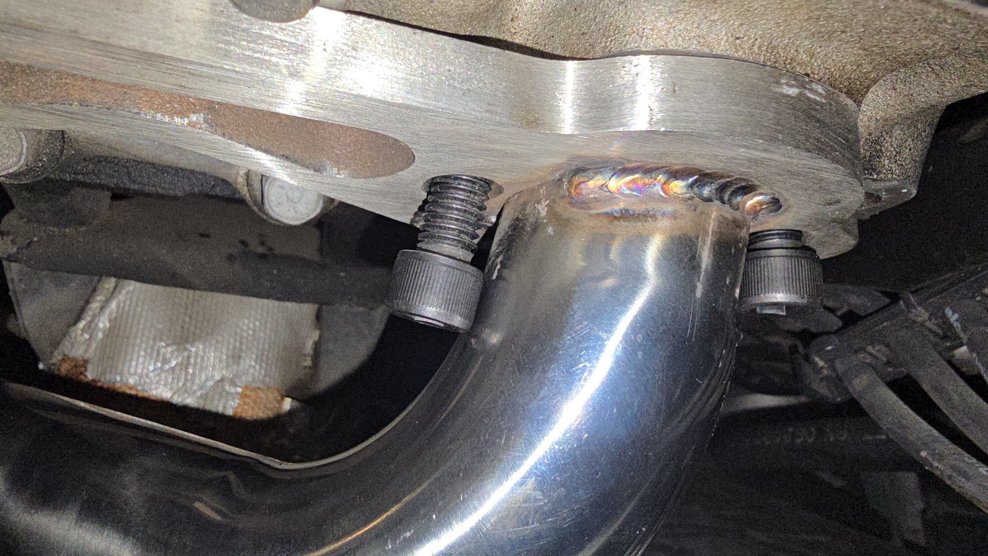

Are we supposed to use the washers that come with the arp bolts? I noticed if I put the washers on, the bolts won't go on.
Old Feb 17, 2026 | 08:40 PM
  #59
FAUEE's Avatar
FAUEE
Joined: Oct 2012
Posts: 17,386
Likes: 6,527
From: Melbourne, FL
Always use washers. Not sure why, something about clamping force or something that a mechanical engineer could explain better, but yeah you want to use the washers
Hang it on a middle bolt, loosely. Then try to work from the outside in on bolts, again all loosely until you get them all threaded in. Sometimes you'll have to do the 2nd one from the outside first and pry on the headers to get it to line up. Once they're all actually grabbing, them you can start getting them tight. The flanges are not gonna be perfectly flat and straight until they've heat cycles a few times and relaxed. Worth noting, you're gonna have to come back and retighten these bolts a few time once they're all on.
