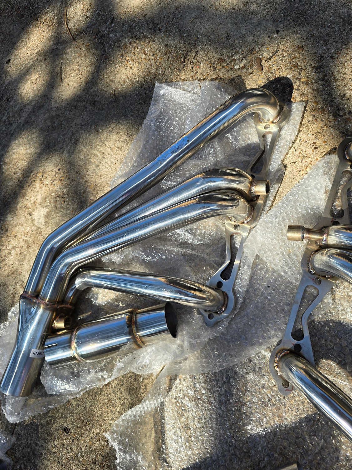

Old Jan 3, 2026 | 04:52 PM
1993C4LT1's Avatar
1993C4LT1
Joined: Oct 2011
Posts: 16,093
Likes: 820
From: Dallas Texas
Old Jan 3, 2026 | 04:54 PM
1993C4LT1's Avatar
1993C4LT1
Joined: Oct 2011
Posts: 16,093
Likes: 820
From: Dallas Texas
Dirty garage, but it's my garage
Anyways, car is up in the air. I can get it higher, should I need to.
