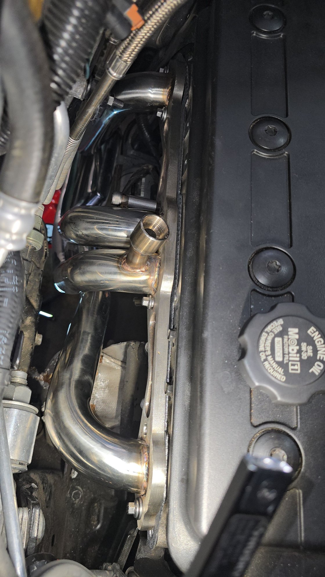

Same problem. If I start the bolt on cylinder 2 first, none of the bolts on cylinder 8 line up. If I start the other bolts first, cylimder bolt goes in sideways. I guess I have to open the bolt hole up

I had to lean on the headers to get some of the bolts lined up. Like push up or down on the primaries hard to get the bolts started and in. I found it easiest to hang off the middle bolt, then start the rear bolts, then push on the front primaries to get those in. I was lucky in that my front primaries needed to go down and not up to line up nicely. That meant I could just lean on them while starting the bolts. Pulling up on them would have been way more of a pain in the butt.
