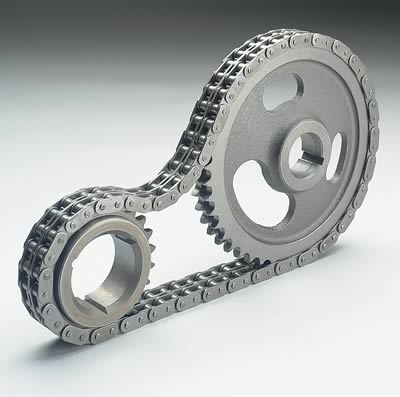

This is the one I was told to buy
I haven't bought it yet, but getting ready to soon. Anyone have any experience with this one from Summit?
Cloyes CLO-C-3039
http://store.summitracing.com/largeimage.asp?part=CLO-C-3039&Prod=Cloyes+Heavy%2DDuty+Timing+Set s&img=clo-c-3039_w.jpg
Cloyes CLO-C-3039
That looks like an LT set.
Old Oct 19, 2007 | 11:42 PM
biggrizzly's Avatar
biggrizzly
Joined: Jun 2002
Posts: 2,705
Likes: 30
From: Chesapeake Beach Maryland
2015 C5 of Year Finalist
Its supposed to be a heavy duty stock replacement - non-roller
Old Oct 19, 2007 | 11:44 PM
jsup's Avatar
jsup
Posts: 35,065
From: Bergen County, NJ Democrats, doing for the country what they did for Michigan
What's that big extra gear for in front? It has nothing to do with a chain.
