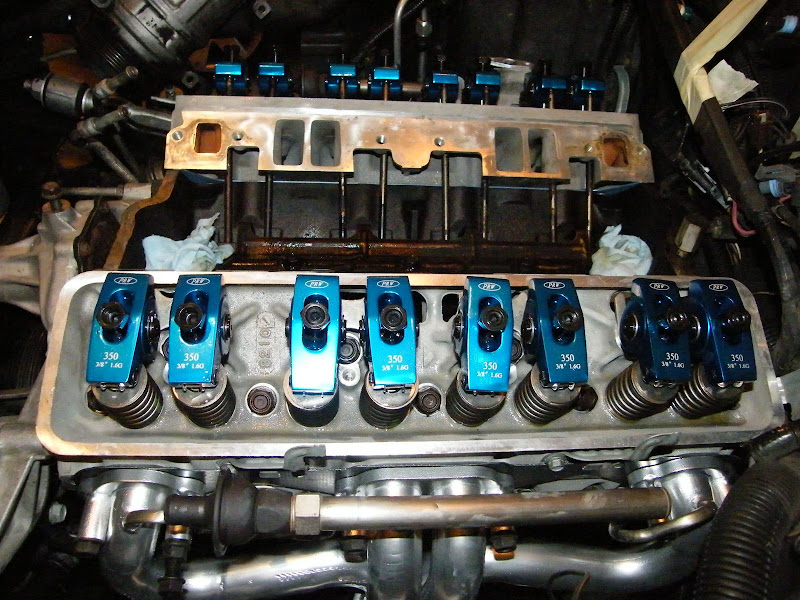

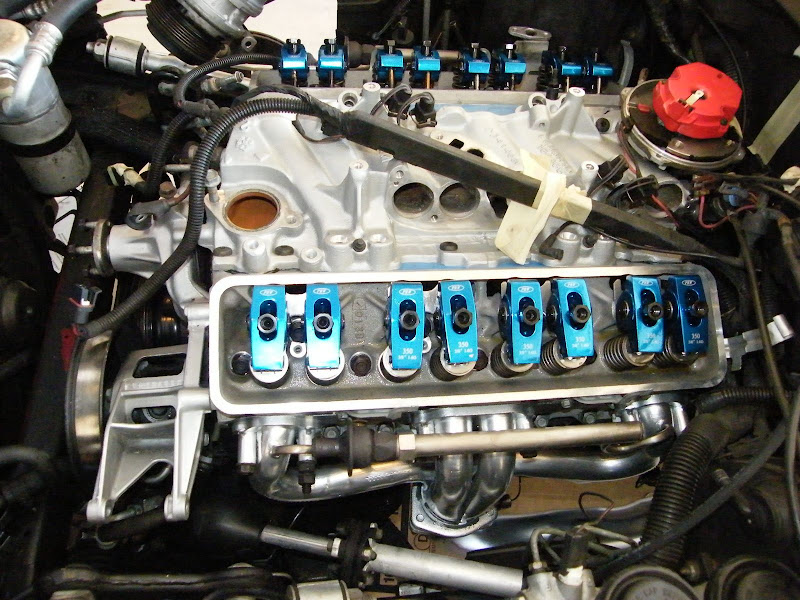

OK, making progress
Heads on, exhaust manifolds on loose, 2 1/2 Y-pipe on loose, and rockers in place not adjusted.

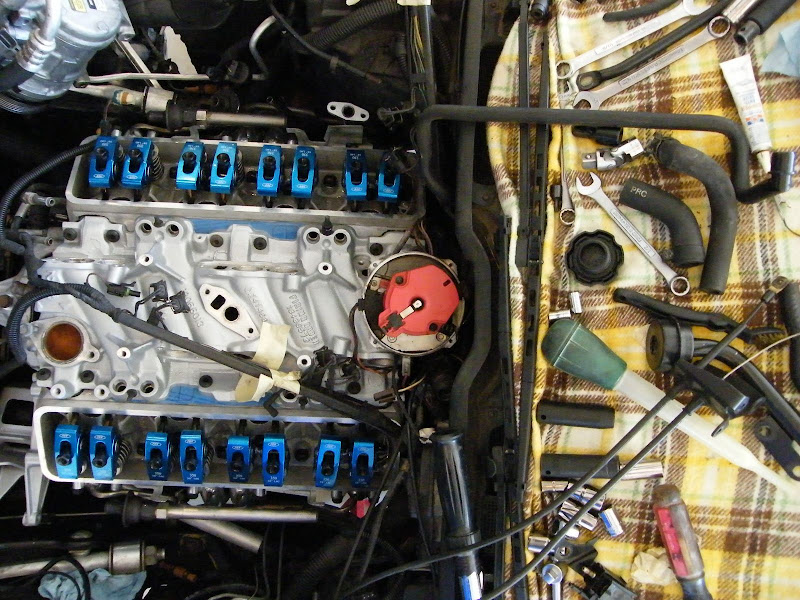

OK, got the plugs in some of the coolant hoses on the bottom and dropped on the intake, that went better than I thought it would not that bad a job.
I put the distributor in but I'n not 100% on the position, The engine is at TDC for #1 and it should be pointing between 5 and 6 o'clock looking at the motor from above.
Can anyone offer their opening from the picture if they thin this is right.
Is there any way to confirm that you are in the right slot of the distributor other than firing it up????

Remember that a four stroke is at TDC twice. You must be at TDC on the compression stroke. IE both valves closed.
I'm 99.9% sure I am at TDC of the compression stroke, I took special care to always rotate the motor two full turns and return it to TDC #1.
I'm just trying to make sure I've got the dizzy right!
thats where mine points for #1 ... just turn motor over till #1 intake valve starts to open. then by hand turn crankshaft clockwise till the timing mark lines up with "0" even if it's off the distributor can be pulled easily with everything together. Oh and make sure you connect that 4 wire EST connector before you put more together it was buried on my 90 and real hard to reconnect after it was all back together.

#1 on the dizzy is completely variable based on where you install the cap and put the #1 plug wire. It could be anywhere.
If the motor is at TDC #1 then install #1 where the rotor is pointing. If you want to have #1 somewhere else, pull out the dizzy, rotate the pointer and install again.
If you need to verify TDC there are tips mentioned here, but it sounds like you are sure of where it is.

I think I've got it right, I still had the cap with the wires to the driver side clinder attached. From that I could determine which wires were 1,3,5,7. So I put the cap on and put a mark at the bottom of the dizzy body right at the #1 post. Then I lined up on this. I think I may have been off one tooth in my previous install.
We'll find out when I fire it I guess!
