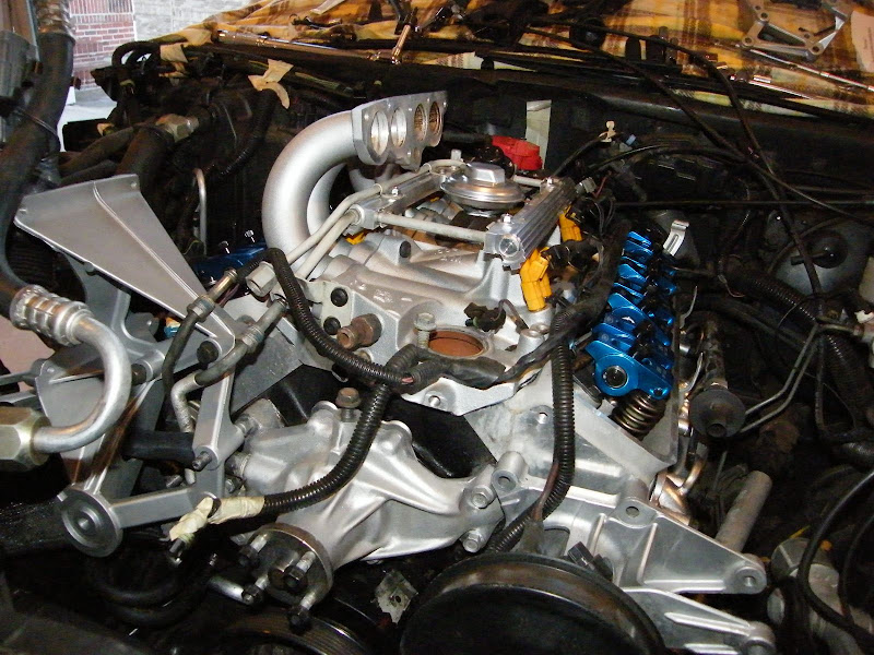

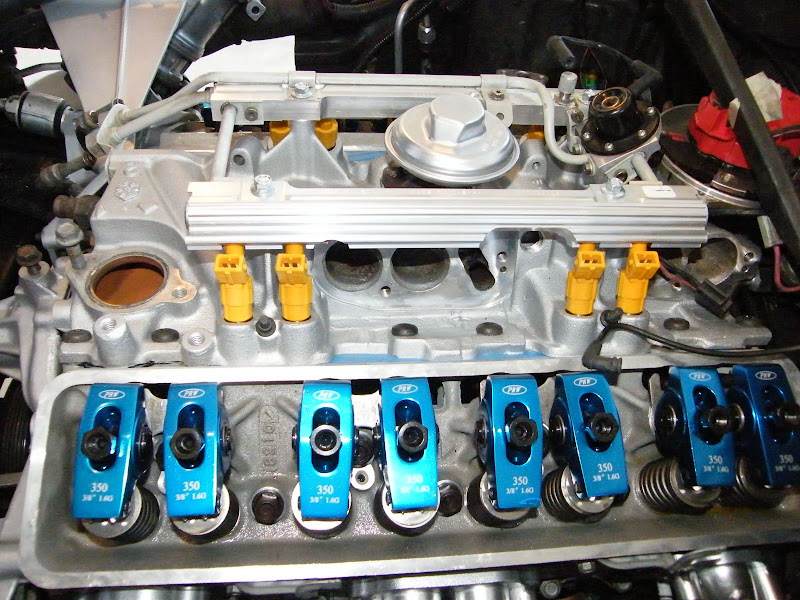

Back on track! The ACE hardware had the right items and at 44% off as they are moving!
Fuel Injection on! Starting to piece things together.
