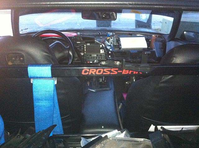

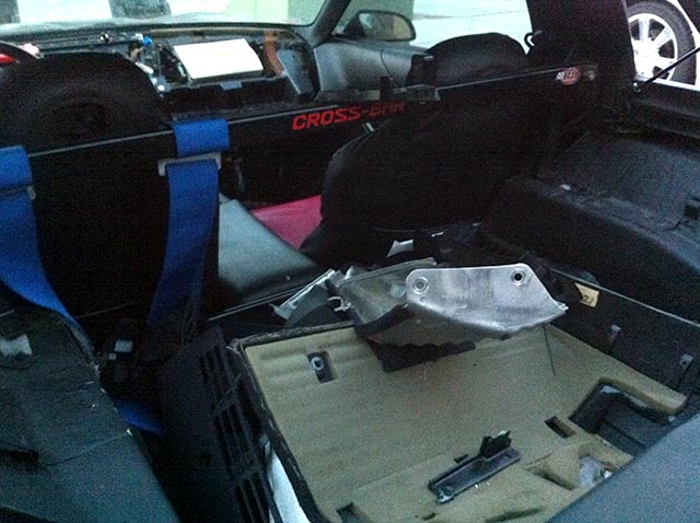

It got serious this weekend. Lower dash panels are out, as well as the dash pad. The CCM looks good to me and one of the wires I can ground out to make the deck turn off goes to the PKE module. So the PKE has been removed and will take it to an electronics shop to have them check it out. It freakin' looks brand new and nothing is obviously blown out, so we'll see.

Good time to fix all those little annoying squeaks and rattles as well. FWIW, the factory stuck felt and/or the fuzzy side of velcro between pieces of plastic and trim that would rub together. Some strategically placed zip ties help with wiring as well. Just remember that sometimes wires do need to move a little, so don't bundle things too tight.
Personally I'll be surprised if it's the PKE module or the CCM. I don't recall the PKE module having any interface whatsoever with the "run" circuit.
I feel your pain....electrical issues simply suck.

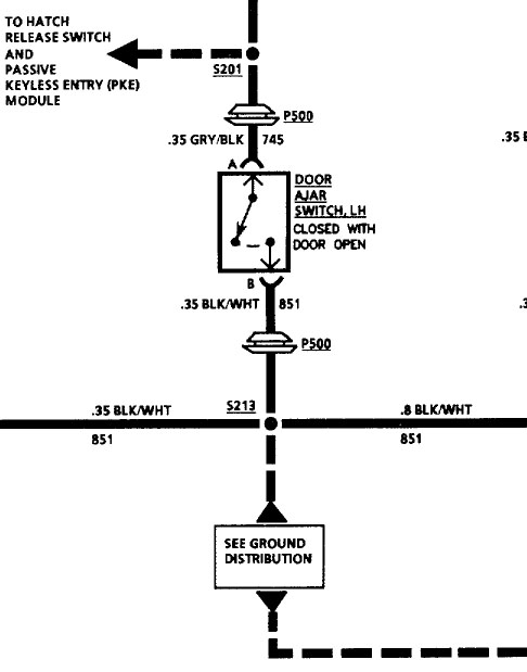

Well it looks like I need to find this Ground Distribution block (diagram for driver's door ajar switch to the CCM/PKE/ground).
Where/how the hell do I find that? Of course i'm still not sure if it's directly related to my no start condition, but after it wouldn't fire this morning, I was able to start her by clicking off and clicking back on the Alpine face plate. #makesnosensetome
I was able to replace the PKE module this week then finally able to reprogram my key fob last night...but it'll only pop the hatch and UNLOCK the passenger door. Nothing on the driver's door and won't lock the passenger door. Oh fun!
