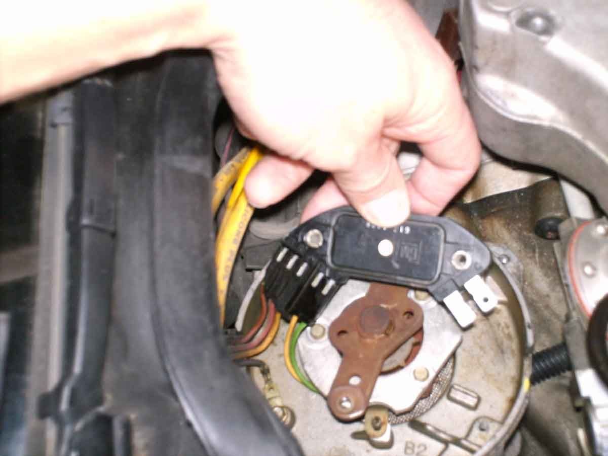

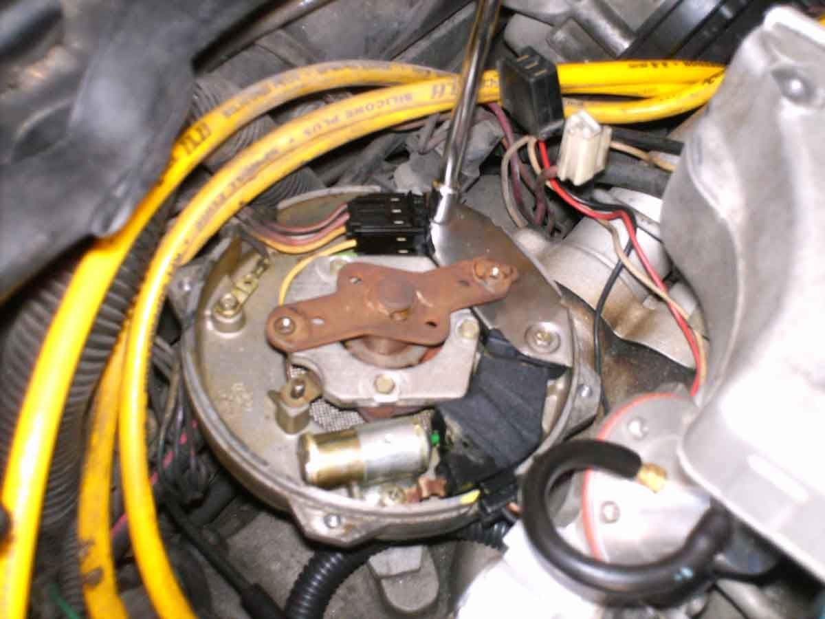

here some pics from my ignition module swap,but i changed the cap as a one piece unit

tune port great how to pictures, but what he really needs to see is the little steel tab that is under the coil
here is a link to little steel tab
http://www.bing.com/images/search?q=...ectedIndex=471
