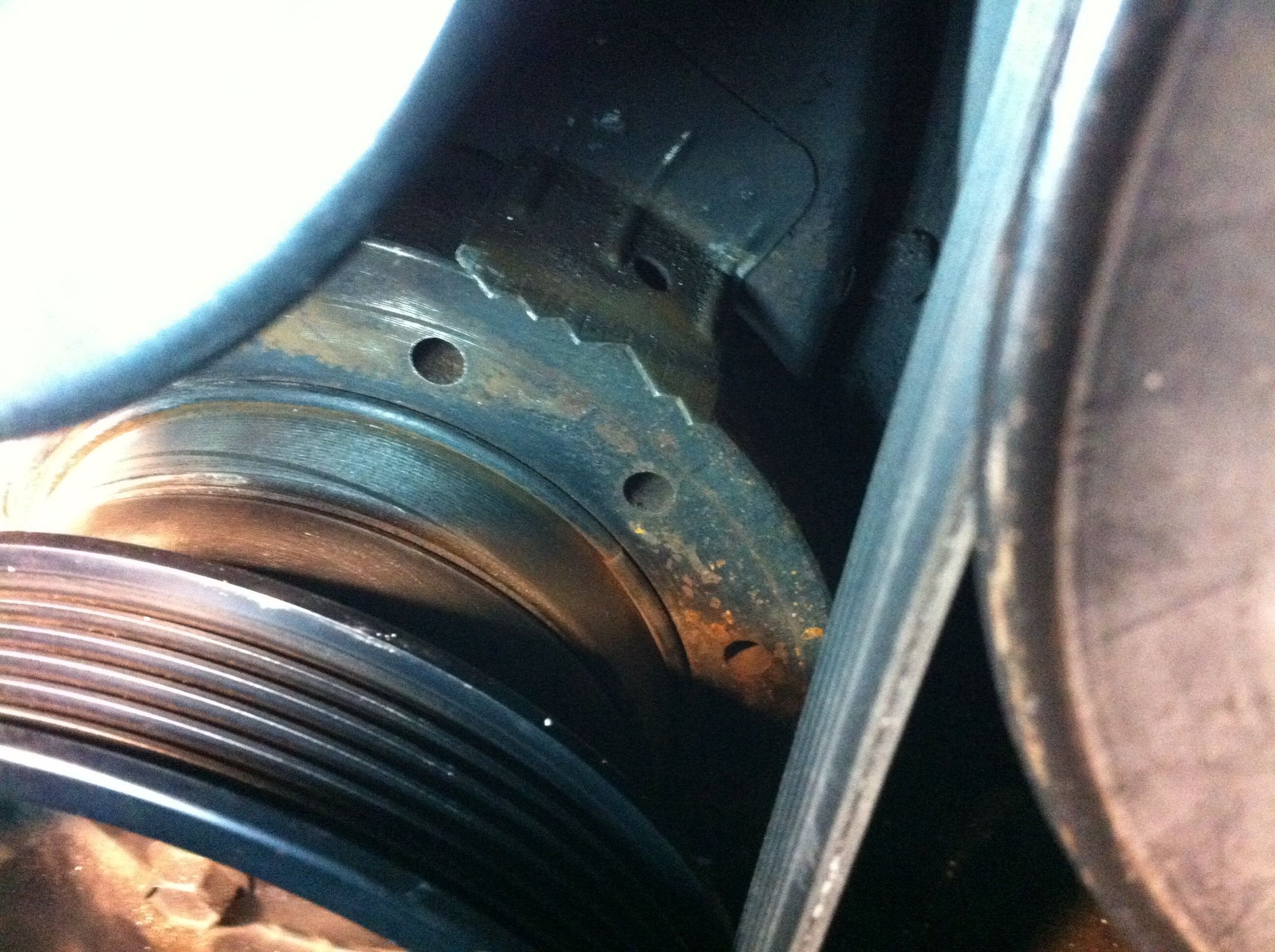

Timing mark. Yes I meant to say on the balancer. There is no perpendicular (front to back) groove. I sanded all the rust off and nothing. Just a diagonal line. Bizarre.

Timing. I did unplug the EST to check the timing. No line on balancer. Just that diagonal line that (coincidentally) crosses at 6 degrees.
Harmonic balancer. Not sure what previous owner night have done... But there are no timing marks. I checked the whole way around. Maybe I should get a new balancer in order to be able to time the car properly.

I think I figured out why I could find no timing notch
Seems to be the wrong balancer or installed backwards.
Bizarre. At least I found the timing notch now.

NO...your balancer is SHOT and NEEDING TO BE REPLACED!!!!!!!! I am surprised if the balancer outer ring.....which has slid back....has not rubber a hole in your timing chain cover. I have serviced MANY balancers that look just like this one. MAKE NO MISTAKE ABOUT IT....GET A NEW BALANCER. So shopping for one is IMPERATIVE!!!!!
Glad that you posted these photos. No I see what you were seeing. AND...that you actually employ advice and suggestions that people give you. I am glad that you blew out your drain tube at your fuel boot. Keep an eye on it from time to time.

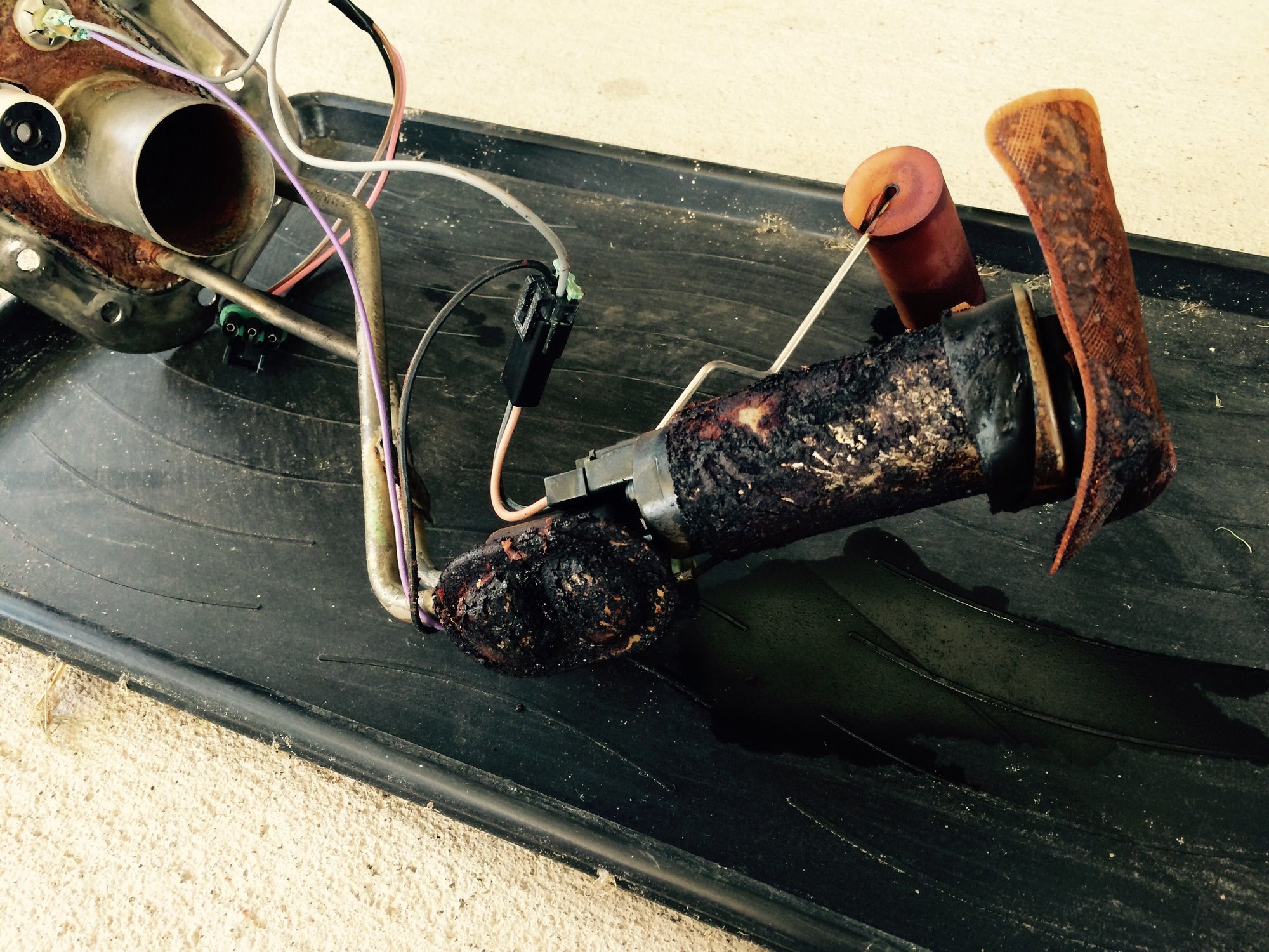

Took the fuel pump/sending unit out:
WTF? Note the rust and black gritty crap all over the place

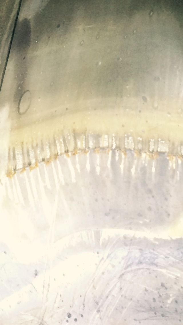

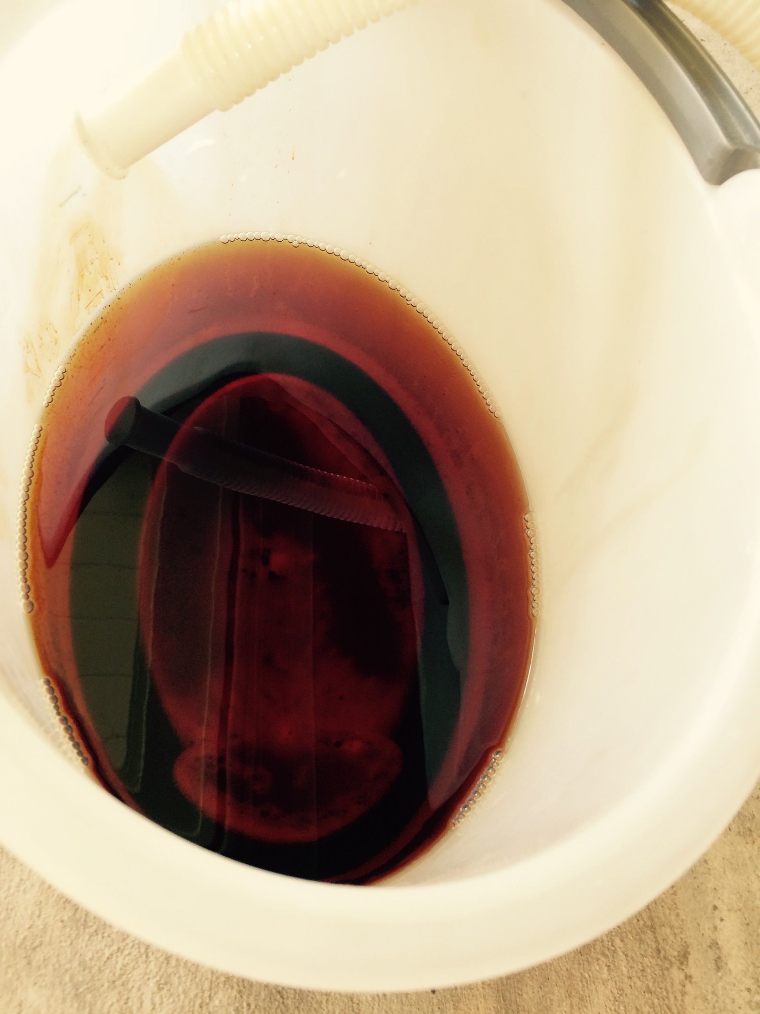

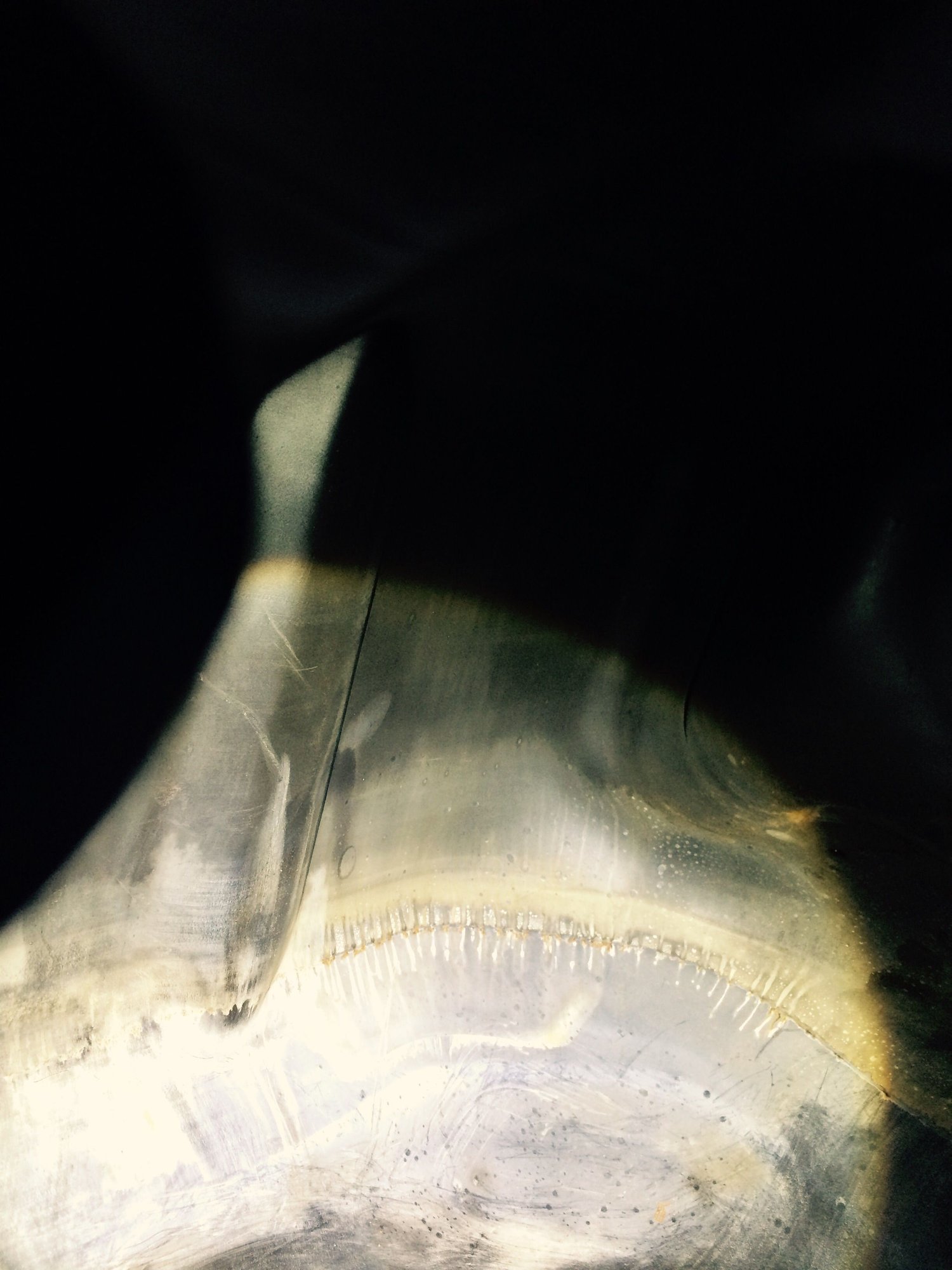

Peeked in the gas tank. Uh-oh. Not good. Siphoned out 2 gallons from the tank into this bucket...
So...
2 things... (1) I need to figure out how this happened, to prevent it from happening again,
and (2) clean the tank, lines. I'm hoping the fuel filter caught any crap from entering the fuel rails or injectors...
Cleaning the tank... the right way to do this would be to remove the tank and clean it that way... but removing the tank out of a C4 looks like a real b!tch... so I'm going to see how clean I can get the tank with it still being in the car.
Any thoughts/suggestions/ideas are appreciated.

Progress report. Cleaned out the tank and fuel lines.
The tank had sludge, rusty grit, and other floaties in it. Using carb cleaner, I think I got the tank back to an acceptable state.
Except:
The [what appears to be a] seam between the top and bottom halves... It looks like it has rust.
How worried should I be about this?
To 86 missing, running rich.
Old Aug 13, 2015 | 10:21 PM
antfarmer2's Avatar
antfarmer2
Joined: Mar 2015
Posts: 15,926
Likes: 579
Looks good pull the filter and blow the lines out and a new filter.
Old Aug 14, 2015 | 12:26 AM
HlhnEast's Avatar
HlhnEast
Joined: Nov 2008
Posts: 4,328
Likes: 15
From: Jacksonville FL
Wow, Ive never seen that much gunk in a gas tank before and I have revived several vehicles after years of sitting. One had been thru several floods and wasnt that bad.
The tank look fine, dont worry about that little bit of rust. Blow out your fuel lines, install a new pump, sock, and filter. Go get some Chevron gas if available or buy some Techron/Techroline from AZ or WallyWorld. It will take care of what little gunk may be left and clean up your injectors. That will cover the fueling side.
Make sure all the basic electrical measurements are good. Minimum idle, TPS, IAC count, and timing. Fuel good +electrical good=running car. If it runs badly again, take it to a parts house and get them to scan it for you. You can also "rent" them to check them out to help you decide what you like. I cheaped out and got a clearance price on a really good OBD1 scanner whos name escapes me but it was made by Hughes Electronics. It has the capability to take a "snapshot" of diagnostics which helps if you experience a problem at a certain rpm range.
Good luck and keep us posted.
