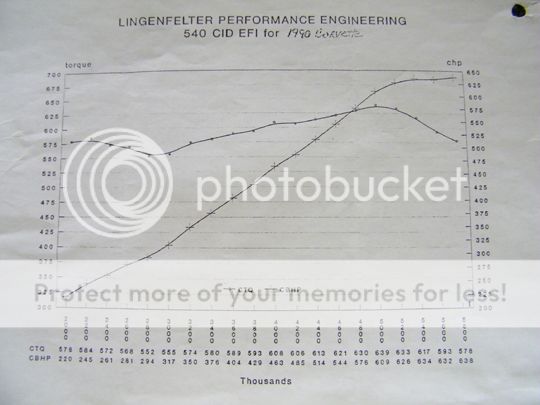

It's my dads car (1990). Yes, LPE did the conversion. They did 4 or 5 of these big block 540 cubic inch conversions back in the early 90's. The aluminum intake must have been custom built for LPE because I have never seen one like it. Car uses the stock hood. I have a stock 90 and I really don't notice the extra weight of the big block.
