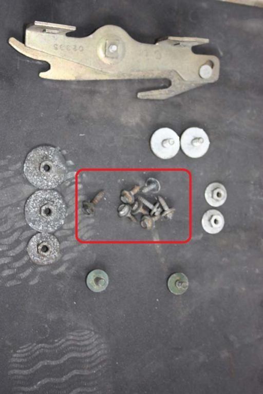

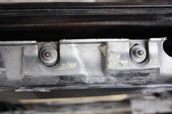

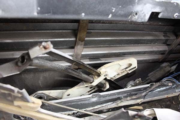

This car is legit pissing me off. 2 books and they're no help. amazing. they both say it comes out the top and I'm doing nothing but getting frustrating and chipping my paint. it says NOTHING NOTHING NOTHING about taking out the metal shield and that looks like the only way to do this. nor does it say anything about removing the motor and that's one of the things that is stopping it from coming out the top.

the metal shield has to come out. on a late C4 there are four (4) bolts holding the regulator /motor assembly in the door. you need the glass about 1/2 way in the up-down position to get the regulator assembly out. I'm going to send you a PM...

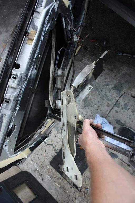

Amazing. I just had Joe C stop over and give me a hand. There was no possible way for me to do it like that. the regulator is too wide for the door opening.

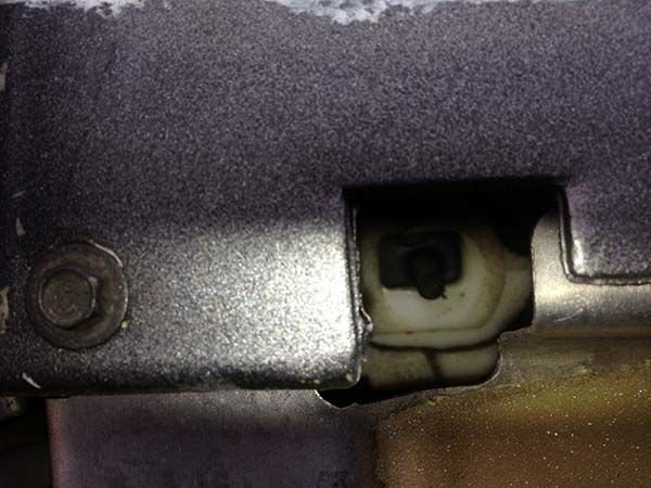

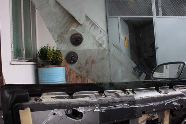

this is a new regulator/motor assembly that went in
Old Apr 29, 2015 | 06:54 AM
tunedport85inject's Avatar
tunedport85inject
Joined: Aug 2010
Posts: 1,704
Likes: 8
Old Apr 29, 2015 | 09:16 AM
Hairy W Bush's Avatar
Hairy W Bush
Joined: May 2014
Posts: 237
From: Florida
that's an older model but I had to do the same thing. neither haynes nor the FSM tell you to do that.
