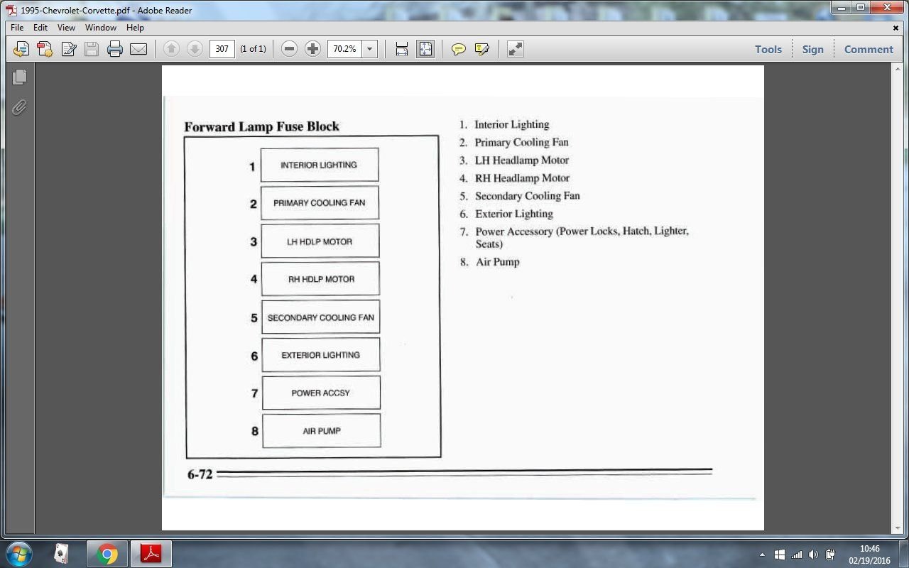

If you're sure you got a good connection when you tried the motor on the other side, this may not apply, but this is in the under hood fuse block:
Couldn't hurt to check. Can you tell me where I'd find that fuse block? Have not worked on the car in a while, and my memory is a bit foggy. Thanks!
