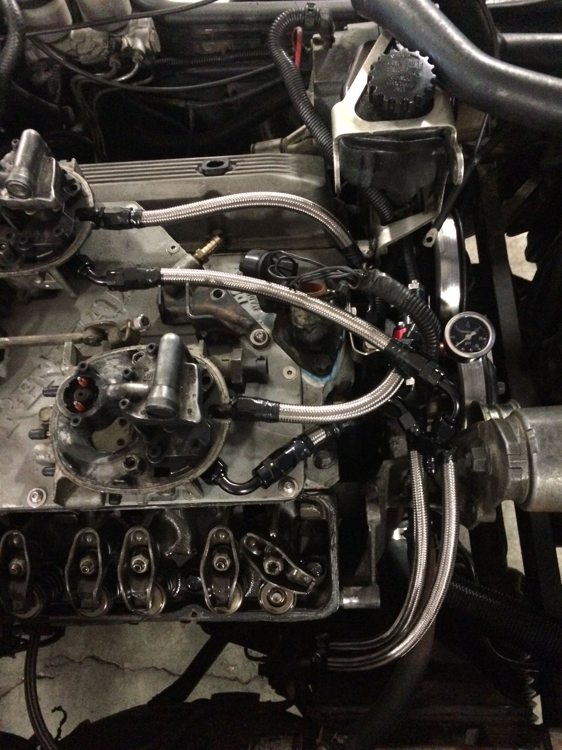

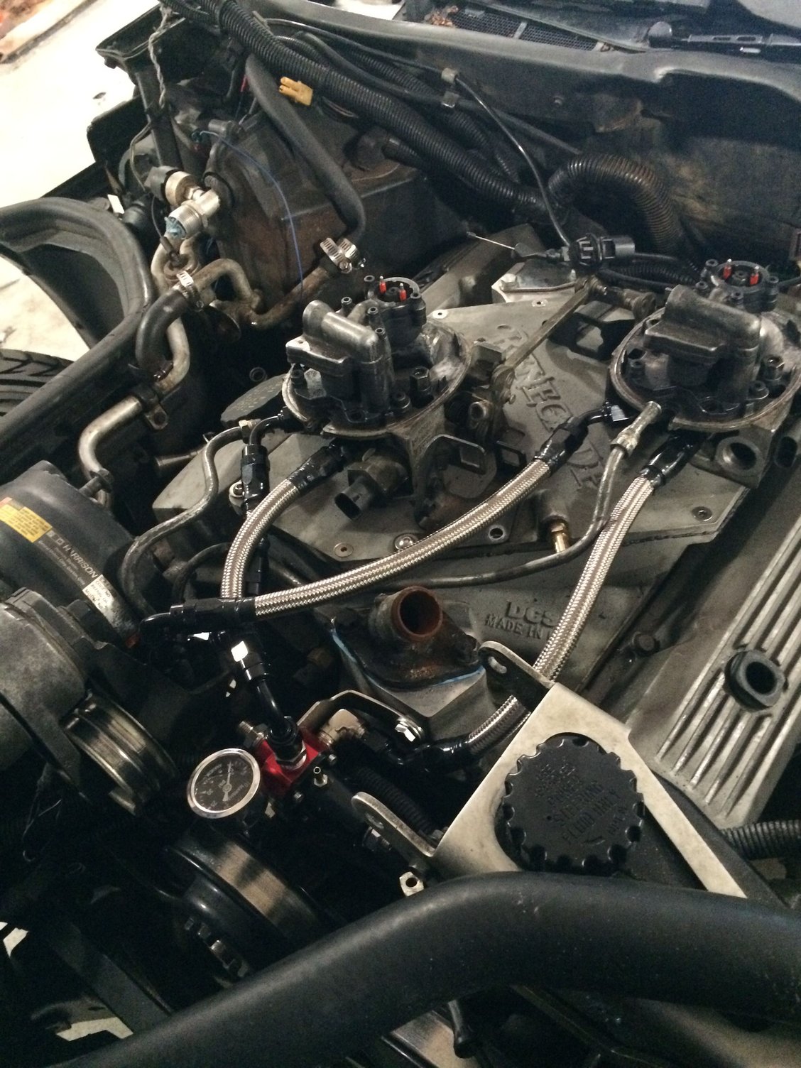

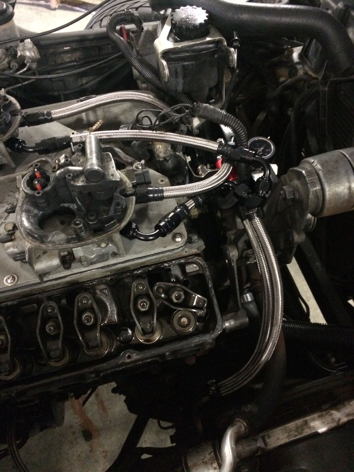

In the interest of helping the OP make an informed decision abut the direction he takes his fuel solution, I'll share this: I shelled out ~$550 on beefing up my fuel system, which includes setting up parallel plumbing. Sounds expensive, but bear with me.
The total includes 2x 80# big block injectors, a TPI pump, gasket kits for both TBs, blockoffs for the stock regulator & accumulator, the Aeromotive regulator, about 5' out of a 6' line of stainless braided fuel hose (for looks, not pressure ), a pressure gage, and a host of hose ends & adapter bits.
It sounds like the cost may be prohibitive for what the OP is hoping to accomplish...but once the pump & injectors are accounted for (he'll be buying them anyway) and a cheaper GM "marine" VRFPR is employed, the added expense to go parallel drops closer to $300. Less if he stays basic with hose barbs and black rubber.
Of course I don't know how the cost of "Down Under" shipping will affect these numbers, but just figured I'd throw them out there and let him make the call. Maybe shelf the idea for a later mod if it's more than he needs right now. I can provide a part list if desired; I mounted the regulator in the AIR pump's old slot (but didn't snap a good pic of it apparently), so my hardware is slightly different from what CorvetteNorway employed.
Mocked up, except for one lone hose end I neglected to order:
Maybe to some I'm going overboard for too little gain (as may very well be with the tuning endeavor), but I want to make sure my RHS (Ozzie!) heads will be fed precisely what they want
It would be really interesting to dyno compare between a custom tuned ECU, and a stock one, with moderate physical mods...going to try to do that on my build. Pigtails with weatherproof spade quick-disconnects on both computers is my plan, and hopefully at that point I'll have enough practice switching between them that I don't cross-wire my Crossfire and waste precious dyno time!

Default If you wan to run 13.00 for as cheap as you can.
I increased the fuel pressure to 15 psi and also ported and shortend the runners on intake. Changed the cam to crane 270-2s-12i roller and ran with the hyper tech chip. Heads are swapped also to 196 air flow research. If you want pics of the intake let me know.
