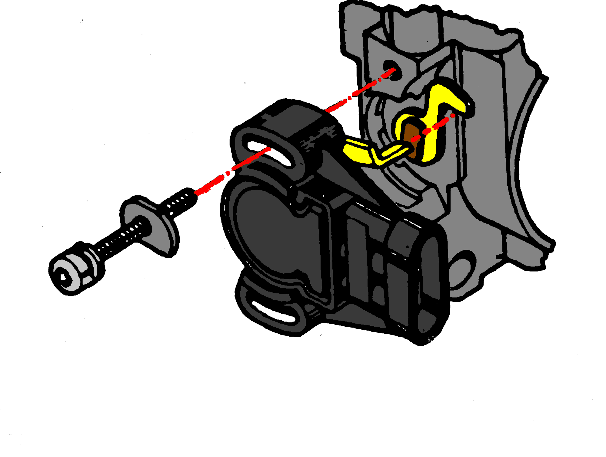

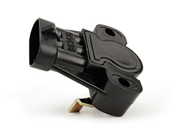

Where is that little metal deal on it suppose to touch? I took the old one off and not sure where it goes it is like spring loaded.

The metal arm on the TPS has to engage with the one on the throttle body, this is how it gets a reading..As you can see in the picture the one on the TPS hooks under the arm on the TB...WW
Thanks a lot I had a check engine code and the one that was on there popped off when I took it off. Wasn't sure where it was suppose to go. That helps a lot
