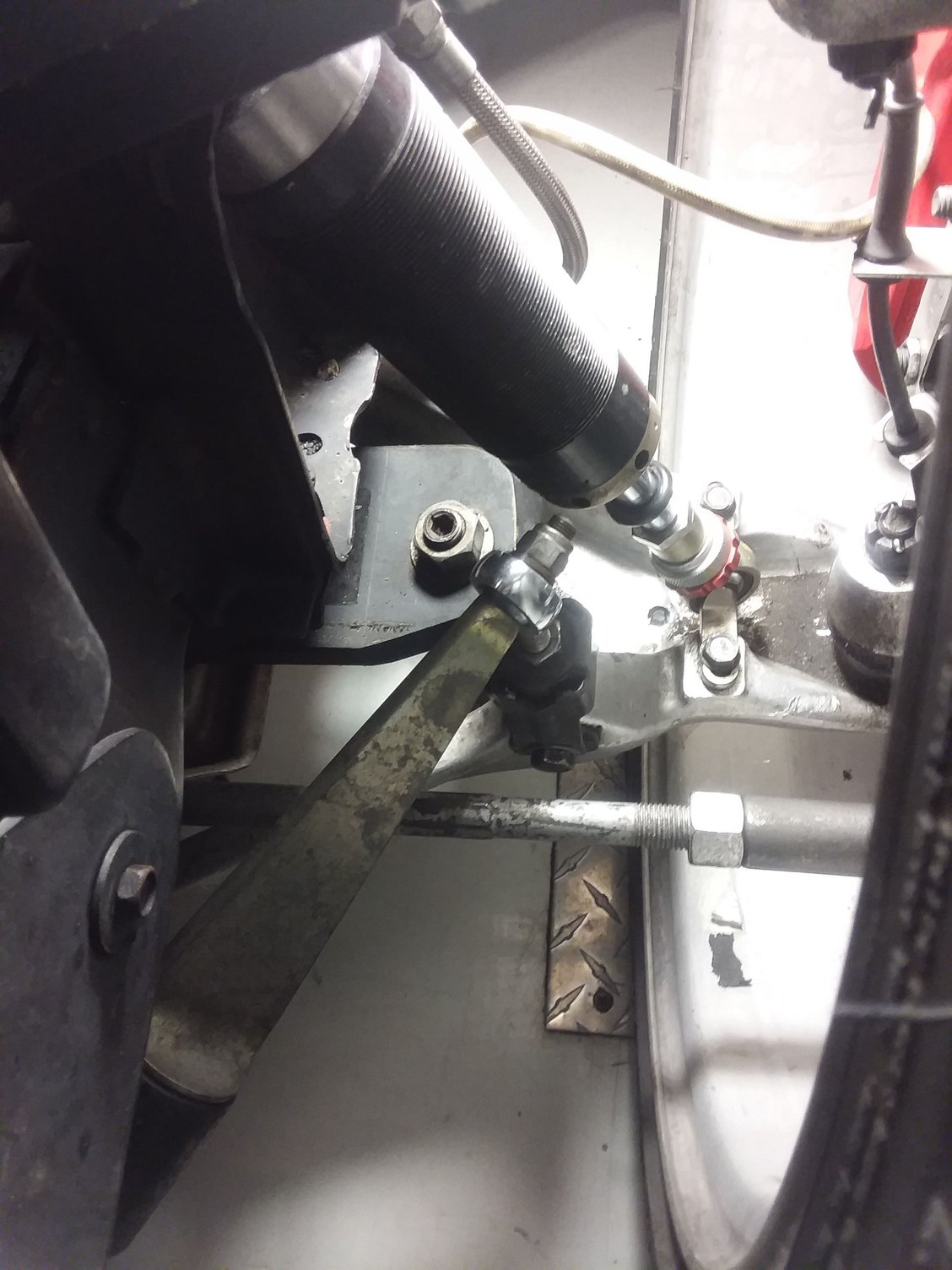

Any chance that you can talk Chris Ramey into posting a picture of his rear coil over shock mounts he fabricated to beef up the lower mounting point?
See below. He posted this on Facebook a while back, so it's in the public domain. He cut the stock shock mount portion of the aluminum upright/knuckle casting off. Then he used this fabbed steel bracket in place of it. As you can see, it bolts to the two trailing arm mount holes, as well as the camber rod hole. This is the only view I have, so I don't know what the other side looks like. But it appears to move the lower shock mount quite a bit inward, such that the coilover looks like it's vertical or nearly so. He said this was version 1, and they made some sort of improvements to it for a v2. I don't know what those improvements were.
