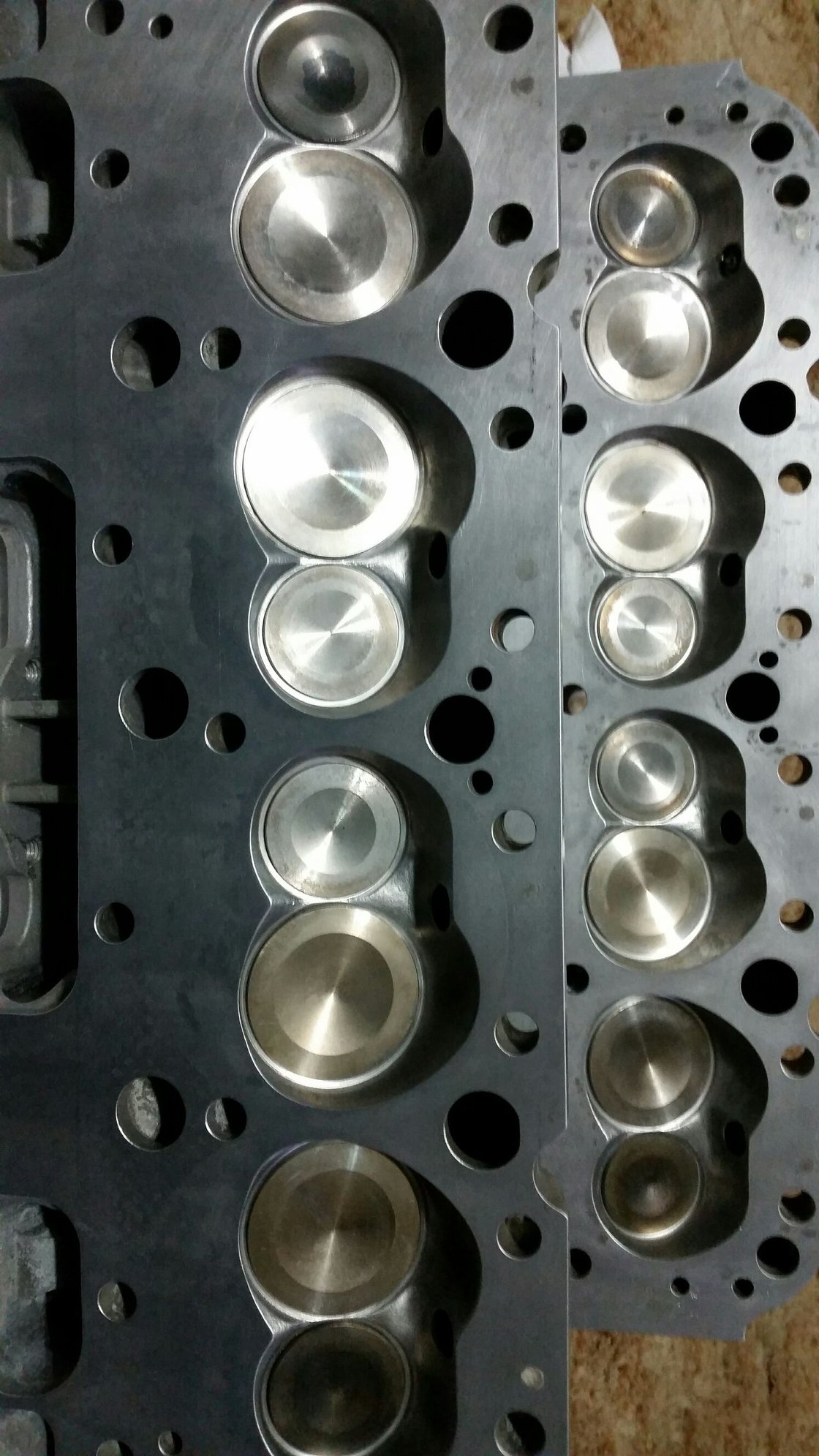

Hey all, I know it has been awhile sense I have posted on here but I have been making some headway and wanted to update you guys. Heads torn apart and cleaned. I also tried to polish the bowls a little and clean up some of the sharp casting lines around the valve seats. Got them back on the block and ran the rest of the engine harness. Still have some connectors that I need to shorten and clean up. I have also been playing with my EBL Flash / Tunerpro a little and getting it ready. A big thanks to RWDsmoke for sending me his tune. It looks a lot nicer than some of the other stock tunes that come with the EBL Flash. Not to say there is anything wrong with them. I will be taking a few days off soon so I should have more progress to report.

Nice job cleaning up the heads. I look forward to seeing how the EBL flash works.

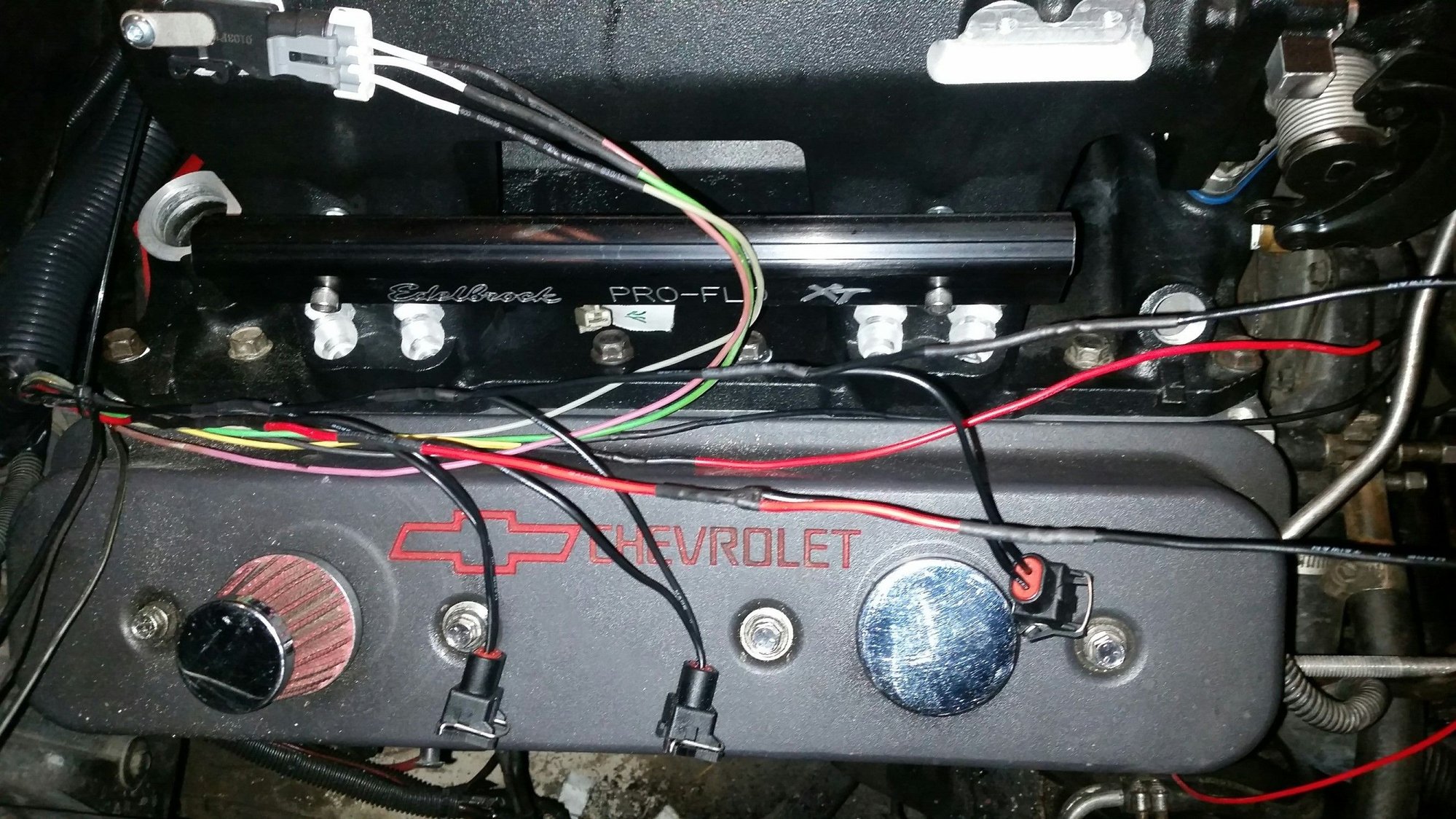

Hey guys little update, spent the good part of today wiring in the passenger injectors, ls1 map sensor, and fixing some cracked coolant temp sensor wires. Wired the injectors in backwards so I had to cut them out and rewire them also had to figure out which of the old map sensor wires connected to which of the new ls1 map sensor. An adaptor connector would have made it easy but more money. I wired my injectors a little bit different than stock to reduce the amount of wires. Let me know what you guys think of this. Here's a few pics. More progress tomorrow!

Nice looking intake and good job figuring out the wiring so far. I'm stoked to see how this turns out.

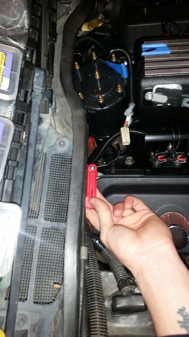

Got a little more work done. Reinstalled the oil pressure sensor and w.w. motor as well as the fuel pump relay and other relay that is right in front of it. Some how I ended up with about a foot of extra wire for the two relays and one of the connectors needed replacing so I spent a good bit of time will all of that. Nerve racking shortening wires in that back area as there isn't much room.
I was about an inch too long but better to have a little extra then not enough. I also finished up wiring the drivers side injectors as well as tucking wires and attaching ls1 style TPS/IAC. I have a little more wiring to do and then I will move onto fuel lines and finishing things up. Although I need ya'lls help! I still have to wire in the IAT sensor but I do not know which pin/wire needs to be power and ground. If any of you know please let me know!

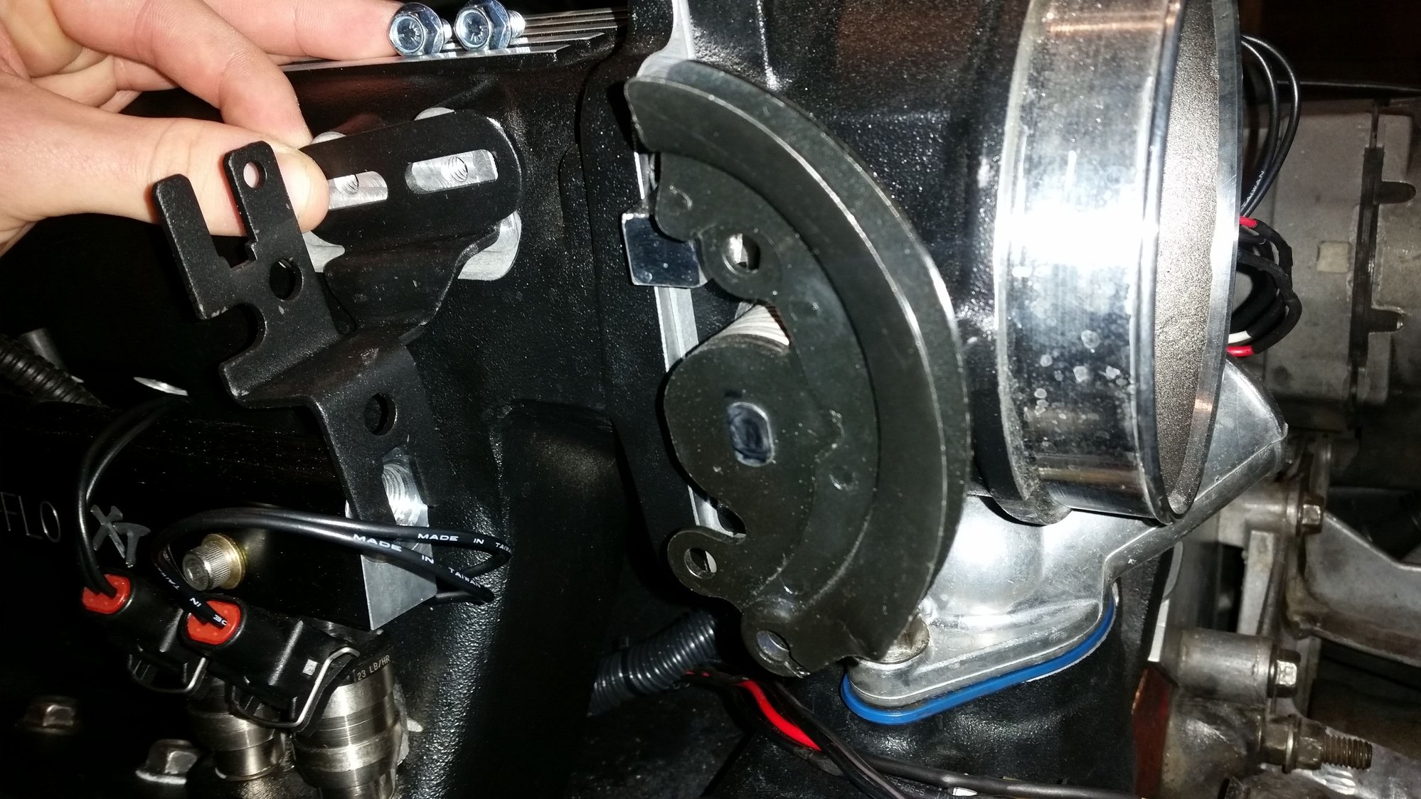

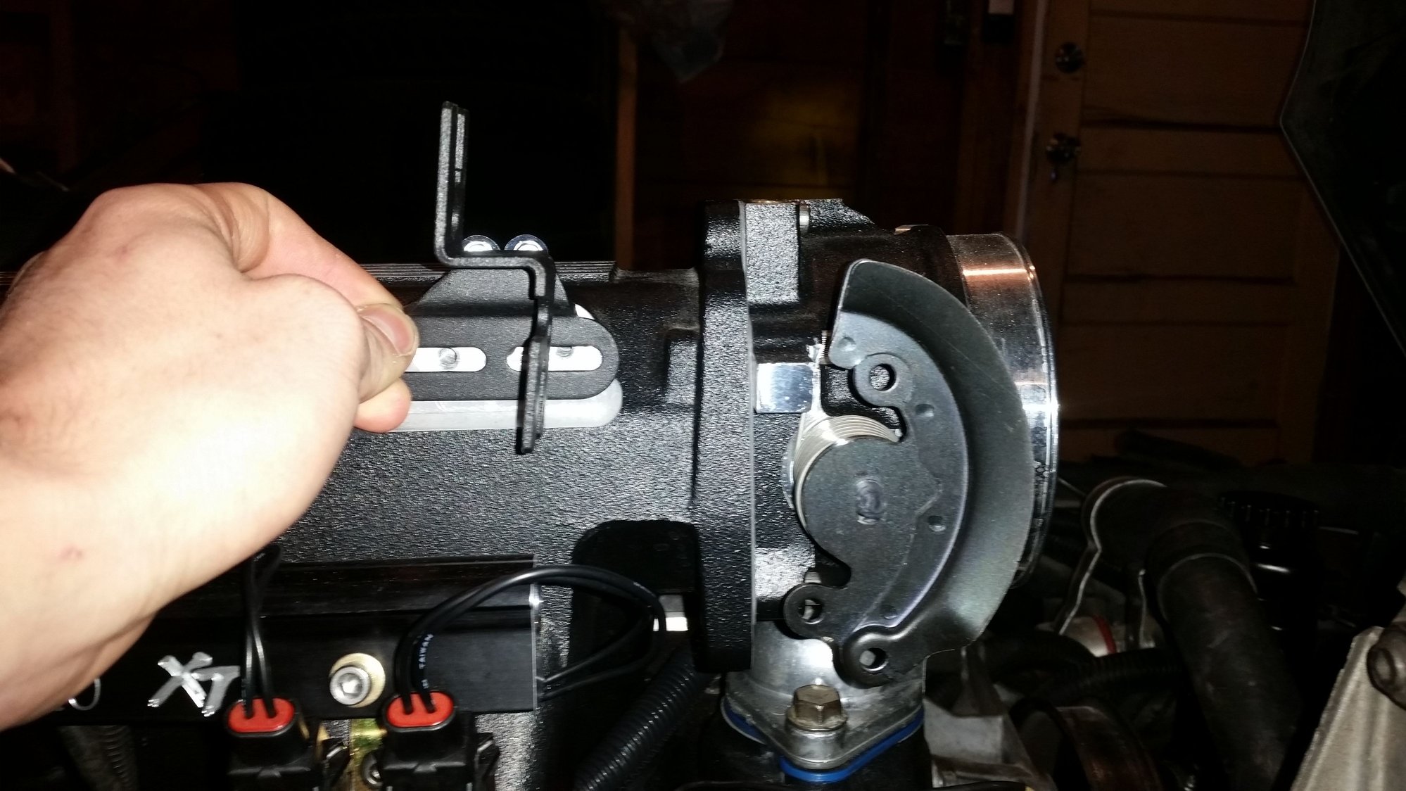

Small update. Throttle cable bracket does not want to work like it should. With it in place it interferes with fuel rails. Might just cut the kick down/cruse control tab off and keep it in case as I don't have cruse control hooked up. Replace a non waterproof connector with waterproof one. Shortened battery cable about a foot. Not sure how I ended up with so much extra. Unfortunately while shortening cable I broke off one of the resistor wire so I will have to replace them. I wanted to wait to replace them until the car was on a lift. Guess ill do it now! More updates to come.

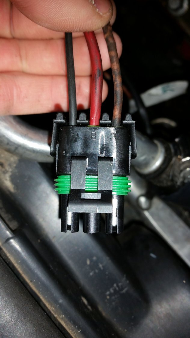

I have looked up different fusible links and it appears there are two types. Replaceable style that have a fuse and non replaceable that are wire. I would like to replace mine with the wire style as I don't suspect ill ever have to replace the fuses and I don't want to deal with the extra mass of having 3 fuses down by my headers.

So napa luckily had the style of fusible link that I wanted. I needed two 16gag and one 12gag but they only had two 16 and one 14. I will replace the 12 with the 14 and hope it holds. It should burn out faster than the 12. If it does burn out then I will replace it with a 12. I will get them all attached tomorrow!
