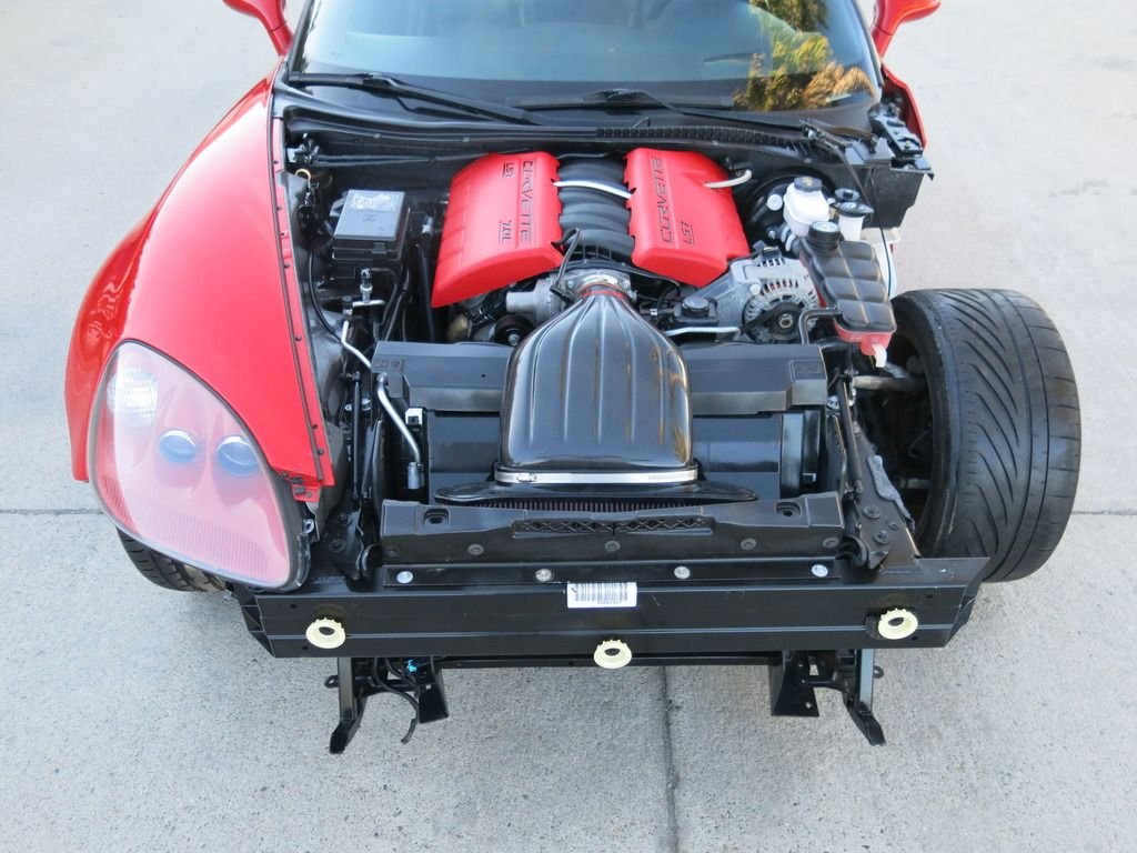

I've been thinking about getting this aftermarket Corsica air filter and housing kit for a 2009 Z06 and adapting it for my 85
Here is the photos I got off of ebay from a smashed up hole car fore sale. Its massive
Something like one of these would solve the problem and really help considerably overall

Look at the size of that filter and body attachments
They are Massive
Just in case you need your car to suck up a small child. Lol!
