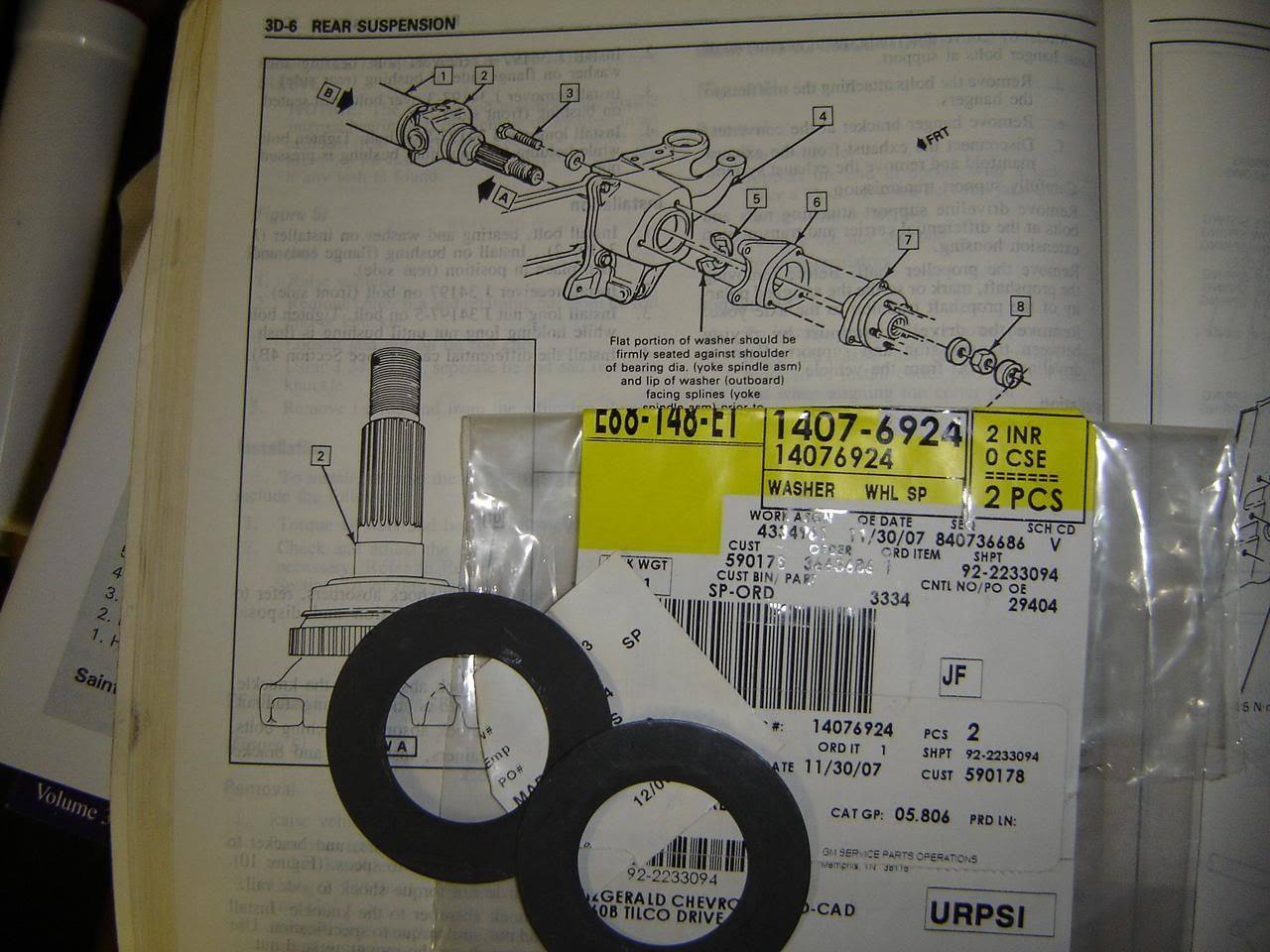

Old Sep 30, 2017 | 08:00 AM

I did talk to Rydell Chevy today and he stated he could not get the washers
GM# 14076924 but said these 3 dealers still had them and they are around $8.24
for 2 I think. Good Luck
Tennessee 865-970-9378
FL 305-556-2777
NY 585-591-2300

Old Sep 30, 2017 | 06:02 PM
Jagdpanzer's Avatar
Jagdpanzer
Joined: Apr 2007
Posts: 567
Likes: 36
From: Fairfax VA
Check Corvette Central and search 14076924
Old Sep 30, 2017 | 06:15 PM
xrav22's Avatar
xrav22
Joined: Mar 2013
Posts: 1,952
Likes: 239
From: Venice Cali.
Yep that is a win.
For the record
FALSE ALARM
