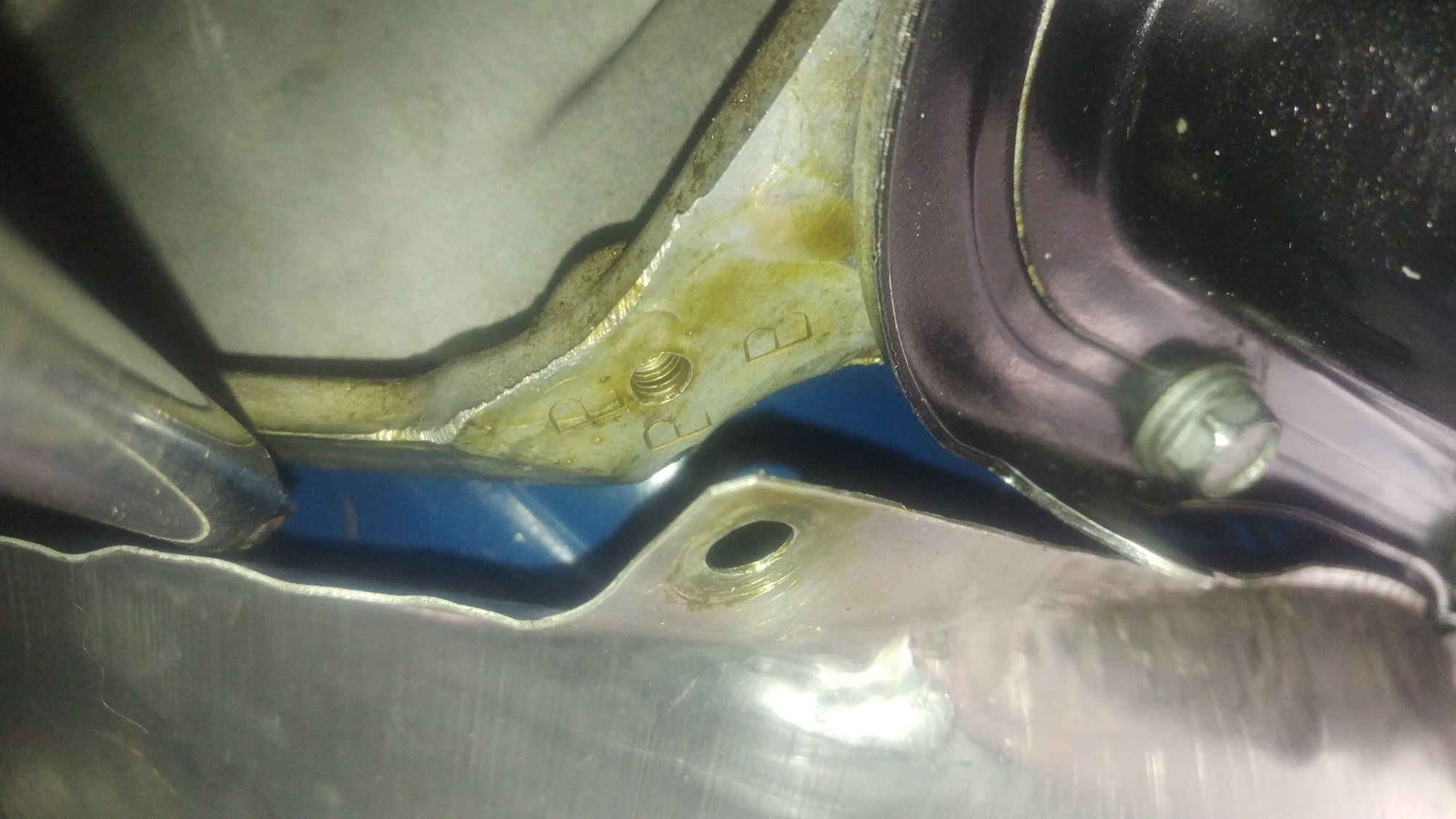

Got under the car to remove the torque converter dust cover. To see if it was blue, since you told me it would blue if the TC was burnt. Weird thing is, the whole TC is blue. Supposedly the stock TC was rebuilt.
I couldn't remove the whole thing because one bolt was blocked by the exhaust. I didn't feel like dropping the cat on the passenger side.
Well painted blue is not what I meant in my post earlier, but you knew that already. I cant speak for the other guy making similar comments but I'm confident he wont disagree.
I mean blue as in it got scorching hot at some point.
If you don't see that, then consider the converter as having passed visual inspection.

You have to take the dust cover right off. You would have to take a picture looking at the engine and converter. With your converter being blue, it would have to have some heat staining, burnt bluish to pale light blue.
Just looking at that picture would make me think that converter is still working. Usually when they are smoked there is more heat discolouration. Just my opinion.
Could still be a TCC solenoid issues. Drop the pan and find out for sure.
