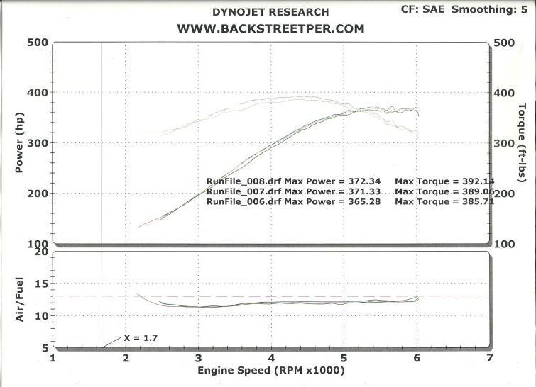

Examples to cover 113 head "limitations":
Stock results:
https://www.corvetteforum.com/forums...s-cam-l98.html
TPI Stroker with ported 113s and cam:
https://www.corvetteforum.com/forums...o-results.html
HSR Stroker with ported 113s and cam:
BTW...I captured the dyno that's missing from the HSR build (above).....

First, the Firehawk was w/in ~20 hp of the LT5, passed emissions, had a warranty etc. It was over 100 more hp than it's TPI based foundation. That was pretty phenomenal in '92
Second; where do those changes come from? YOU DON'T KNOW...that's for sure. But the intake was a large part of the improvement.
Third, the Ramjet most certainly does NOT make more power than the Firehawk engine. The RamJet is rated in GROSS HP and...given the same ~350 rating! Yet the Firehawk was rated NET. Know the difference? I'm guessing that you don't so HERE IS SOME READING FOR YOU.
