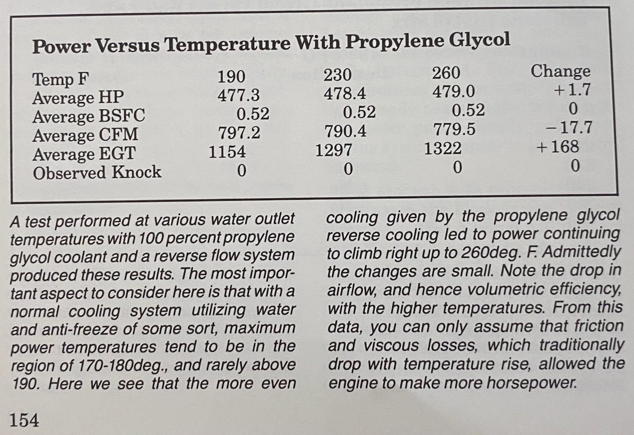

Originally Posted by Tom400CFI
What are the factors that were not considered in all of these tests?
I was referring to the factors I mentioned in my post, which tests are you meaning? Some of which are inter-related… intake charge temp variations, knock sensitivity and tuning, different type coolant. Here’s some reference on the subject:
Read the exact data you just attached with a std cooling system and a mix of water and antifreeze max power is usually between 170 and 180. This most likely assumes you can also keep the intake charge cool. As noted in previous tests the tested engines actually made more power at cooler temps.

AZSP33D, If you read all of the test that I posted, you'd see that in one of the Engine Masters' tests, they did measure everything: fuel temp, plenum temp, runner temp, air charge temp. Post #59....
...more.
Engine Masters just did another test, exploring the engine temp vs power more carefully. They positioned a air flow meter on the mouth of the carb, temp sensors in the room, the plenum, one in a runner, and EGT, and obviously the coolant temp sensor. Engine was a 598 CID, Brodix 365 oval port heads, Brodix single plane, solid roller...
WRT Knock sensitivity, as it relates to all of these test, two things;
1. Engine Masters didn't change the timing for the various tests. IOW, they likely weren't near knock on any test but their highest temp test. Because....
2. None of the engines were likely in any danger of knock at the colder temps tested, regardless of timing...but especially with timing set that was acceptable at the higher temps.
Fair enough, now if you actually read all I have posted here (much less than all you have of course) perhaps you would get my point. Changing the coolant demonstrates the ideal temps and limitations. Even at a loss of CFM due to higher intake temps, it gained a little power. It may seem like I’m contradicting your assertion that more power is usually made with engine running at a cooler temp, or saying the tests you’ve posted are not valid, but I’m actually not.
