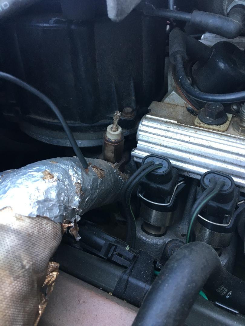

hello a friend of mine bought a 89 coupe last week ,and when he is driving around 40mph his temp is around 220 to 230 degrees is it supose to running that high,I have a 84 and the temp at that speed will be around 190 ,and here is a pick that i took it is on the passenger side of the motor a black wire came loose from some type of a gadget
,what is this for thanks guys Bill

The wire is for the EGR sensor to determine if the EGR is working. Reconnent the wire otherwise he may get a check engine light.
