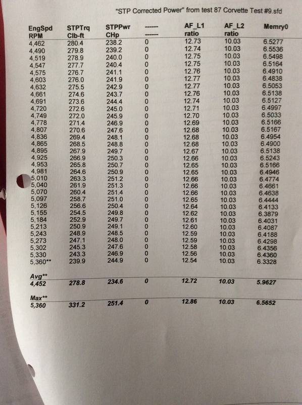

I recently had the car tuned on a dyno prior to a blower but the dyno results were seriously disappointing. I can feel an improvement over stock but not ads much as I thought.
It only made 250 rear wheel hp!!!
The car starts hard (I expected this since we removed the 9th injector) and surges on cold start up but the surge goes away as it warms up.

Compression? I want to say stock. As for peak hp and torque:
Originally Posted by bjankuski
Attach a dyno sheet.
Old Jul 2, 2018 | 05:52 PM

It’s easy....you are running a choking intake system....that base and runner do nothing over the stock long runner set up...makes torque, not horsepower....mini ram will provide about 40 rwhp over that....with the same time tune....after a tune ....even better....ask me how I know!!
surprised it’s not making more rwtrq though.

..... 250 rear wheel hp is actually a nice improvement over stock rated 240 flywheel hp … small-ish heads , small cam , TPI and Long tubes got you 50-60hp over stock ! … nothing wrong with that ! …..

if a cam, heads and longtubes gives me 50 hp, I can’t see an intake giving me 40.
