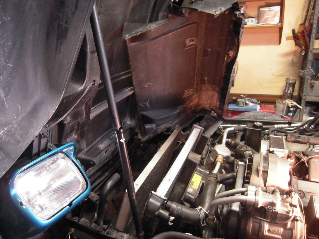

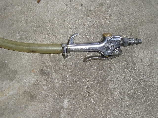

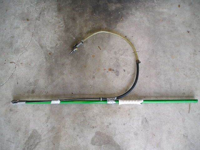

I know most of us check the debris between the radiator and the condenser but that is not good enough. You really need to go the distance and clean it better so I have been doing this for several years now. I built a thin right angle air gun so I can reach the bottom of the radiator and condenser and all 4 surfaces. I first blow out toward the front of the car (and then rear) and then go back and forth till I can't see anything else coming out. This can take a good while. You can't believe the crap that comes out the first time.
You have to raise the shroud and remove several hoses and the top A/T line has to be disconnected. I just have a bungee cord to hold one end up as you don’t need to completely remove it. I also replace the coolant, flush the radiator and clean out the heater core with a hose (gently). I do the heater last so I can re-connect the A/T line and drive it out of the garage (where I do the blowing out first) and where I can use the garden hose and make a mess.
I threw this together quickly one day as I thought I'd never use it again but now part of my special tools. Just made it of a mop stick, duck tape, rubber and plastic hoses. It works real well.
This process will give you an additional edge on better cooling but only closer to factory specs. I know a bigger radiator is really required for us guys who live in 90-100 heat most of the year. I think the corvette engineers and designers all lived up north.

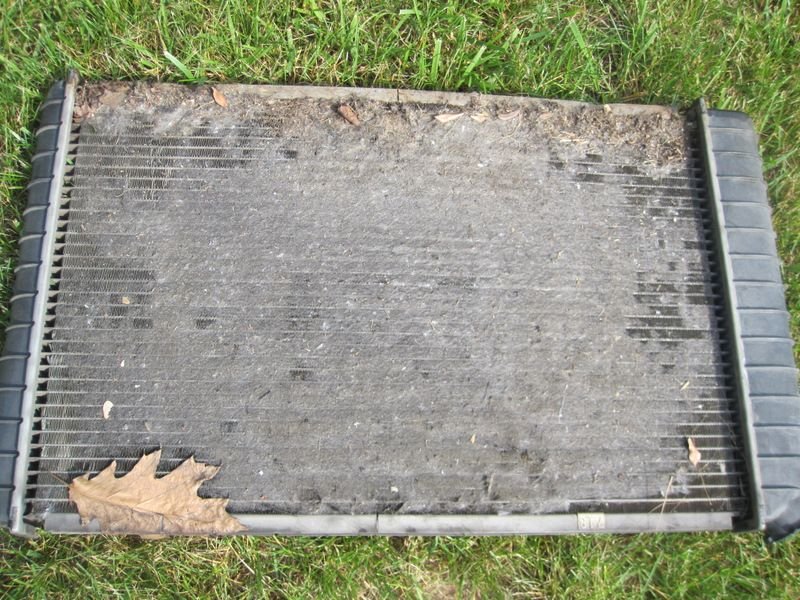

Here is what I found after my (since sold) 89 pegged 240 in bumper to bumper traffic. In fact the AC blow off valve engage. WTF?
Once I cleaned it out I would never go over 215 with the AC on in 105 Texas heat. Air flow is everything.

That's an awesome tool! I don't have an air compressor, so I will at least pull the shroud and do what I can to clean her out!

That pic sure gives a good example, huh? Definetly gonna look into this and a flush!
