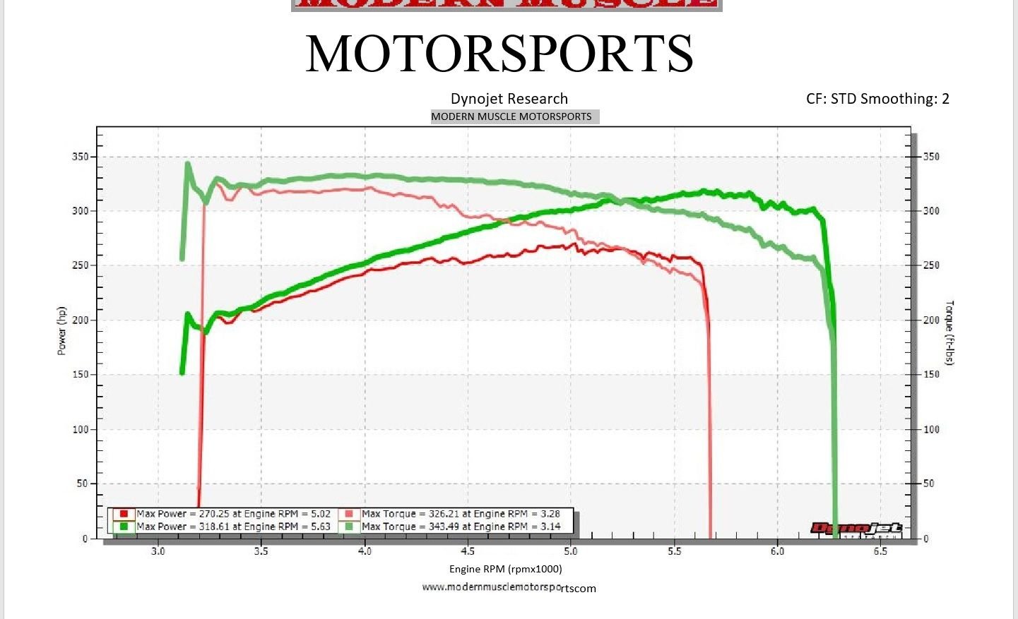

I received the dyno sheets from dyno tune after my cam install. car is a 93 LT1 with these mods:
3.54 gears
2800 stall converter
shorty headers
modified stock air box
Resonator delete with X-Pipe
Muffler delete's
first dyno run was done in this trim^^^^^
added:
Custom grind Lunati cam
Lunati Voodoo 1.6 roller rockers
Comp Cams Hi Tech pushrods
second dyno results were with these upgrades^^^
video before cam
Video after cam install:
Obviously Green is with cam/ Red before cam

Nice ! More power and torque across the curve! 48 ....call it 50 more rwhp!

So you lost basically nothing on the bottom and picked up on top? That's damn good. What were your cam specs again? I wanna say mid 220s @.05? If I had to guess that is around 400 chp?

We can't see the "low end" since he started the pull at around 3k. Looks like ~340chp to me, if he's running a stick shift.
I want to know what custom grind cam it was.

223/231 .557/.571 110 lsa

Automatic. with 2800 stall
cam grind 223/231 .557/.571 110 LSA
being conservative figuring 10% hp loss through drivetrain, should put it at 350BHP +/-

It is in auto as he gave stall speed. Very nice results!

I spend my life above 3k. My bad actually, thought it started at 2k. There is a big crack in my phone screen though so that's my excuse!

Curious if you had a tune of some kind? I'm impressed if you can run that much cam + other goodies w/o a new tune.
Thx for sharing.
Oops, I see now in the first sentence it was a Dyno tune also. Congratulations!

I actually ran pretty good with cam prior to tune. behaved okay. little groggy at lights but not bad

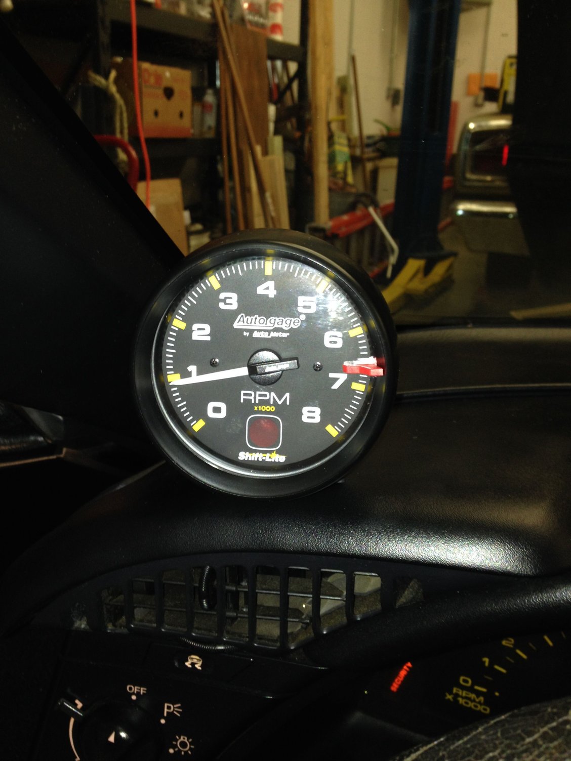

I'm really impressed you found somebody that will dyno tune these OBD1 dinosaurs. You have the same tach problem I had a while ago. It was running into no man's land after 6k. I had to install an aftermarket tach.

Yea I have plans for one eventually. or maybe a shift light

Those shorty's are really holding back some power gains. I say go longtubes. Nice numbers and I bet the car is fun.
