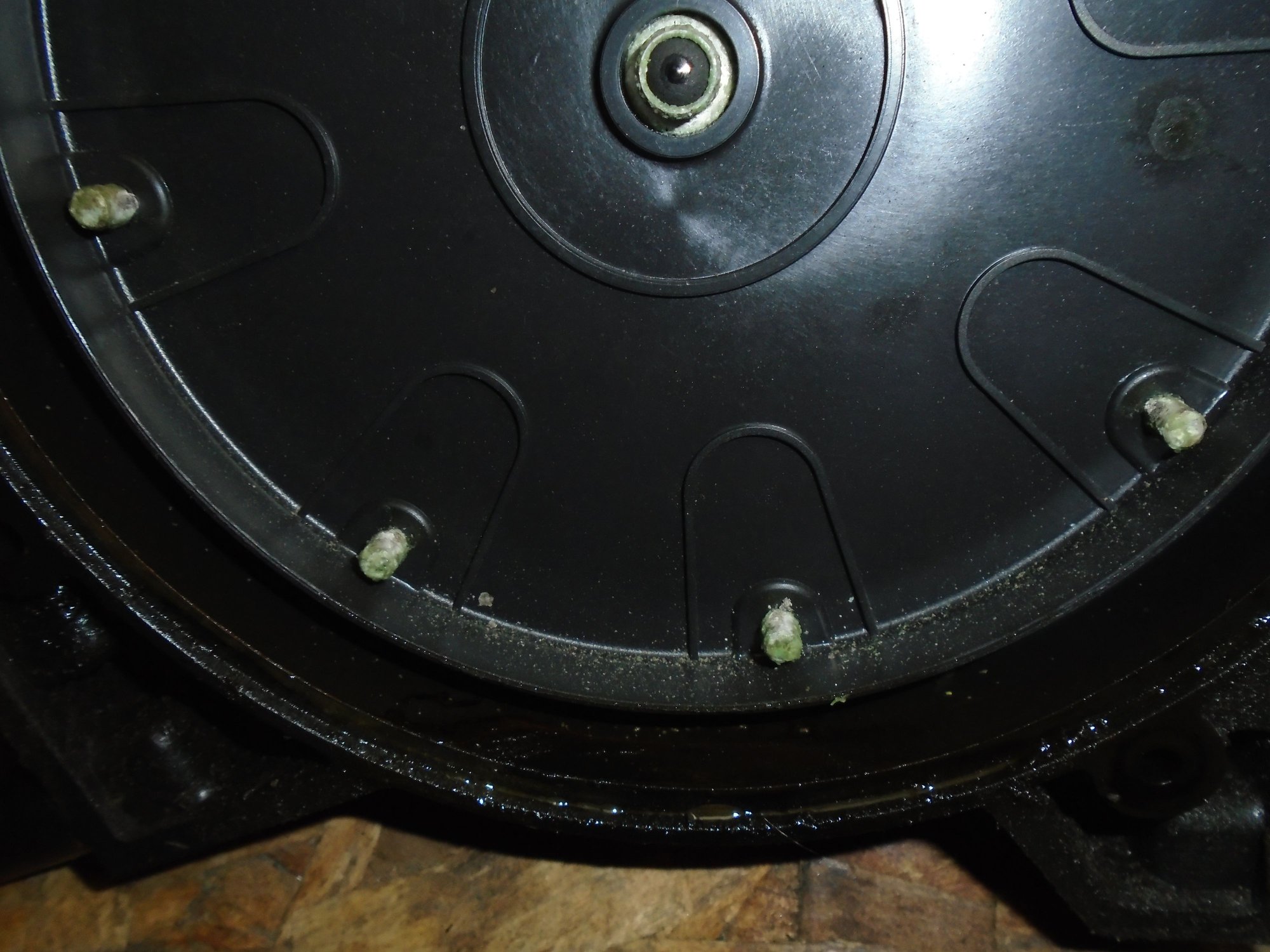

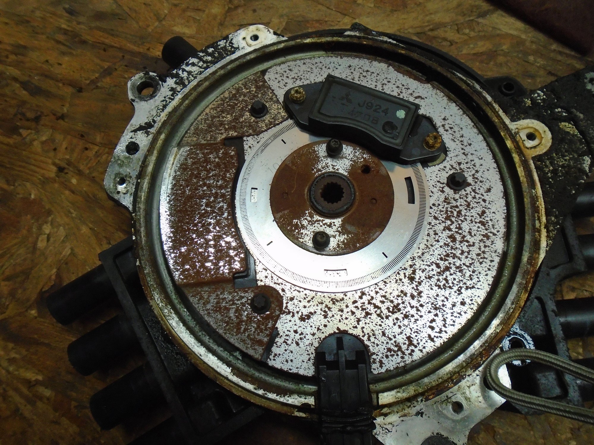

I pulled the opti out today,cap was all corroded at the bottom and the opti was all rusted!

Rusty opti should account for the miss.......what is causing the white smoke if the head gasket is not ruptured?

The rust in the opti doesn't mean much as the active parts look OK. They all get to look like that. Clean up the cap and rotor or just change the cap and rotor. Look for any carbon tracks.
Get a test kit for the coolant from a parts store and check for gasses to see if you have a bad head gasket. White smoke is usually water or steam.
